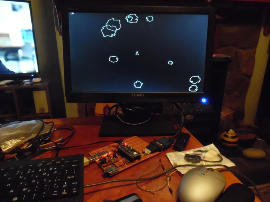

Stan,
No idea yet, have to study the game first. I have the asteroids flying, the ship also, I can fire, shoot asteroids, they split in smaller pieces perpendicular to the bullet angle, and finally get destroyed. Bullets vanish at the borders, but asteroids and ship mirror at the borders. What I read on wiki is that that is the original gameplay. I have max 6 bullets on screen now.
Next is the vector font for the score, and the flying saucer ( there are 2 apparently).
Since everything in mmbasic is vector drawn, no sprites, I want the font also vector drawn. That would be cool. The YouTube video shows a very primitive font. Should be simple.
Have to study a lot….
Edited 2024-07-24 06:22 by Volhout
Posted: 08:29pm 23 Jul 2024
@ Volhout... I got time.. if no one else done asteroids.
working on missile from x1,y1 to x2,y2.. 4 quadrants but using floating point easy :)
it's needed in many games .. missile command, 2d tanks
Posts: 6195
Posted: 08:51pm 23 Jul 2024
Based on Vegipete's teaser.
Do not comment on coding, this is experimental stage. Cleanup of code will be when I know how I am going to implement things.
Fly with cursor keys (UP, LEFT, RIGHT)
Fire with <SPACE>
