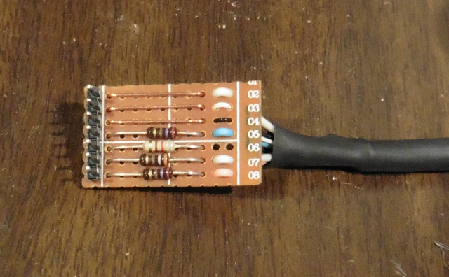

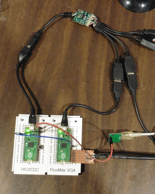

Posted: 10:36am 09 Jan 2024
have just got a "PicoMite VGA Duo" set up and running (yes - i have officially named it) using an Fe1.1s USB 2.0 hub chip and a compact layout USB keyboard.
it works superbly!
however, the default font that the picomite uses for VGA output (including when editing) is absolutely horrendous! this is the 8x12 font that gives an 80 column by 40 line text screen. apart from the hideously mangled lower-case "m", the lack of descenders makes reading text entirely unpleasant. it looks like it has been designed for maximum characters on screen with zero regard for readability.
one alternative option:
https://int10h.org/oldschool-pc-fonts/fontlist/font?ibm_vga_8x16
this is an 8x16 font that would yield 80 columns by 30 lines. it was used in umpteen thousand cloned VGA graphics cards and is most certainly well and truly out of any copyright.
would anyone care to roll a picomite VGA .uf2 file with a different editor font?
rob   :-)
Footnote added 2024-01-09 21:40 by robert.rozee
my setup:
Footnote added 2024-01-09 21:48 by robert.rozee
VGA components on daughterboard:
Posts: 9246
