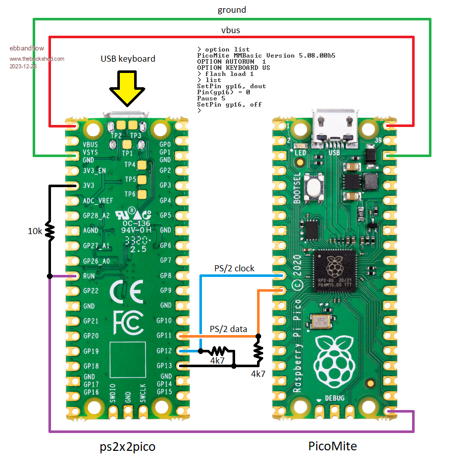

To prevent back-powering the picomite, I think I've decided against desoldering/reversing the built-in schottky and instead just linking vbus (per the last schematic I posted) & adding an external diode inline between the ps2x2pico's micro-usb and the USB type A socket for the keyboard.
Currently looking into power on reset circuits for the psx2pico and thinking about starting simple with a 10uf cap from gnd > run & 10k resistor from run > 3.3v but does anyone have recommendations?

I've implemented a similar solution using the run pin, but am searching for a hardware power on reset for the ps2x2pico to avoid tying up a pin on the picomite to do the reset. So far, my tinkering around with adding a cap and pullup to run have not worked :/
This solution is fully working for me:

what's gp16 connected to please?
Posts: 9246
Posted: 06:35pm 25 Dec 2023
if the Pico on the right pulses GP16 low if forces the Pico on the left to reset. The 10K pullup is a "boots & braces" resistor as RUN already has an onboard pullup, although it's a bit high.

Sorry to be confusing, I'm just tinkering around to see if I can make this work because I want the same end result as you. The first schematic I posted was an idea that did not work until I added the 4k7 resistors to gp13 of the ps2x2pico as shown in the second schematic. This works, but the keyboard does not reconnect to the picomite after a power cycle until resetting the ps2x2pico by the grounding the run pin. This is shown in the third schematic where I connected gp16 of the picomite to the run pin of the ps2x2pico with a 10k pullup to 3v3 as shown. In the third schematic you'll see the code that autoruns from flash slot 1 in order to toggle gp16 on boot.
Need to think about Mick's 3v3_en suggestion. Ideally I'd like to get away from using the picomite to toggle the reset and have it happen automatically through a circuit but not quite there yet... more tinkering to do.
