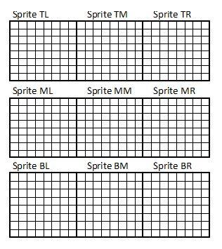

even with Peters Routine, if I move all Tiles to CSUB, there is not enough memory to keep all 256 24x24 Tiles at the same Time.
So I think I have to tokenise each Tile to 3x3 Bytes, were each adresses a 8x8 Pixel Picture-Element. Like in the original PET Version, but with 8x8 Picture-Element instead of PETSCII characters. This has to fit in 256 8x8 Tiles, which costs, in comparison,just a fragment of the memory. If it is hidden under the Border it would need no additional Memory at all.
But, I have no idea how long it will take me to do the conversion.
Martin

I now managed to decode the structur of the original Tileset Files,
Every Tile is 3 by 3 Chars, as they where original PETSCII encoded.
they are serially encoded
256 Bytes TL starts at Byte 514 of the Tileset File
After this next 256 Bytes belongs to TM ....and so on
so you end with an Array of 9x256 Bytes
I am still working on creating 8x8 Pixel Tiles that match to the Tileset.
All in all this will use much less memory than 256 24x24 Tiles
Edited 2023-09-21 17:51 by Martin H.

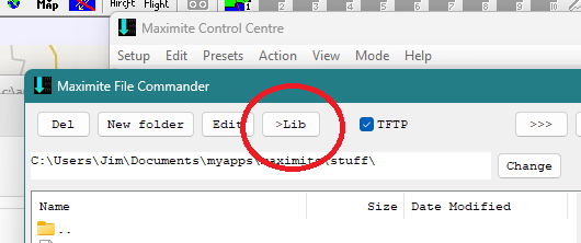

Posts: 6631
Posted: 09:45am 21 Sep 2023
Loading up the library is not difficult

  TassyJim said  Loading up the library is not difficult...
Yes Jim, but you've got a PC in the driving seat and are sending a command to the serial console / prompt.
The use-case that I believe @Volhout wishes to address is:
- Start standalone PicoMiteVGA
- Type one command on the PS2 keyboard that will run "PETSCII Robots" including replacing the current contents of the LIBRARY with contents read from one or more files.
Now other than potentially setting up a macro on one of the Fn keys (and that won't help you if you wanted to start PETSCII Robots from a separate menu program) there is as far as I can see currently no way to achieve this.
Edited 2023-09-21 19:54 by thwill
Amnesie
Joined: 30/06/2020
Posts: 763
Posted: 10:05am 21 Sep 2023
Same here. The goal is to have a standalone device.
Greetings
Daniel
Posted: 10:11am 21 Sep 2023
What does "standalone device" mean ?
Does it mean:
1. A device dedicated to playing PETSCII Robots? That shouldn't require any changes to the firmware, having got one Pico installed correctly and setup to AUTORUN you just clone its flash and provide it for others to download as a .uf2.
2. A (possibly multi-file) program that can be started with a RUN command on a standard PicoMiteVGA, either at the prompt of from within another "menu" program.
Edited 2023-09-21 20:12 by thwill
