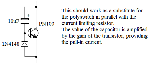

I have ordered a couple of parts to do sum testing of a 24vDC powered unit driving 24vAC solenoid.
i am going to use a AQZ102 SSR
and a 0603L001/60YR  Poly-Fuse  on paper it should work.
Information is a bit sparse on how long the  poleyfuse will last for in a cyclic application so i think i will mount them on a daughter card as a consumable component.
and do the design so i can revert to a fet and 555 if the polyfuse prove to be troublesome.
Posts: 3417
Posted: 11:22pm 08 Sep 2023
Posts: 3369
Posted: 02:46am 09 Sep 2023
The poleyfuse will only activate in case of a short circuit in the valve or its wiring and that should be a very rare event - and it will reset when the short is removed.  The rest of the time it does nothing so I don't see how it could be regarded as a consumable.  Also, they are readily available and cheap - a great solution.
Edited 2023-09-09 12:47 by Geoffg

It was to use it as a switch to provide a 24vDC pulse to the 24VAC solenoid and then trip and supply a low holding current to the solenoid.
The parameters of the polyfuse
Voltage - Max 60V
Current - Hold 10 mA
Current - Trip 50 mA
Current - Max 40 A
Time to Trip 1 s
Resistance - Initial (Min) 15 Ohms
Resistance - Post Trip (Max) 100 Ohms
Posts: 9246
Posted: 06:51am 09 Sep 2023
Remember to keep polyfuses clear of other components. Some can run a bit warm. This looks like an interesting use for them. :)
Posts: 3369
Posted: 09:58am 09 Sep 2023
  pd-- said  It was to use it as a switch to provide a 24vDC pulse to the 24VAC solenoid and then trip and supply a low holding current to the solenoid.
That is unusual and I could see that the device might wear out.  I would use a spare output from the WebMite driving a FET which would switch in a current limiting resistor in the common line.  It would take a small change to the BASIC program but nothing serious.

Polyfuses have a wearout
Polyfuse Lifetime
This may be better
Switching PTC
Edited 2023-09-09 20:13 by bigfix
