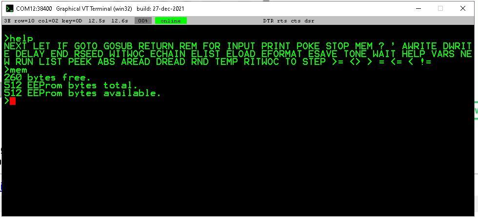

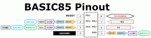

  Quote  Is this right?
Missing aread on pin 2
  Quote  LET and REM
They cost 5 bytes of flash each - nothing else if you don't use them

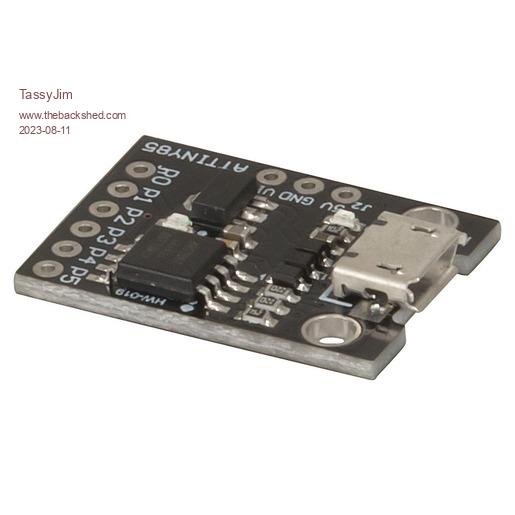

As well as some loose chips, I purchased these boards
I didn't notice that there were only the 6 IO pins on the header. The 5V and GND are on the side making strip-board use not as friendly as I had hoped.
The pins on the header are in PB order, not physical pin number which is not a problem, just untidy.
The good news is, it has 78M05 regulator on board so powering from 12V is easy. The USB is not usable as data but handy for powering from a 5V plugpack.

Posted: 09:52am 11 Aug 2023
While not stripboard friendly, that looks like it's just the DIGISPARK layout so there are a lot of available daughterboards you can attach.

Posted: 12:53pm 11 Aug 2023
  Quote  The 5V and GND are on the side making strip-board use not as friendly as I had hoped.
However it might be ok on a breadboard, if the power pads line up with the power rails on the edge of the breadboard.

  Quote  The good news is, it has 78M05 regulator on board so powering from 12V is easy
Jim, I would like an idle current measurement at 12V when you get a chance.
OA47
Posts: 6631
Posted: 06:48am 12 Aug 2023
  OA47 said  Jim, I would like an idle current measurement at 12V when you get a chance.
OA47
25mA
A lot of that is the linear regulator and there are two LEDs.
One is connected to pin 6 which is the serial Tx so not any use.
The other is power.
If you are using them of restricted power, starting with the bare chip would be easiest.
