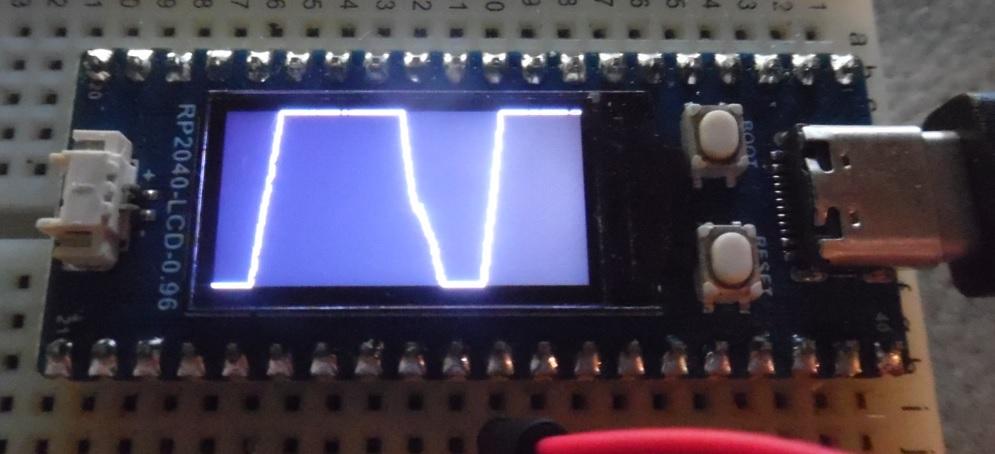

Here's a version of my version above, parameterized so it will work on the WaveShare RP2040-LCD-0.96 board, and not clip :-)
'PicoMite "scope test.bas" for WaveShare RP2040-LCD-0.96
'Adapted by NPHighview from Phil99 on the Backshed Forum July 2023
'Adds double-buffering and array graphics (FAST!)
'ADC values range from 0.0 to 3.3. See scaling calculations below.
'Next on the to-do list: add interrupts.
Const Hres   = 160               ' Horizontal resolution of display
Const Vres   =  80               ' Vertical   resolution of display
Const Grat   =  10               ' Graticule size in pixels
Const HGrat  = Hres/Grat
Const VGrat  = Vres/Grat
' To scale 0-3.3v input to full height, but no clipping
Const VScale = Vres/(-3.3)       ' 3.3 volts reference voltage
Dim Buffer1!(Hres),   Buffer2!(Hres),   Horizontal!(Hres)
Dim HGratx1(HGrat+1), HGraty1(HGrat+1), HGraty2(HGrat+1)
Dim VGratx1(VGrat+1), VGratx2(VGrat+1), VGraty1(VGrat+1)
Dim integer x, y
Const Background = RGB(48,64,48) ' medium dark grey/green a la Tektronix
Const Graticule  = RGB(black)
Const Signal1    = RGB(yellow)   ' dual colors used for debugging double-buffering
Const Signal2    = RGB(yellow)
' Pre-set array values for use in buffers and fast array graphics
Math Set 0, Buffer1!() : Math Set    0, Buffer2!() ' Pre-set Buffers to draw lines at the bottom
Math Set 0, HGraty1()  : Math Set Vres, HGraty2()  ' Pre-set Arrays for Horizontal Graticules
Math Set 0, VGratx1()  : Math Set Hres, VGratx2()  ' Pre-set Arrays for Vertical   Graticules
For x = 0 To Hres-1 : horizontal!(x) = x       : Next x ' used in array graphics
For x = 0 To HGrat  : HGratx1(x)     = x*Grat  : Next x ' for time graticule
For y = 0 To VGrat  : VGraty1(y)     = y*Grat  : Next y ' for volts graticule
' Set up the screen and ADC hardware
CLS Background
ADC open 500000,1 'samples per second
' Begin signal acquisition and display
 ' While acquiring Buffer 1, display Buffer 2
 Pixel Horizontal!(), Buffer1!(), Background     'Clear previous display of Buffer 1
 Buffer1!(Hres-1) = -1 : ADC start Buffer1!()    'Start Acquisition into    Buffer 1
 Line HGratx1(), HGraty1(), HGratx1(), HGraty2(), 1, Graticule ' Redraw overwritten
 Line VGratx1(), VGraty1(), VGratx2(), VGraty1(), 1, Graticule ' Graticules
 Math scale Buffer2!(), VScale, Buffer2!()       'Scale   Buffer 2 to fit screen
 Math add   Buffer2!(), Vres,   Buffer2!()       'Offset  Buffer 2 to bottom of screen
 Pixel Horizontal!(), Buffer2!(), Signal2        'Display Buffer 2 scaled/offset
 Do While Buffer1!(Hres-1) < 0 : Loop            'Wait until Buffer 1 is full
 ' While acquiring Buffer 2, display Buffer 1
 Pixel Horizontal(), Buffer2!(), Background      'Clear previous display of Buffer 2
 Buffer2!(Hres-1) = -1 : ADC start Buffer2!()    'Start acqusition into     Buffer 2
 Math scale Buffer1!(), VScale, Buffer1!()       'Scale   Buffer 1 to fit screen
 Math add   Buffer1!(),  Vres, Buffer1!()        'Offset  Buffer 1 to bottom of screen
 Pixel Horizontal(), Buffer1!(), Signal1         'Display Buffer 1 scaled/offset
 Do While Buffer2!(Hres-1) < 0 : Loop            'Wait until buffer 2 is full
End

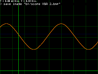

Hi Stan,
It seems I am going senile, at last realizing your issue isn't in generating a stable display but in not getting reliable triggering.
Here is one way to do that.
MODE 2  'PicoMiteVGA "scope test.bas"
Dim samples!(640)
Dim Float V, Trig = 1.5 'Set trigger voltage
Dim integer x, y, TC, speed = 500000
ADC open speed, 1 'samples per second
 samples!(639) = -1   'set last element to -1
 ADC start samples!() 'get new samples + extra for trig. search
 Do While samples!(639) < 0 : Loop 'wait till array is full
 'search for Trigger Condition
 TC = 0
 Do : Inc TC : Loop Until samples!(TC) < Trig Or TC > 320
 Do : Inc TC : Loop Until samples!(TC) > Trig Or TC > 321
 If TC > 320 Then TC = 0
 Math scale samples!(), -72 , samples!() 'scale 3.3V to screen heihgt
 Math add samples!(), 240, samples!() 'set 0V to bottom of screen
 'plot graticule
 For x = 1 To 320
  If x Mod 40 Then
    Line x, 0, x, 240, 1, 0 'delete old trace
   Else
    Line x, 0, x, 240, 1, RGB(0,64,0) 'Time grat.
  For y = 0 To 240 Step 30
   Pixel x, y, RGB(0,64,0) 'Voltage grat.
  Next
  'plot trace
  Line x-1, samples!(x-1 + TC), x, samples!(x + TC), 1, RGB(255,128,0)
 Next
End
Change values to suit your display, or better yet add the trigger search to @NPHighview's superior version.

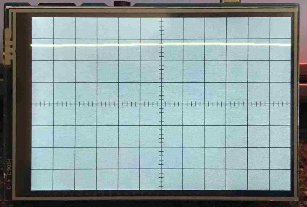

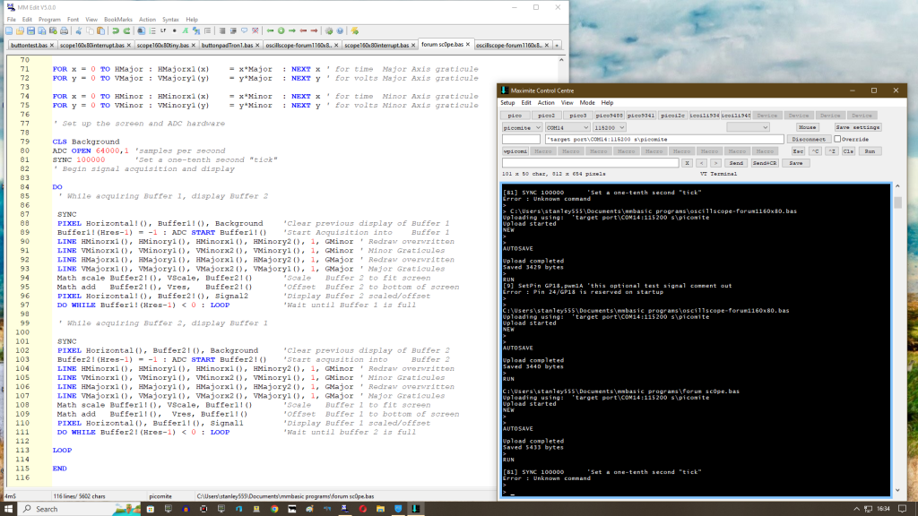

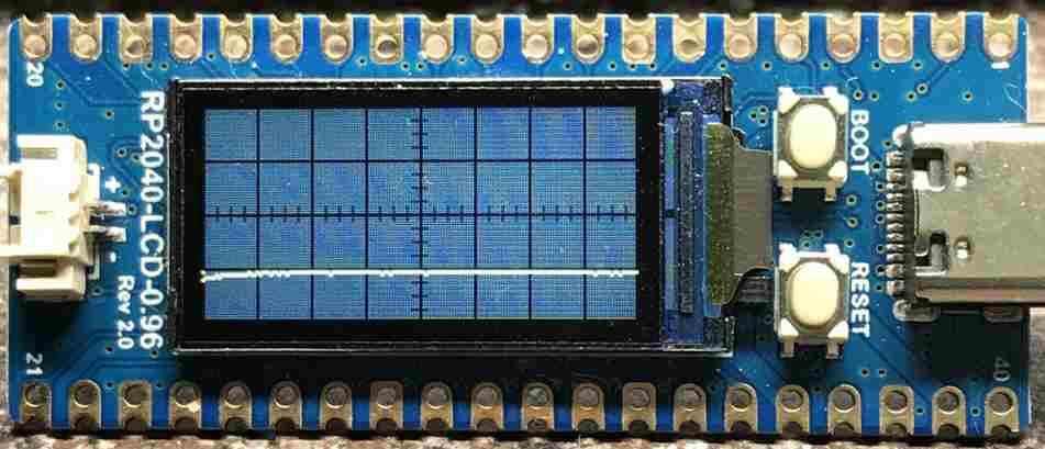

Here's an updated version of my scope code (above), adopted and significantly extended from previous versions. This single version now detects which LCD display it's running on, and displays nice major and minor graticules on the screen.  Display is nice and stable.
Next steps: add scope controls (sweep rate, sampling rate, offset, amplitude, trigger) to startup screens or touch controls.
'Analog Oscilloscope for WaveShare LCD boards (Landscape mode)
Const Hres   = MM.HRes           ' Horizontal resolution of display
Const Vres   = MM.VRes           ' Vertical   resolution of display
Dim integer x, y
Const GMajor     = RGB(black)    ' Color for Major graticule
Const GMinor     = RGB(12,12,12) ' Color for Minor graticule
' Let 'em know who we are
CLS Background
Select Case MM.Info(LCDPANEL)
 Case "ILI9488W"   ' A Waveshare P-E-B
   Const Major  = Vres/8          ' Major Axis Graticule size in pixels
   Const Minor  = Major / 5       ' Minor Axis Graticule size in pixels
   Text Hres/2, Vres/2-2, "Analog Scope by NPHighview",   "CB",1, 2, Signal1, Background
   Text Hres/2, Vres/2+2, "on Waveshare Pico-Eval-Board", "CT",1, 2, Signal1, Background
 Case "ST7735S"    ' A Waveshare RP2040-LCD-0.96
   Const Major  = Vres/4          ' Major Axis Graticule size in pixels
   Const Minor  = Major/4         ' Minor Axis Graticule size in pixels
   Text Hres/2, Vres/2-2, "Analog Scope by NPHighview", "CB",7, 1, Signal1, Background
   Text Hres/2, Vres/2+2, "on RP2040-LCD-0.96",         "CT",7, 1, Signal1, Background
 Case Else
   Print "Unsupported Hardware - Sorry!"
   Text Hres/2, Vres/2, "Unknown Hardware", "CM",1, 1, Signal1, Background
   End
End Select
Const HMajor = Hres/Major        ' Number of Horizontal Major Axis divisions
Const VMajor = Vres/Major        ' Number of Vertical   Major Axis divisions
Const HMinor = Hres/Minor        ' Number of Horizontal Minor Axis divisions
Const VMinor = Vres/Minor        ' Number of Vertical   Minor Axis divisions
' To scale 0.0 to Vres and 3.3 to 0,
Dim Buffer1!(Hres),     Buffer2!(Hres),     Horizontal!(Hres)  ' For signals
Dim HMajorx1(HMajor+1), HMajory1(HMajor+1), HMajory2(HMajor+1) ' For Horizontal Major Axes
Dim VMajorx1(VMajor+1), VMajorx2(VMajor+1), VMajory1(VMajor+1) ' For Vertical   Major Axes
Dim HMinorx1(HMinor+1), HMinory1(HMinor+1), HMinory2(HMinor+1) ' For Horizontal Minor Axes
Dim VMinorx1(VMinor+1), VMinorx2(VMinor+1), VMinory1(VMinor+1) ' For Vertical   Minor Axes
Math Set 0, Buffer1!()  : Math Set    0, Buffer2!() ' Clear signal buffers
Math Set 0, HMajory1()  : Math Set Vres, HMajory2() ' Set the Arrays for Horizontal Major Axis
Math Set 0, VMajorx1()  : Math Set Hres, VMajorx2() ' Set the Arrays for Vertical   Major Axis
Math Set Vres/2+Minor/2, HMinory1() : Math Set Vres/2-Minor/2, HMinory2() ' Set the Arrays for Horizontal Minor Axis
Math Set Hres/2+Minor/2, VMinorx1() : Math Set Hres/2-Minor/2, VMinorx2() ' Set the Arrays for Vertical   Minor Axis
For x = 0 To HMajor : HMajorx1(x)    = x*Major  : Next x ' for time  Major Axis graticule
For y = 0 To VMajor : VMajory1(y)    = y*Major  : Next y ' for volts Major Axis graticule
For x = 0 To HMinor : HMinorx1(x)    = x*Minor  : Next x ' for time  Minor Axis graticule
For y = 0 To VMinor : VMinory1(y)    = y*Minor  : Next y ' for volts Minor Axis graticule
Pause 2000
CLS Background
ADC open 64000,1 'samples per second
SYNC 100000      'Set a one-tenth second "tick"
 SYNC
 Line HMinorx1(), HMinory1(), HMinorx1(), HMinory2(), 1, GMinor ' Redraw overwritten
 Line VMinorx1(), VMinory1(), VMinorx2(), VMinory1(), 1, GMinor ' Minor Graticules
 Line HMajorx1(), HMajory1(), HMajorx1(), HMajory2(), 1, GMajor ' Redraw overwritten
 Line VMajorx1(), VMajory1(), VMajorx2(), VMajory1(), 1, GMajor ' Major Graticules
 SYNC

Is the second pic a micro-scope?
(gets hat and leaves the building)

While NPHighview is doing things properly and will make an excellent standalone scope, this simpler offering is for those who rarely need a scope. It is intended for breadboard use, tailored for a particular job then recycled thus it has no external controls.
' PicoMite VGA / LCD (any screen size) "scope test 1g.bas"
' MODE 2  'can also use Mode 1 B&W
' Adjust trigger, gain, screen size, buffer size and speed to suit.
Dim Float Trig = -1.65 'Set trigger voltage, use "-" for falling trig. V.
Dim Float gain = 1.0 'boost weak signals - an op-amp is better
Dim integer HRes = MM.HRes, VRes = MM.VRes 'Change if not using full screen area
Dim integer buff = HRes * 3  'Capture buffer size - min = 2 x horiz. pixels
Dim integer speed = 450000  'Sampling rate (Hz)
Dim integer H.offset = 40  'Adjust to view pre/post-trigger signal (+/- pixels)
Dim float V.offset = 10  'Adjust vertical position (+/- pixels) - don't go off screen
Dim integer TV = Abs(Trig)*gain*-VRes/3.3+VRes ' pixel value of Trigger Voltage
Dim integer dot, x, y, TC
Dim float samples(buff) 'using OPTION BASE 0
ADC open speed, 1 'samples per second, GP26
CLS
 samples(buff-1) = -1   'set last element to -1
 Text 1, 1, "T = "+Str$(HRes*1000/8/speed)+" mS/Div. V = 0.5V/Div."
 ADC start samples() 'get new samples + extra for trig. search
 Do While samples(buff-1) < 0 : Loop 'wait till array is full
 If H.offset > 0 Then TC = H.offset + 1 Else TC = 0 'allow for pre-trigger data
 If Trig > 0 Then  'wait for signal to rise/fall through trigger voltage
   Do : Inc TC : Loop Until samples(TC) < Trig Or TC > buff - HRes
   Do : Inc TC : Loop Until samples(TC) > Trig Or TC > buff - HRes
  Else
   Do : Inc TC : Loop Until samples(TC) > -Trig Or TC > buff - HRes
   Do : Inc TC : Loop Until samples(TC) < -Trig Or TC > buff - HRes
 Inc TC, -H.offset  'adjust for desired offset
 If TC > (buff-HRes) Or TC < 0 Then TC = 0 ' Trigger not found, plot from start
 Math scale samples(), -VRes*gain/3.3 , samples() 'scale 3.3V to screen heihgt
 Math add samples(), VRes, samples() 'set 0V to bottom of screen
 'plot graticule
 For x = 0 To HRes
  If x Mod (HRes \ 8) Then
    If x < MM.Info(FONTWIDTH) * 30 Then
      Line x, MM.Info(FONTHEIGHT), x, VRes, 1, 0 'delete old trace except text
     Else
      Line x, 0, x, VRes, 1, 0 'delete old trace
   Else
    Line x, 0, x, VRes, 1, RGB(0,64,0) 'Time grat.
  For y = VRes-1 To 0 Step -VRes/6.6
   Pixel x, y*gain-V.offset, RGB(0,64,0) 'Voltage grat. in 0.5V increments
  Next
  Pixel x, VRes-1-V.offset, RGB(0,128,0) '0V line
  If x Mod 4 = 0 Then dot = 255 Else dot = 0
  Pixel x, TV-V.offset, dot 'plot Trigger level.
  Line H.offset, 0, H.offset, VRes, 1, RGB(0,0,128) 'plot trigger time
  'plot trace
  Line x, samples(x+TC)-V.offset, x, samples(x+1+TC)-V.offset, 1, RGB(255,128,0)
 Next
ADC close
End
Edited 2023-07-24 11:12 by phil99

Could not get to work
C:\Users\stanley555\Documents\mmbasic programs\oscillscope-forum1160x80.bas
Uploading using:  'target port\COM5:115200 s\picomite
Upload started
NEW
AUTOSAVE
Upload completed
Saved 3269 bytes
RUN
[19] Dim Buffer1!(Hres),
Error : Syntax
Upload started
NEW
AUTOSAVE
Upload completed
Saved 3277 bytes
RUN
Error : Syntax
Upload started
NEW
AUTOSAVE
Upload completed
Saved 3276 bytes
RUN
[34] Math Set 0, HGraty1()  : Math Set Vres, HGraty2()  ' Pre-set Arrays for Horizontal Graticules
Error : Cannot find HGRATY1

Hi, Stanleyella -
I'm suspicious that you're getting different byte counts for each upload attempt. Please try using XMODEM, or copy the file to an SD card if you have a card reader attached.
Also, here's what I have for version and options on the Waveshare RP2040-LCD-0.96 board (just copied from an OPTION LIST command output):
PicoMite MMBasic Version 5.07.08b8
OPTION SYSTEM SPI GP10,GP11,GP28
OPTION AUTORUN 2
OPTION COLOURCODE ON
OPTION HEARTBEAT OFF
OPTION CPUSPEED (KHz) 250000
OPTION DISPLAY 50, 132
OPTION LCDPANEL ST7735S, LANDSCAPE,GP8,GP12,GP9,GP25
Mine has been running without problems for at least three days now, using this code, just copied from my live system:

You could try zeroing out the buffer, and once it gets stuck, hit [ctrl]-[c] and print out the buffer contents from the command line to see what (if anything) it picked up.
Posts: 3417
Posted: 04:25am 27 Jul 2023
'do                                       'mysync
'adc start samples!() 'get new samples   '
'loop until samples!(2)>samples!(1)       'this is the point... carp.
For this to synchronize properly it needs to restart filling the array before the first ADC START has finished. I am not sure that is possible.
In my example a random lump of samples (at least double the screen width) is captured then scanned for the trigger condition. From that point on the data is written to the display, up to MM.HRes.
It should work with your display. See first line
Edit
This is what I get on an ILI9488 with the graphics area limited to 160 x 80. (the displayed trace is from a DHT11 sensor).
For best results on your display adjust settings in the first section and remove the TEXT command and section referring to FONTHEIGHT and WIDTH.
    Else
becomes
Also change the voltage graticule spacings.
