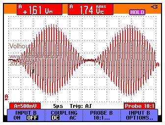

Opens a whole new world.. A simple AWG (Arbitrary Waveform Generator) programmable in MMBasic.
Such as: AM modulation
Ho-ho, before the HAM readers get too excited. The picomite memory, even when optimally used can only calculate a modulation frequency of 1kHz (not lower) on a 1MHz carrier. There simply is not enough memory for lower modulation frequency.
So it is nice, and you can do nifty things, but it is not capable of a 2 transistor 9 capacitor 6 resistors 1 inductor AM modulator circuit.
