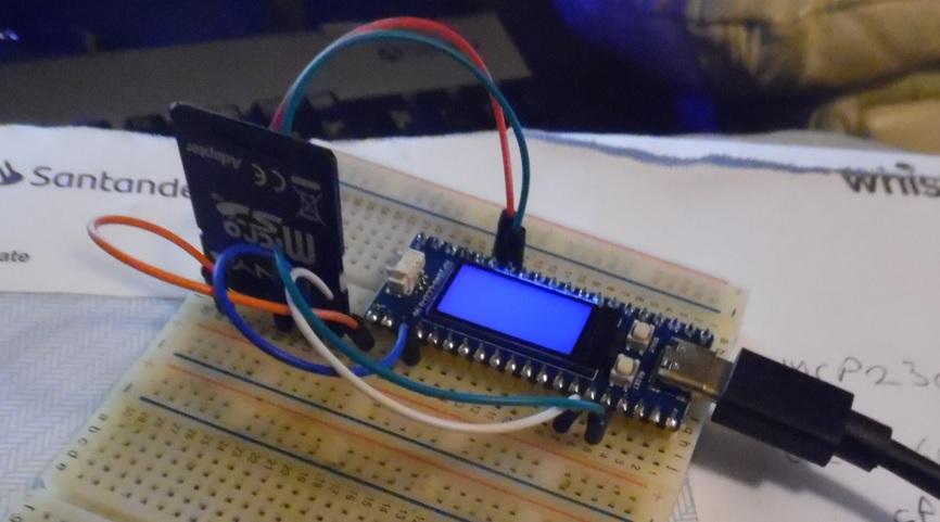

Maybe my soldering is carp. I tried not sharing spi with display and used optin sdcard but no joy. can't think of anything else. The 4GB has a file.bas but just shows drive A:
I'll solder another. yawn :) Ta for helping though Mick :)

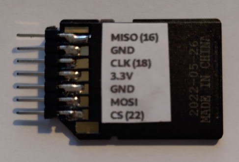

If you are specifying all the pins the sequence is
OPTION SDCARD CS, SCK, MOSI, MISO
These have to line up with the card connections, obviously.
In order from the chamfered corner of the holder the order is 9,1,2,3,4,5,6,7,8
9: no connection
1: CS
2: MOSI
3: GND
4: 3V3
5: SCK
6: GND
7: MISO
8: no connection
Note that there are two GND connections (they may be linked elsewhere but it does no harm to connect both).
Better check your wire connections to the socket. Maybe try a different set of holes on your breadboard too. Your soldering doesn't look bad to me.
Are you certain that the card is formatted FAT16 or FAT32? If you just put it into a windows machine and format it it will probably end up as NTFS and it won't work.

Posted: 08:45pm 21 Jun 2023
The card is fat 32 with a .bas file.
The card was wired correct for sharing the spi with the display, just added option sdcard gp16 then reset and used gp22 instead.
Then tried option reset and set up again but OPTION SDCARD GP22, GP18, GP19, GP16
No pins used twice
Still no joy ie files lists A:

I assume you checked with a meter for shorted pins on the SDcard socket? There could be heat damaged insulation where you can't see it, I suppose.

sdcard adaptor no shorts but maybe no connection to card? not meant for soldering,try again.
