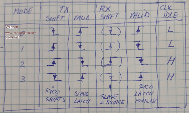

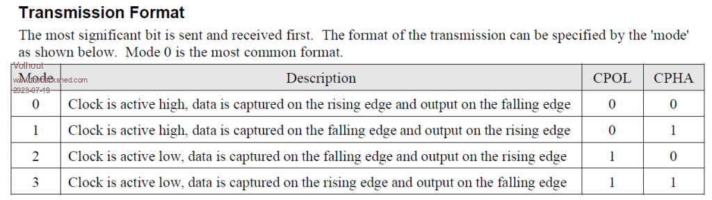

Playing with SPI to read an attached ADS8326 ADC.
Checked the 4 SPI modes:
The table is correct, but after I measured with a scope, I understood that "output data on falling edge" means "output shifts at falling edge".
So your SPI device must be configured to latch the data at the rising edge.
Edited 2023-07-19 18:51 by Volhout
