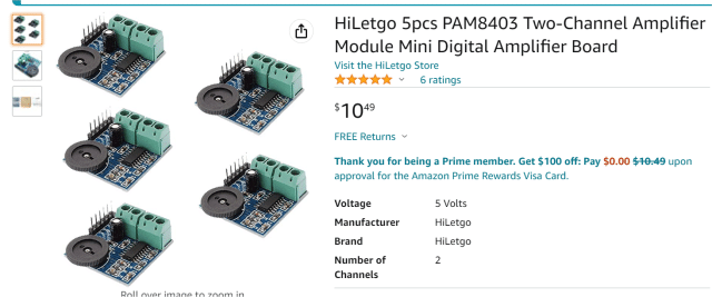

Posted: 06:30pm 25 Mar 2023
  thwill said  this conversation has a life of it's own now
I had hoped to learn something from this thread and the previous one, but I'm afraid it's back to the PAM8403 for me:
Adequate and convenient is all I'm looking for. Kudos to those seeking something better.
Posts: 9252
Posted: 06:35pm 25 Mar 2023
Just use a potential divider before the input of the PAM module. You probably need to drop the signal to less than a volt. The volume control will take it up or down from there. If you do that you can run the PicoMite with PLAY VOLUME 100,100 to get best quality without overloading the PAM. The resistors will give you better control over the volume.
