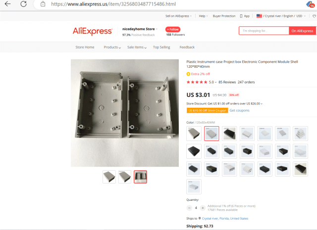

Here's a box, 120mm x 80mm x 40mm, which comes with removable end panels. PCBs of the size of those panels with the cutouts for the desired connectors could be produced.
The boxes only cost $3.70 U.S. each with shipping if 4 are bought (I don't know if or at what point shipping costs would begin to rise). You could get both end panels off of a single JLCPCB design, so the end panels for 5 boxes would be about $6.40USD with shipping, giving a total cost of about $5 per box.
The top would still need a cutout for an LCD--ILI9341 or ILI9488. With care that could be made with a jig and a side-cutting bit on a drill press. Long pin female headers could stand the LCD off the PCB through the top.

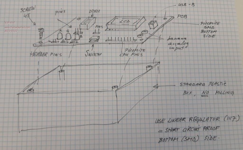

Had only few minutes, so this is my way of looking at it.
All pins on top side (accessible) are ESD protected with series resistance and diodes. Power is from linear regulator (inherently short circuit protected) banana plugs give access to ADC via resitor network, so you can measure +- 10V
LCD is fixed wired to picomite. No access.
DTH22 is accessible.
LED's and switches are accessible.
The PCB acts as lid on the box. No milling, just 4 screws to put together.
Linear regulator and picomite are SMD mounted on the bottom, so not accessible.

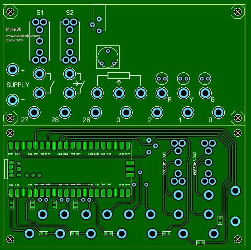

Right, this is only something to start with. I know it's incomplete, but I wanted to see what it would look like and how awkward the track would be likely to get. I've shown the front and the back of the board. it's shown as 50mm x 100mm but as you can see, space is restricted. This is about as cheap as it's possible to go, single PCB stood on short spacers. The pot is a square trimmer with a built-in knob. The switches are Multicomp from CPC and I left off the power switch, SD card and sensors. Putting stuff on top of a surface mounted PicoMite isn't good so it may have to be plug-in. That's awkward when you don't want to have the pins poking through.
