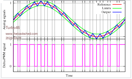

- There IS audio at the output of the filter - see the attached diagram:
The output is the blue jagged line. The more aggressive the filter is the lower level of 'jaggedness' there will be in the output. This is why I asked Volhout for a two stage filter cutting of a around 5kHz. Notice that there is a DC offset in the audio signal.

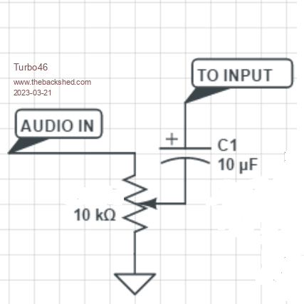

- The volume control pot for an amplifier must never pass DC. This causes a scratchy noise particularly when it is turned. See the attached circuit:
The capacitor needs to be reasonably large because it needs to pass the audio signal frequencies recovered from the PWM.

Mick, While I agree with much of what you say I think you may be over stating the effects of the 40kHz on the output. I guess a notch filter centred at the offending 40kHz would be best if that were incorporate into a low pass filter circuit but do we really need to aim for HiFi?
Bear in mind that for Tom's use he is not feeding the signal though a HiFi amplifier to a set of HiFi speakers but to a Micky Mouse tiny speaker.
The maximum frequency of his music is below 5kHz and that is why I suggested a two stage RC filter with a cut-off at about 5kHz. A properly designed two stage RC filter will have twice the roll-off rate of a single stage filter not 'just a little bit'.
Where that leaves the PWM signal residue of 40kHz, I don't know but I don't believe it will affect Tom's project.
