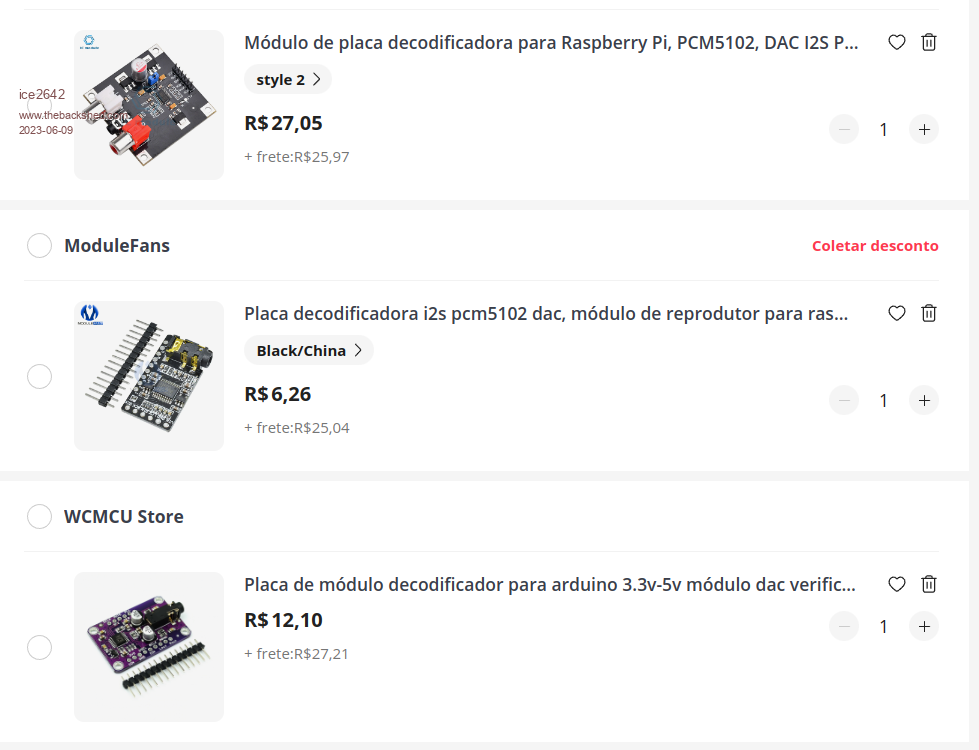

Posted: 05:41pm 08 Jun 2023
  Mixtel90 said  In MMBasic the PLAY sounds are generated by PWM. You *need* a filter or all you get is a modulated 44kHz square wave. You are lucky to be hearing anything at all. :) A simple RC filter will get the audio out of the carrier, but it won't get rid of the 44kHz carrier. That's not good for amplifiers and speakers. This is why Volhout has produced some more complex filters.
IIRC Tom's case is a bit special. The tiny speaker acts as a mechanical filter to reduce the 44kH. It can't simply be substituted by an amplifier input.
You get better quality with less filtering by using a DAC.
Can you sugest a good DAC for use with PicoMite in Aliexpress?
I am looking this models in the attached image.
PCM5102 the first 2 and UDA1334a

You are new to the forum, and there have been megabytes of discussions on audio the last year. To summarize: pwm audio needs a filter, and the picomite powersupply causes noise. Simplest is to use a linear regulator for 3.3V.
Good tip, I'll give a search in the old threads on the subject.

Posts: 9251
Posted: 06:10pm 08 Jun 2023
Ice:
The PicoMite supports the MCP4822 DAC chip (and other members of that family). I got some through-hole ones from AliExpress.

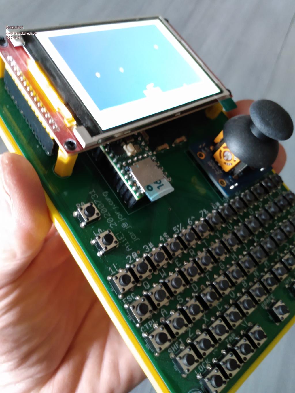

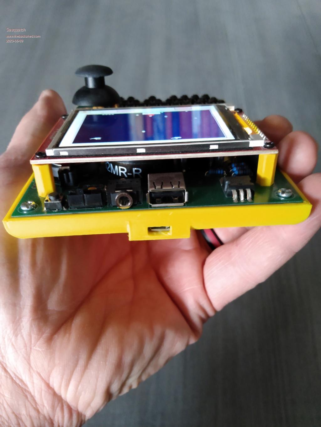

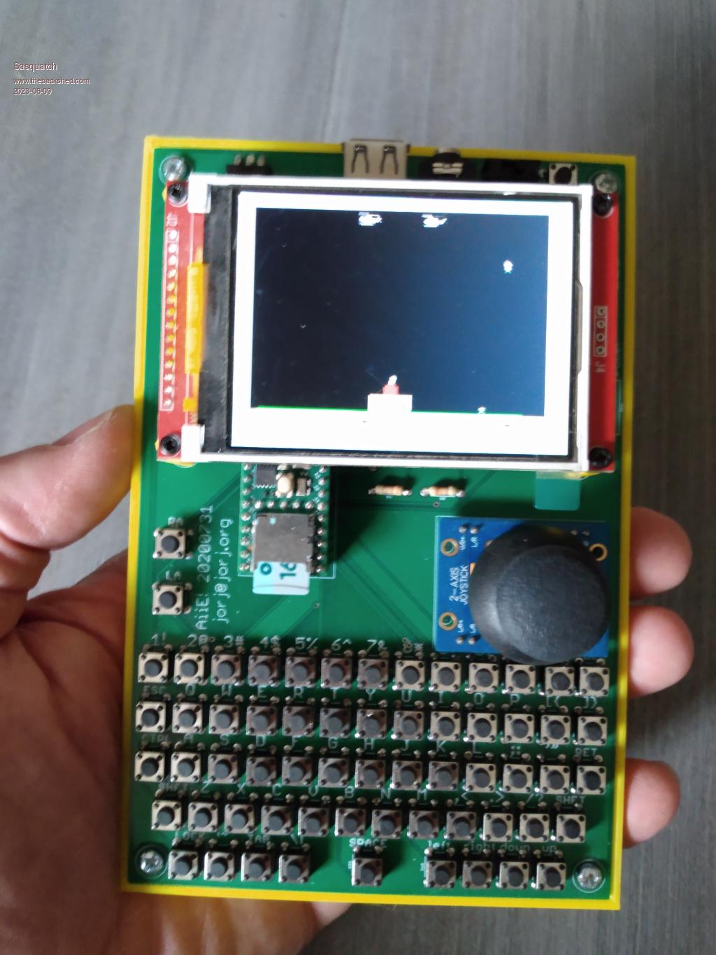

Posted: 08:05pm 08 Jun 2023
Thwill said:
  Quote  uncased this is never going to be a particularly robust device
I have started 3D printing "Trays" for my "Uncased" PCB's  The "trays" cover the back of the PCB and prevent shorting out the solder joints.  The "trays" also give some stability when sitting on the bench or table.
Here are some photos of a tray I printed for a similar project.  The project is an Apple//e emulator using a Teensy 4.1 (on GitHub as Aiie by JorjBauer.)  The main PCB is screwed firmly to the tray and the tray encloses the LiPo battery and charging/boost module.  You can also see the custom printed standoffs supporting the LCD module (in this case the LCD is only supported by pin-headers on one side.)  I used lower profile machine pin headers for the Teensy module and raised the LCD headers slightly to allow clearance under the LCD module.  You can see the micro USB charge port on the top edge of the tray.  This tray has rounded edges and fits nicely in the hand.  I considered adding a top to the tray kind of clam-shell style but I think leaving it open gives the project a nice retro look.
-Carl

Posted: 10:13am 09 Jun 2023
Hi Carl,
  Sasquatch said  I have started 3D printing "Trays" for my "Uncased" PCB's  The "trays" cover the back of the PCB and prevent shorting out the solder joints.  The "trays" also give some stability when sitting on the bench or table.
Very, very nice.
Whilst not as pretty I've found the Bintendo's two PCB sandwich provides similar stability and a level of protection against shorting. The Bintendo suprisingly has reasonable weight and ergonomics, especially for the minimal effort it requires (I've made a deliberate decision to have nothing to do with 3D printing or CNC at least until I retire; there aren't enough hours in the day as it is.)
The final hardware will be licensed under CC BY 4.0 so perhaps someone else might choose to take it further, I know @bigmik has some ideas about squeezing this all into the existing enclosure from one of those cheap Chinese "NES on a chip" handhelds.
Thanks for your interest,
Edited 2023-06-09 20:46 by thwill
