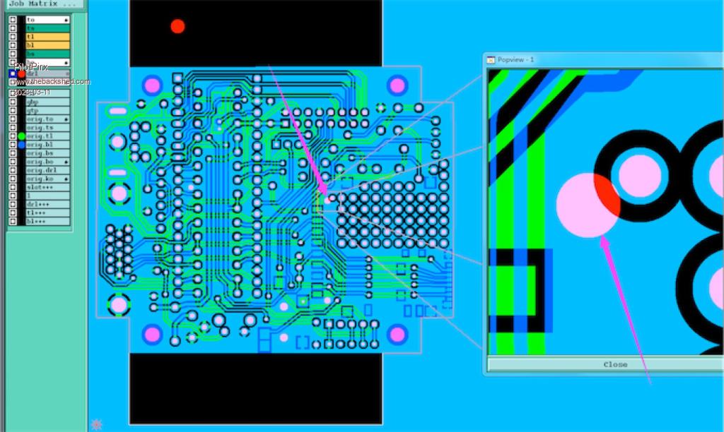

I got an error Message from JLCPCB. They want to remove a hole:
It seems to be a mistake. I have allowed them to remove the hole.

Posted: 12:19pm 11 Mar 2023
I'd have taken the pad off instead. That hole is a locator for the SD card. The pad is merely a support for my experiment to fit a HC-12 inside the case.
I've just got the message too. Here's my reply:
  Quote  Hello,
Please can you remove the adjacent pad instead? The hole is a locator hole for a SD card holder, the pad is merely for an experiment.
Thank you.
To be honest, I had my doubts about that anyway. The holes are too close together. As the HC-12 can't be fitted with the standard SD card I can always do something with that locator hole. I might turn it into a pad and make it dual purpose.
Edited 2023-03-11 22:23 by Mixtel90
