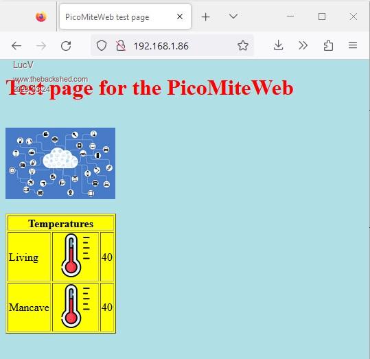

In this chapter we are going to enhance the webpage more.
First thing is to add a table to the page so we can put some order to our data.
Next step is to give the table a header so we know what it's about.
Then the chapter shows how to give the table a different color as the standard webpage background
Then comes the fun part.
The previous chapter shows how to put a graphic on your webpage.
This chapter shows how to put significant graphics in the table so your data really looks nice.
Here is how the webpage will look:
And here is the chapter that puts it all together:
