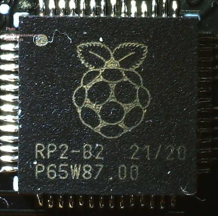

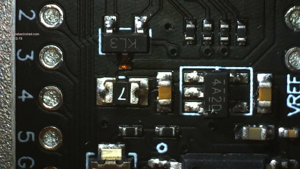

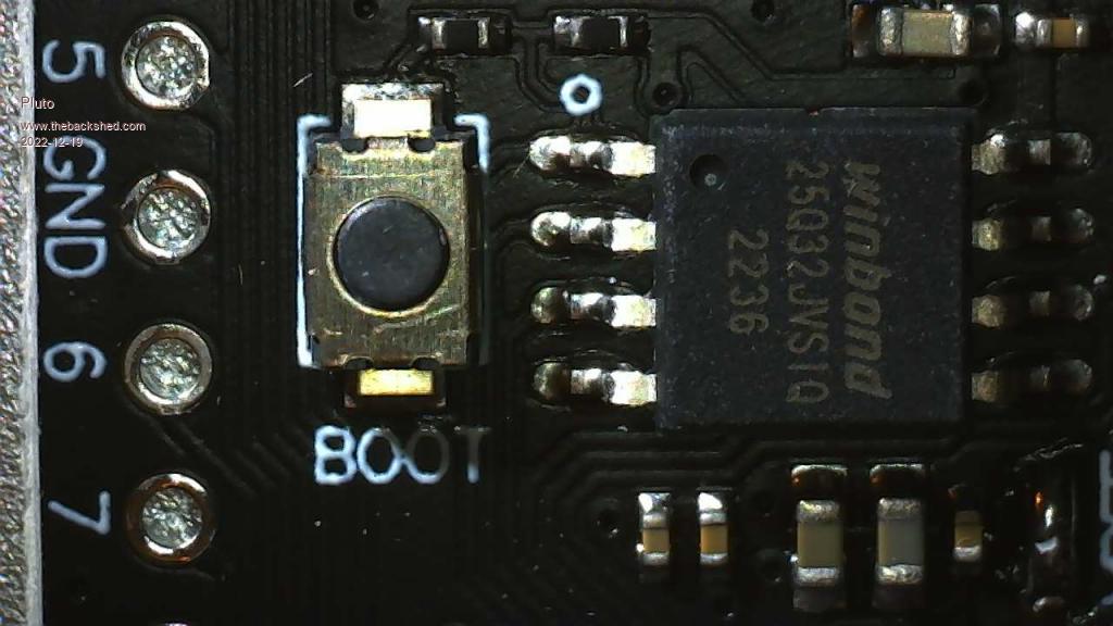

The ones I bought and successfully use do also look like there would be no Logo on the RP2040 chip on the seller's site. The arrived modules do however have the Raspberry Logos.
https://www.thebackshed.com/forum/ViewTopic.php?TID=15398&P=2#195152
Flash memory:
I suppose one of these is the regulator:
Latest order was 3.30EUR incl shipment and VAT (4MB version). Still to come 16MB version at 3.63EUR incl shipment and VAT.

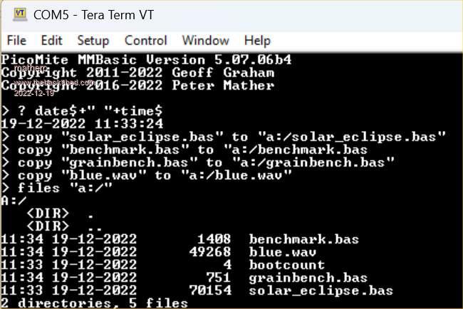

V5.07.06b4
PicoMite.zip
I've found a way of using the flexible attributes capability of LittleFS to implement time stamping of files so the flash system is now pretty much indistinguishable from the SD system
Please test this version. My current feeling is to skip the 5.07.05 release and go straight to this. The changes are all in the file system so as long as that works OK there should be little else that may have gone wrong. Please report any issues.
I've kept the active file system as the SDcard if enabled (and a disk in place) so that existing programs run without change.
Edited 2022-12-19 21:36 by matherp

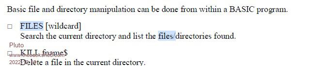

Pluto
Joined: 09/06/2017
Location: Finland
Posts: 421
Posted: 01:44pm 19 Dec 2022
Thanks Peter!
Could maybe be mentioned in the manual.
Page 38 in the PicoMite User Manual says:
