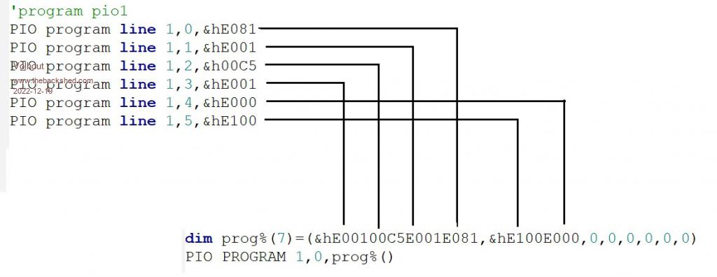

You have to dimension an integer array (64 bit values), and fill that array with the 16 bit program instructions (4 instructions per array cell). Your array must be 32/4=8 wide (or 0...7).
These 4 instructions map as follows:
Programming the PIO, using this alternative method would look like this:

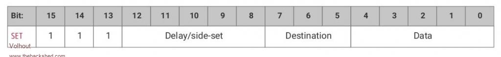

The SET instruction to set a value of 31 to register X is one of the few instructions to fill X (and Y) with a value. So the use of X and Y is pretty limitted until we discuss the ISR and OSR registers (next chapter).
DELAY: discussed before
DESTINATION: "001" set X value ("010" set Y value)
DATA: the binary data to set X (or Y) to. Only 5 LSB bits, the other bits (31...5) are set to 0
SET X=31, dly=0 translates to
111 00000 001 11111 = 1110 0000 0011 1111 = &hE03F

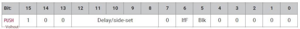

The PUSH instruction can put data from the state machine into the FIFO. But it can push only 1 register: the ISR register. There are no provisions in the PIO too PUSH the X register, or the Y register, or pin states. Only the ISR register can be pushed into the FIFO.
We will detail the ISR register later, let's first focus on the PUSH instrcution itself.
DELAY/SIDE SET : we have discussed delay before
IFF: If Full (we will not detail this here)
BLK: Blocking
Blocking: this is like the WAIT instruction. In case the FIFO is full, stop the state machine until it can push data into the fifo. When block is used, no data get's lost. But the state machine stops. In some cases that is desirable, sometimes it is better to leave the state machine working, and discard the data that does not fit in the FIFO. It depends on the speed of the ARM processor if blocking occurs. Since the PIO can run much faster than MMBasic can execute, this must be carefully considered.

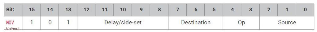

But how do we get the X value into the ISR: the MOV instruction
The MOV instruction is used to copy data from one register to another. It can be used to copy data from SOURCE (i.e. X) to DESTINATION (i.e. ISR), and on the way doing this also do some basic manipulation (like invert the data).
DELAY/SIDE SET : discussed before
DESTINATION: "110" for ISR
OP(eration): "00"=none, "01"=invert,"10"=bit reversed
SOURCE: "001" for X, "010" for Y, "011" for NULL (&h0)
Read chapter 3.4.8 on the RP2040 manual for all the options. For now we have all the block to have MMBasic read data from the PIO state machines. Let's get started on our big project: the multifunction counter.

The only thing in above pseudo code that needs explanation is the set X=-1. The SET command can only set values up to 31 (5 bits) into the X register. It cannot be used to put the value &hffffffff into the X register. But the MOV command can. It can move the value 0 (NULL) into the X register INVERTED. See above explanation of the fields in the MOV instruction.
MOV X=-1 => 101 00000 001 01 011 = 1010 0000 0010 1011 = &hA02B
Similar we decode the instruction to move -X to ISR (see above explanation of the fields)
MOV ISR=-X => 101 00000 110 01 001 = 1010 0000 1100 1001 = &hA0C9
