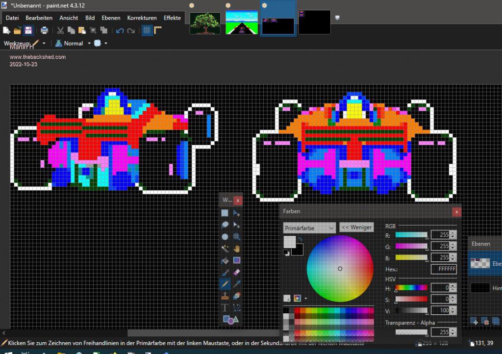

Hi vegipete
i ve done some little changes in your code and added the new Protagonist.
'modyfied by vegipete

Posted: 06:52pm 24 Oct 2022
I like your code but it is really more suited to mmb vga not lcd.
It is 7 fps with a 32 pixel high scrolling background.
The mmb vga version is a bit too niche for me but a great hobby idea.
A touch lcd seems more relevant than a trs80 clone.

Posted: 05:57am 25 Oct 2022
  stanleyella said  I like your code but it is really more suited to mmb vga not lcd.
7 FPS is really not very pleasant. On the other hand, I think it's very good that you're so interested in the code, so it would be a shame if you gave up. Some valuable insights are gained by studying foreign program-codes.
So even if you can only get it running at 7 fps, you've certainly gained a lot of experience.

compressing the Sprite Data
--- Mart!ns little Toolbox
So far I've used a text editor to search and replace repeating parts of the Sprite Data strings with the compressed form.
which is quite laborious.

You can do something like this 2-3 times, but it's boring and a real punishment. So I thought, the pico can do that much faster and with less effort so let him do the work

in combination with the sprite read and expand routine you can save quite a few kilobytes.
happy pixel counting
Mart!n

Optimizes the hell out of the DrawTrack Algorhythm.
Not really readable anymore (I wouldn't understand it anymore) but, including all features, it now runs with 31.792 FPS at 378000 KHz

Sub DrawTrack curv
 Box 0,hh%+2,sw%,hh%-2,,COL%(2),COL%(2)
 For F%=2 To HH%
   PDist%=PPos%*f%/HH%:BB%=f%>>2:bc%=bcol%(dst,f%)
   ofs%=xofs%(f%)*curv/100:y%=hh%+f%
   b1x%=PDist%+HW%-F%-bb%+ofs%:b2x%=b1x%+BB%:b3x%=b2X%+(f%<<1):b4x%=b3x%+BB%
   Line b1x%,y%,b4x%,y%,,bc%:Line b2x%,y%,b3x%,y%,,0
 Next
 Inc dst,spt:dst=dst And 7
