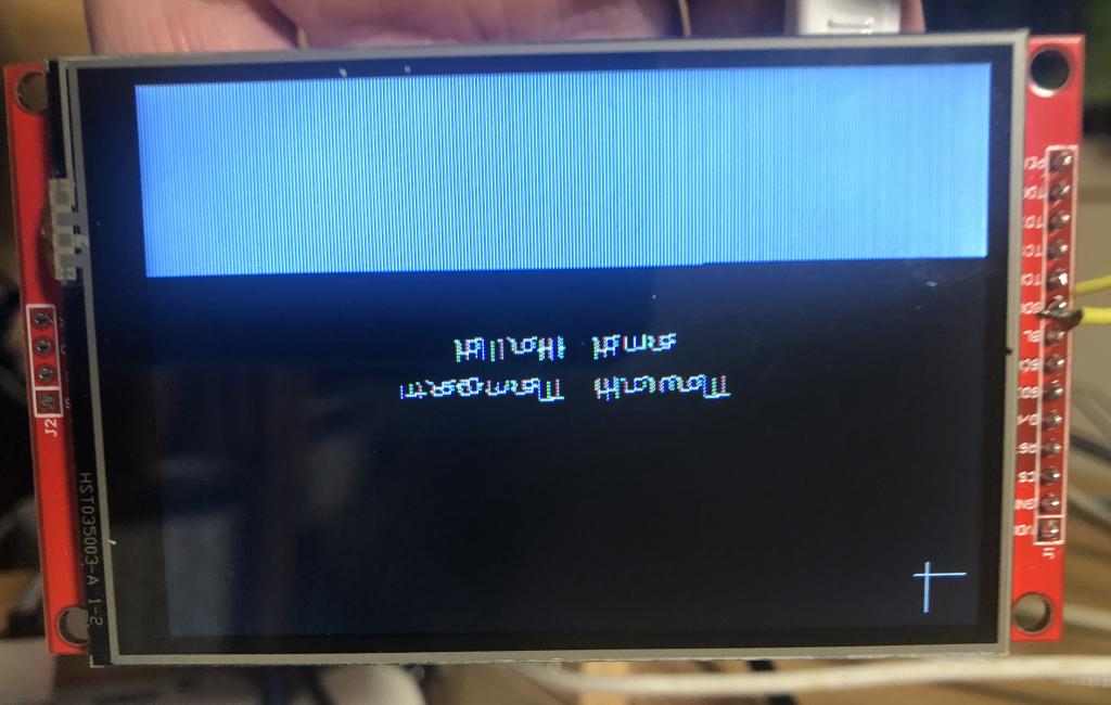

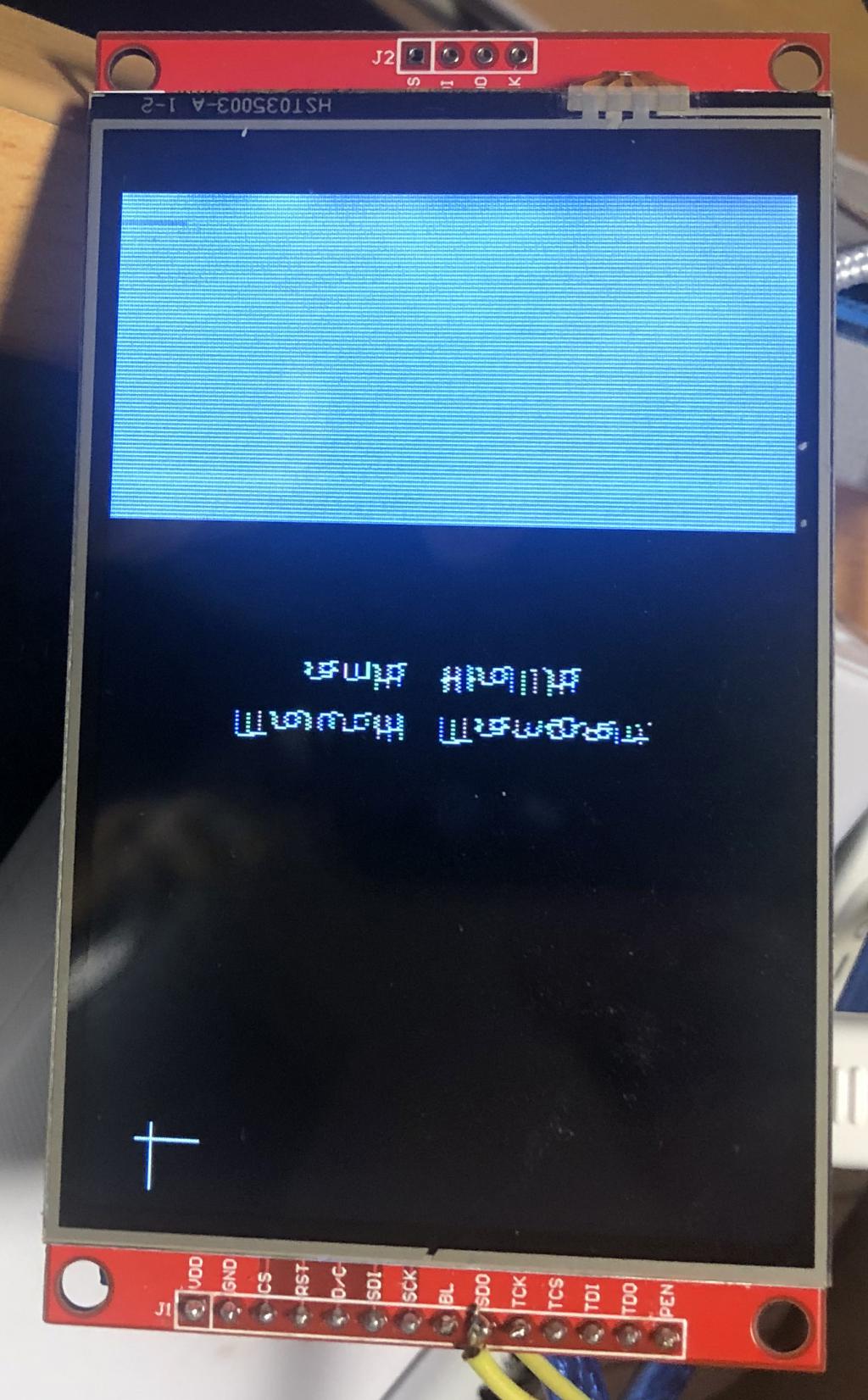

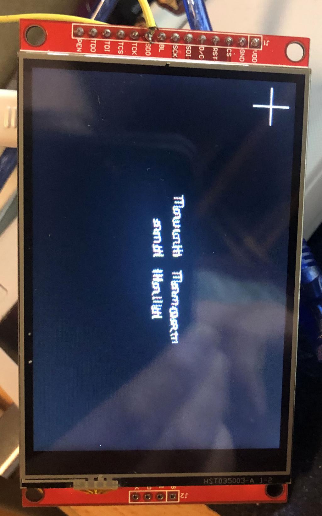

Hi Peter,
You are getting Very close
On power up after a second or so the screen goes white possibly missing every second row then goes through a clearing motion from the bottom and leaves about 1/3 of the screen white (every second row still missing)
I then Issue GUI CALIBRATE and I can see some form of not quite readable text and a part cross hair but no circle.
See attached Picture
That is the first time I have seen ANYTHING on the display.

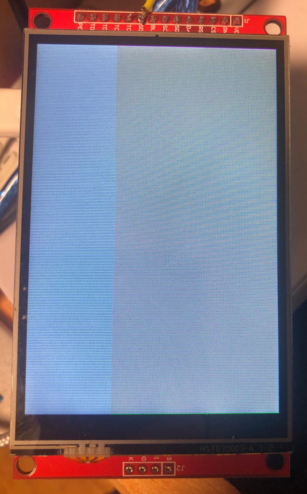

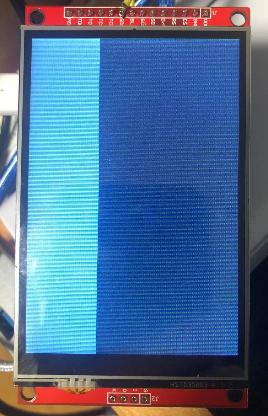

Mick, please also try CLS RGB(RED), blue etc. Looks like it is dropping pixels
Posted: 10:20am 29 Jun 2022

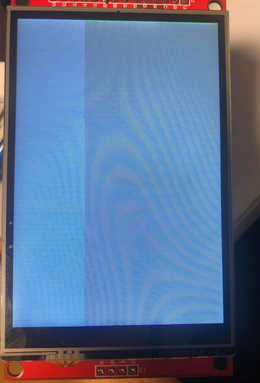

Hi Peter,
Here is the result of the three Tests
Red
Blue
Green
Note that none of the fills seem to be the correct colour,
I also tried Cyan and Pink but similar none were the correct colour and all only 2/3 screen with alternate lines missing
I tried all tests with and without MISO connected and the results are the same

That scribble is interesting. Inverted and written twice, 1 pixel down and about 3 horizontally. How strange. Is it trying to get neater text but missing?

It could be my picture taking but then I have seen the actual display so it is like it’s doubled and out of kilter, the screen also (at least in portrait) appears to be reversed horizontally as I know from working with other screens the cross hair would be at top left in GUI CALIBRATE and it is trying to print TOP Right.
I don’t know off hand if this is the same in Landscape but I suspect it is.

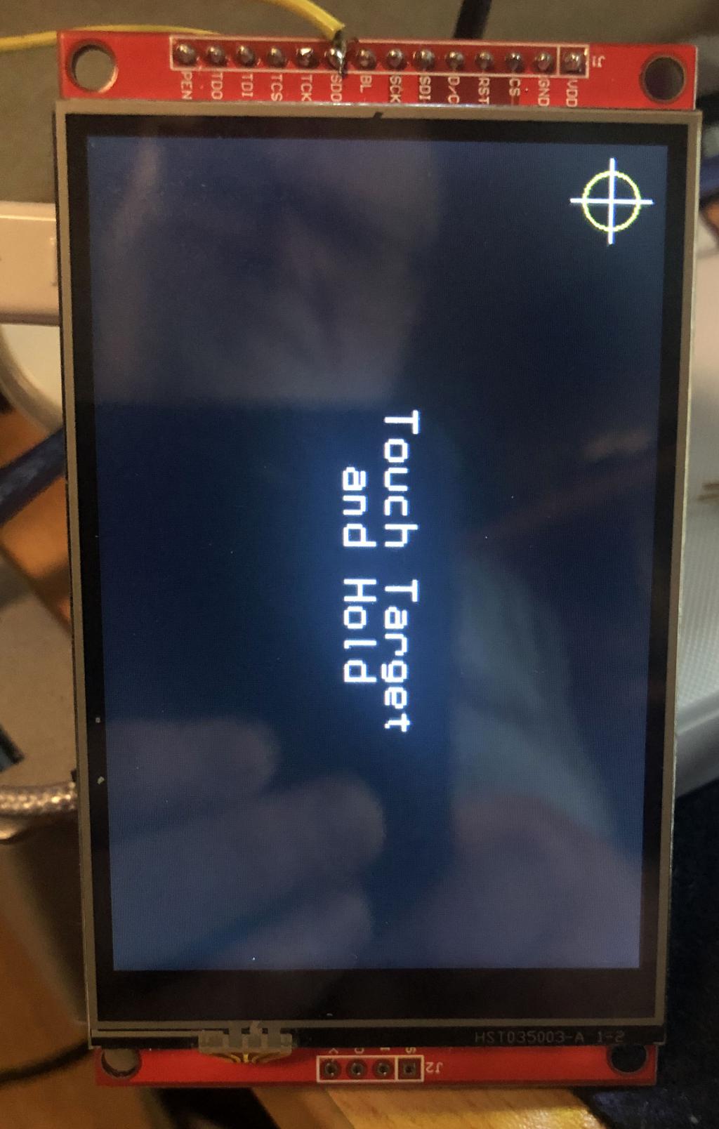

On power Up I can see a change from Black (initial application of power to a full darkish white then a slow (probably takes a second (maybe a bit less) to get to a dark grey background (almost black)
I then typed GUI CALIBRATE and I got this screen

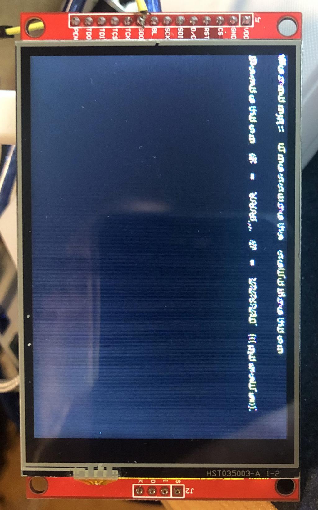

The touches all progress as normal but no circles on the Targets and the text is not legible then it ends in this screen
The text is not legible but I can almost make out the first word is "Warning:" I cant really make out anything else in the text.

Posted: 01:44pm 29 Jun 2022
Hi Peter,
You are indeed a Miracle worker
It is `almost' there.
Gui Calibrate does this.
The only problem I can see is the yellow target circle.
Of course as you said everything IS slow.

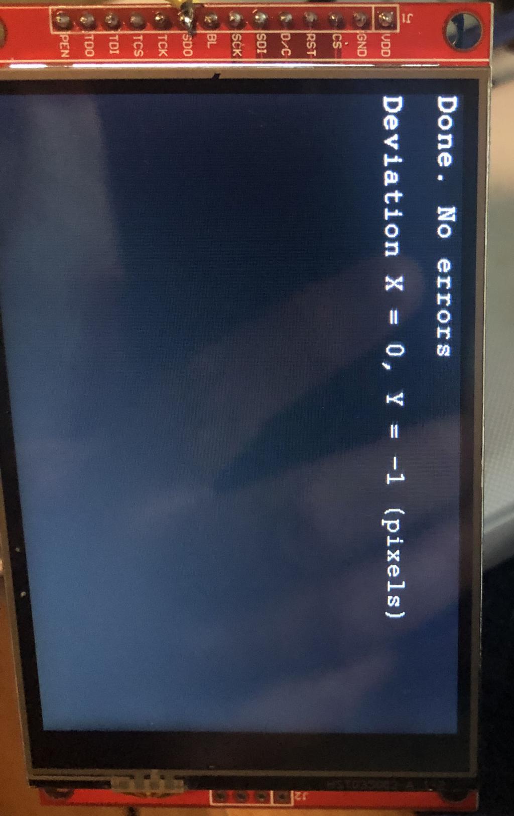

at the finish we get this.
As far as I can see it is perfect
I tested CLS in red, blue, green, yellow and Cyan and all look great
I then attached the MISO wire again and tried Phil99's test and it seems it may have the same issue as the ILI9488 as I cant read the pixel, however the calibrate works still with MISO connected
