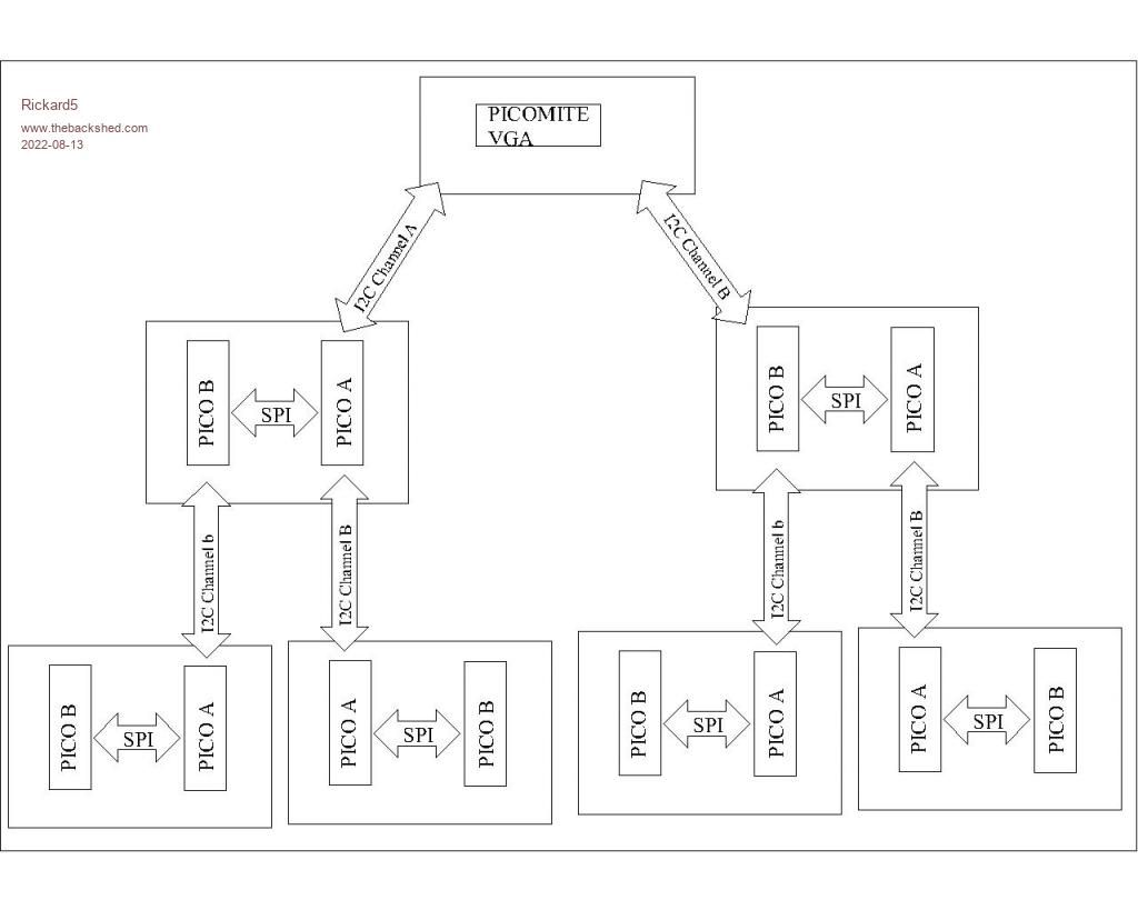

I been thinking about this, and I promise I'm not drunk, Just Simple minded  I been thinking hard about how to Scale up the number of picos in the Cluster, if I understand it correctly, I can use SPI to communicate between Pico 1 and Pico 2 and use SPI to communicate between Pico Pear Boards? I threw together a quick diagram to illustrate my thinking:
My Thinking is not only would this give me tons of GPIO to mess with, But break down Large Complex projects in to sub Processes each with it's own Pico.  for example if I were to get back in to Racing Slotcars or R/C and I was inclined to build a better Motor Dyno, I could dedicate one Pico to manage the Acceleration of the test motor and log Voltage over time. another pico could monitor and log Motor RPM, RPM over Time and another could monitor and log  Feedback voltage during Dynamic Breaking , and so on though all the test points and then pass that data up the chain to the next lever that process all that data, and pass it up to a Master control program on the top level Picomite VGA that acts solely as a front end processor and I/O controller, I also could do something I've always wanted to do and maybe build a Wind Tunnel the same way :) does this seam Reasonable ?
Thanks Guys
Edited 2022-08-13 16:07 by Rickard5
Posts: 9260
Posted: 07:11am 13 Aug 2022
IMHO there are better ways, and less complex.
You could use a single I2C bus for everything, giving each slave an address. Usually only for short distances.
You could use SPI from the PicoMite VGA with a CS pin for each slave. That would be very fast and doesn't need slave addresses, but the number of slaves is limited by the number of CS pins available. It's also short distance only.
It's also possible, with some fiddling, to multi-drop using a COM port.
You could do a proper RS-485 link between everything. That has the advantage that long distances are possible.
None of these arrangements needs a "tree" arrangement and only a single port is needed for each device.

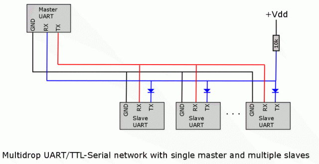

I'm not sure about the kind of scalability you're looking for, but why not straight multi-drop serial, call and response? This is pretty trivial.
Posts: 9260
Posted: 11:36am 13 Aug 2022
The master RX pin should have a pull-up and the diodes on the slaves should be pointing down. Their TX pins will normally be high, and the master RX pin will be pulled high. Each slave can then pull the master RX pin low via its diode.
The master TX pin can just be hard wired to all the slave RX pins as they all receive the same data (each one has an address). You can have an optional pull-up. All the RX pins are high impedance.

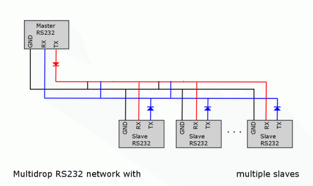

  Mixtel90 said  The master RX pin should have a pull-up and the diodes on the slaves should be pointing down. Their TX pins will normally be high, and the master RX pin will be pulled high. Each slave can then pull the master RX pin low via its diode.
That's what I get for copying an image from the 'net without understanding it. This one looks like what you're saying.
Posts: 9260
Posted: 03:14pm 14 Aug 2022
Yep, that's the idea. :) It's a very neat scheme, but you need a protocol that includes addressing for the slaves and (preferably) some sort of error checking. The master can talk to all the slaves at once if you specify a global address, but the slaves can only reply to specific messages from the master if you want to avoid bus collisions.
