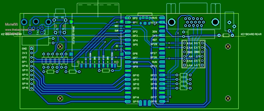

The only problem if you mount it flat is that you lose access to the USB connector. There are two ways round this: Cut a notch in the PCB and mount the Pico up to that end, allowing a USB plug to be plugged in or, and this is better, put THP pads in the appropriate places on the board and, when you are mounting the Pico, give it a dose of flux first then just fill the pad with solder. It will wick through to the Pico pad.

You can't get a microUSB plug into a surface-mounted Pico. The plug wall is thicker than the PCB thickness of the Pico so it prevents the board sitting flat. You *might* be able to get flying leads off the bottom of the Pico and out through a big hole, but you're soldering onto SMD pads - you may as well put THP pads there and route the traces out to a USB connector of your choice.
Why even consider flying leads? If the Pico is surface mounted the maximum height for the board is 15mm in total - and that's for the PS/2 connector so you may be able to do away with it. A VGA connector would give a maximum height of 14mm. The board profile would be naturally tapered inwards, especially if resistors aren't stood on end.
I can get about 11mm-12mm height under a cheap keyboard at the back with the legs down. I could probably stick a 2" deep x a foot long pcb under it and still get all the connectors along the back simply by standing the keyboard on a 5mm spacing strip at each end.
Another approach which I've not seen mentioned is to let the connectors stick out of the back of the keyboard. That would add about 22mm to the keyboard front-to-back measurement. The rest of the pcb would fit under the keyboard if it's kept more or less flat.

The microUSB connector slightly protrudes from the Pico PCB. If the mating PCB edge lines up flush with the Pico PCB, you absolutely can plug in a microUSB cable into the Pico.
Posts: 9265
Posted: 05:32pm 16 Apr 2022
Oh yes, if you can arrange it to line up that's fine, but I suspect people will want rear connection to the USB port for updates etc., so the Pico has to be arranged either front-to-back or the USB signals have to pass through 90 degrees to get to a socket on the back.

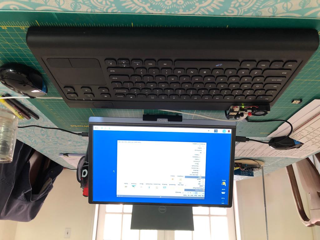

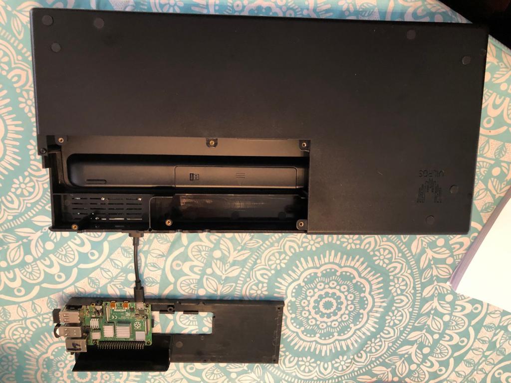

Here are two pictures of the Vilros keyboard with a Raspberry PI 4 and a fan/switch on the top. Bought it for $20 on sale. Lots of room. Switch for turning the KB on and off.

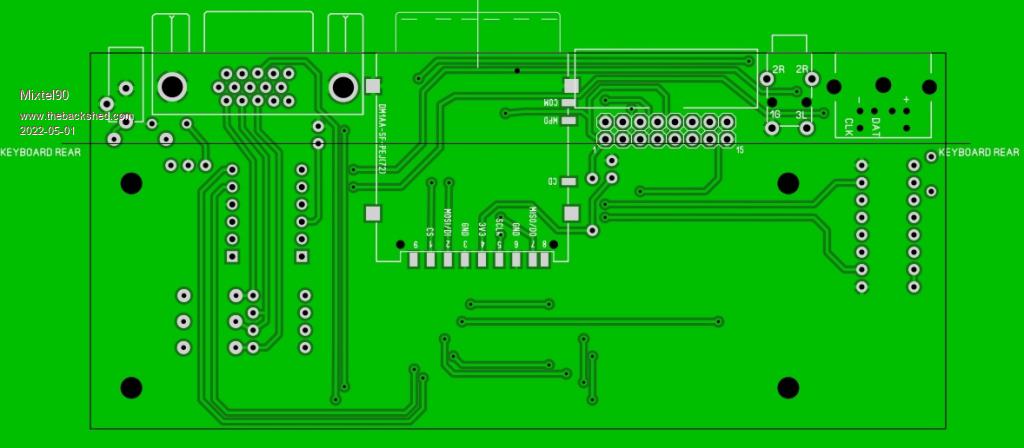

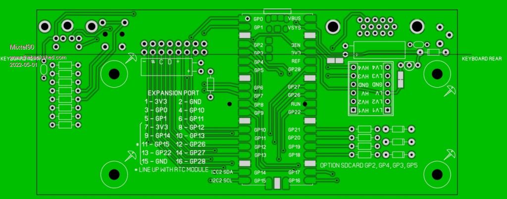

Had a go at making it more compact. Short of getting a steam iron on it I doubt if it will go much further. :) As a surface mounted Pico will be at least 1.5mm thick there's not a lot to gain by changing to SMD resistors and they are more fiddly.
The bottom (components / against the table) side:
The side that goes against the bottom of the keyboard:
The expansion port (a 2x8 rear-facing box header) will take one of the little RTC modules plugged into pins 7,9,11,13 & 15 (top row, pointing upwards). Unfortunately it covers GP22, but that's hard luck. Unplugging it gives you that back, together with GP14 and GP15. I used a box header so that a 16-way ribbon could be used.
The default is to use a MCP linear regulator, but this can be left off and solder blob links changed to enable the SMPS.
Audio output is line level only.
Unfortunately it's too big for JLCPCB's special $2 offer. :(

Posted: 07:30pm 30 Apr 2022
Mick,
Nice, sign me up for one!
Check if there is solder resist on all pico pads that are not ground.
Posts: 9265
Posted: 09:11pm 30 Apr 2022
I might change the audio filter for your 2-stage "green" curve. It doesn't need much messing about to do.
You were right about the solder resist. That would have made it fun to build. lol I've moved the pin names outside the pads too.
