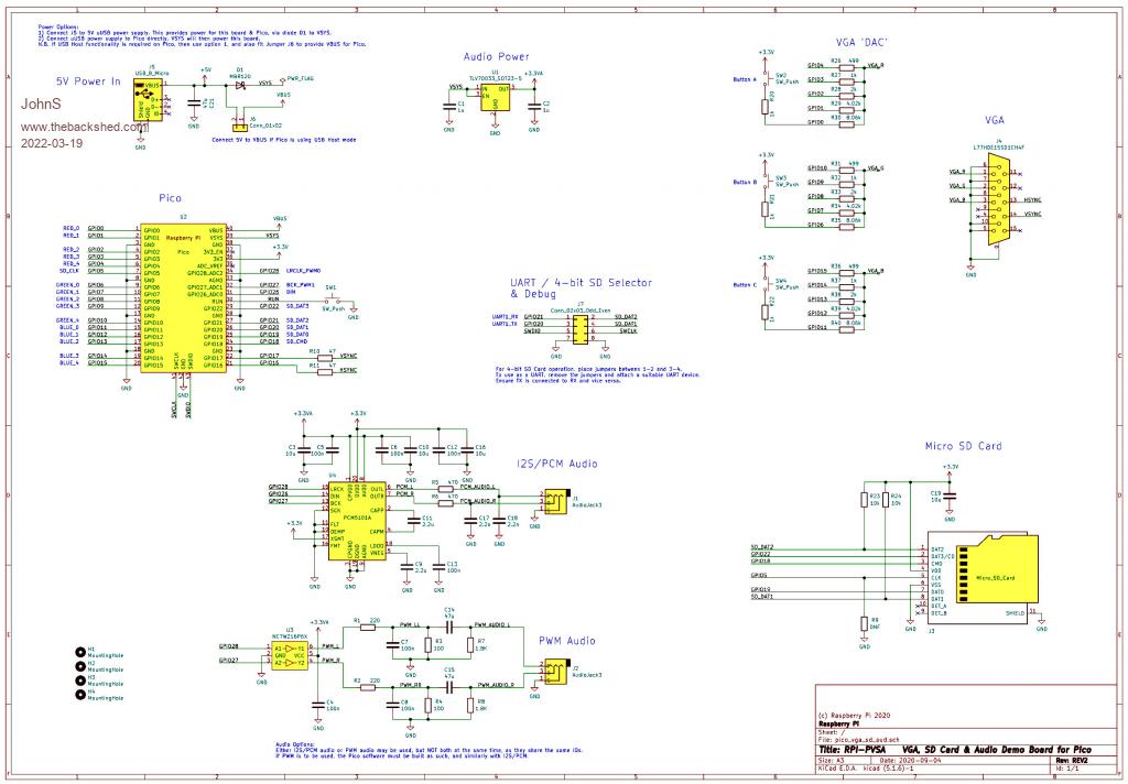

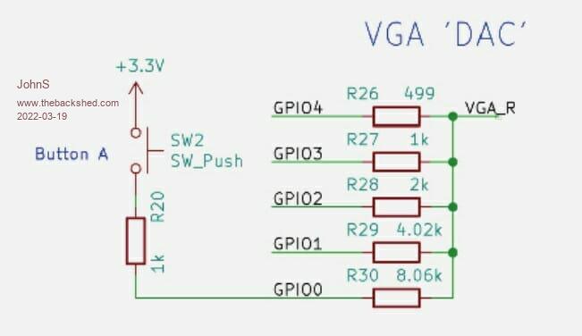

Posted: 02:42pm 18 Mar 2022
  Mixtel90 said  Ah, this I couldn't guess at. It would probably depend on both the resistor networks and the firmware. I've not looked for the circuit of the board.
By way of example:
The rest will be in the hardware design doc I hope.
Section 3.2 is VGA Video
Section 3 is the whole VGA etc board.
Edited 2022-03-19 00:45 by JohnS
Posted: 02:55pm 18 Mar 2022
Aha, here's the schematic for the board. I hope I didn't mangle it...
Edited 2022-03-19 00:55 by JohnS

The existing PicoMite VGA firmware won't run on that board no matter what you do. It's permanently set to use different pins. Even if you could change the pins used (by changing the firmware) you'd have to either drive multiple pins at the same time,as Tom suggested, or set the 11 unused ones to tristate. You've lost them anyway because they are tied to the VGA otput. The I2S audio is connected to the ADC pins so you've lost the ADC too. It's not a good general purpose board at all.
