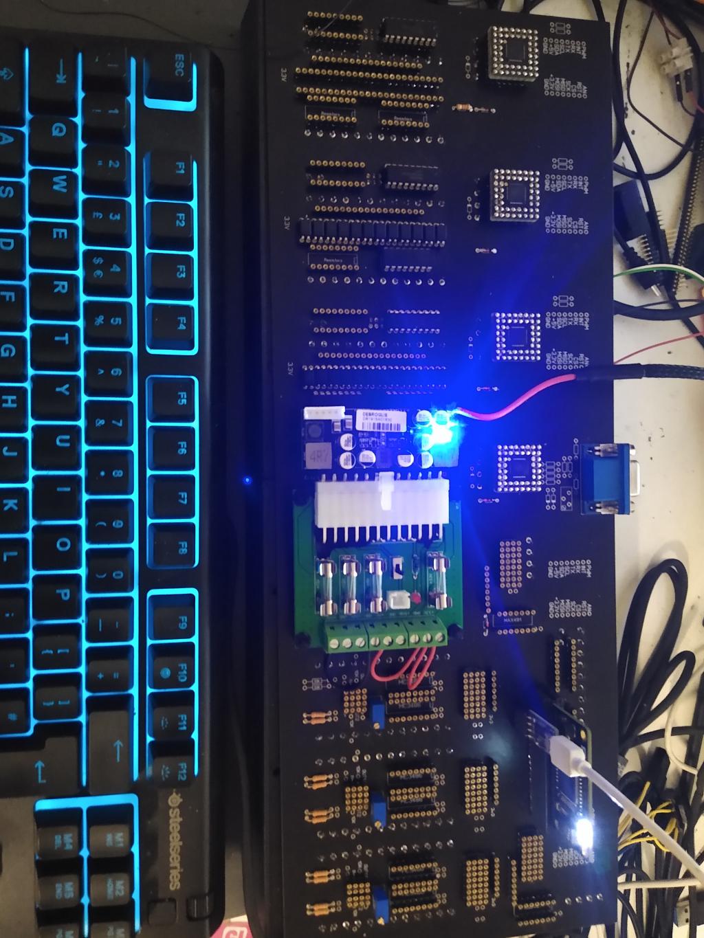

Posted: 09:06am 24 Nov 2022
It's working really well. Been hammering it for a few days now. Not a glitch
Four RP2040s talking to a Prop-2 @460K Baud:
