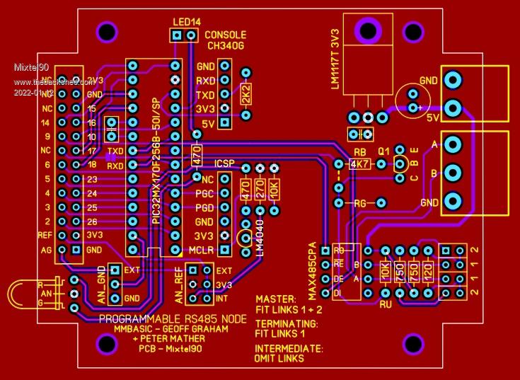

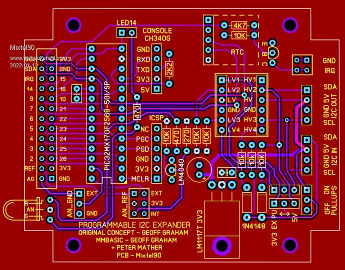

Posts: 9265
Posted: 08:02pm 11 Jan 2022
Big day. :)
Piccies and Gerbers.
Micromite I2C expander.zip
Micromite 485 node.zip
Posted: 08:52pm 11 Jan 2022

Thanks Mick, They look good
Is there any chance that you can post a rear view and circuit please. I just may have to get some.

Does the RS485 driver have RX/TX LEDs so can see activity? Not seeing any LEDs...
Also, is there any cost advantage to using discrete RS485 components as opposed to layout for a "ready to go" RS485 module?
Would like to see schematic if available.

  Quote  Does the RS485 driver have RX/TX LEDs so can see activity?
+1
  Quote  is there any cost advantage to using discrete RS485 components
I'm interested as to what you mean by 'discrete RS485 components'?

Posts: 9265
Posted: 07:58am 12 Jan 2022
Updated circuit diagrams to follow. I'm one of the naughty ones because I do the PCB first then do the schematic from that...  ;)
There are no specific TX/RX LEDs. There is a single bi-colour red/green LED. Normally red is "power on" and Green is via a link LED14 to pin 14 so it is under user control. You could remove the ground end of the resistor for the red led and connect it to a pin to put that under user control too if you so wished.
There is no RS485 module. It does use a RS484 transceiver chip, but so would a module. The I2C version uses a level shifter module, is that causing confusion?
I've no idea about how DE works either. However, I assume that, as it's inverted, it might be under hardware control as Geoff could have corrected it in firmware otherwise.

The I2C Extender is intended to be, literally, IO extension to any MMBasic platform using  I2C. That's why the modules loop through and are short range. It can also run as a stand-alone Micromite by changing the firmware.

@Mick,
I'm mainly interested in the RS485 unit. I just would like to see the schematic and both front and rear views to verify the design (no offence meant). That was part of my life in my working days. I think it suits my Slave program, or the program can be mad to suit it.
I suspect you're right about the DE pin.

The circuit of the RS485 version is pretty simple really. COM1 on the Micromite is connected directly to the MAX485 chip. Pin 7 (DE) is connected to both /RE and DE on the MAX485 via an inverting transistor as pin 7 is normally high, going low during transmit. (Thinks... I should perhaps have included a highish value resistor to turn the transistor on so that the system is in RX mode if the Micromite IO isn't initialised.)
