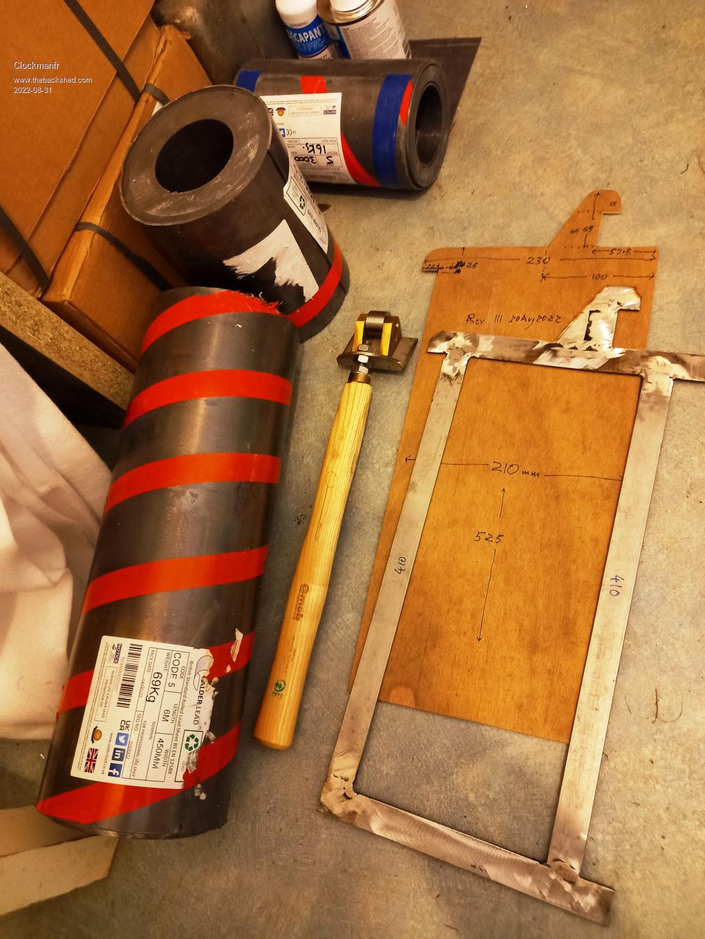

Okay chaps, moving to production stage.
There has been lots of design changes to the lead plate arrangement and testing the holding concepts, but after many revisions we are ready.

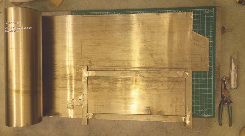

Getting at a good price 69kgs of 6m long by 440 wide pure lead, thats 24 battery lead sheets.
Each 2v battery will have 13 sheets of the identical size and fastening and connecting arrangements.
Each sheet is 535mm x 240mm x 2.24mm thick, costs about US$7.
In the photo below there is a plywood template for the lead sheets.
On top of the ply template is the stainless steel cutting frame for the cutting of the lead sheet to exact size each time,  and for a 48v battery pack i need 312 off lead sheets.
Cutting the lead is 3 passes with a sharp thin  Stanley 1992 blade, works well.
A A2 cutting self healing Matt underneath.
Still keeping the design simple but robust.

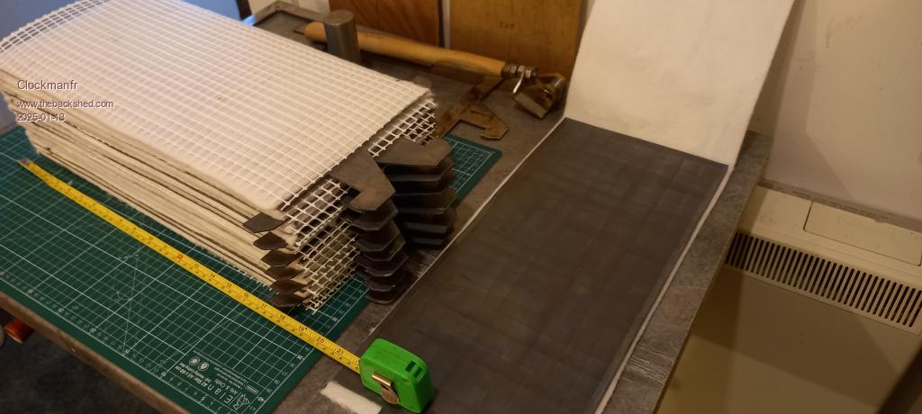

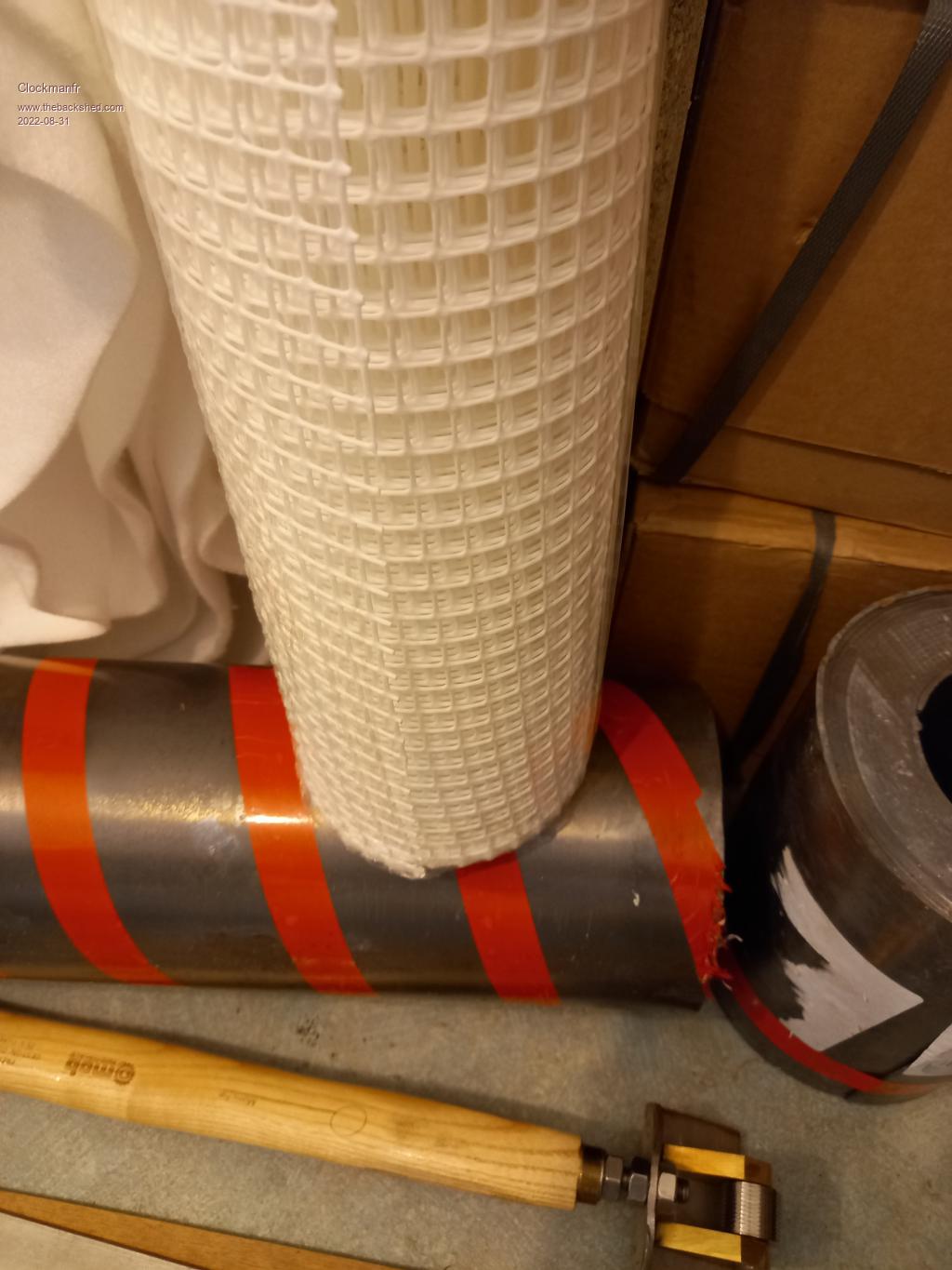

I have the  PVC for the case but these can only be manufactured to exact size once the true thickness of the plates will be found when all together, as each plate gets a polythene thick sock and a MDPE 10mm square Matt between each plate and cell. This matt has thicker joints as they cross so excellent for allowing the acid to flow around the cells.
The MDPE garden fence comes in various mesh sizes but 10mm seems a good compromise  at this stage as its stiff so will keep the plates separated yet but will allow very slight movement due to heat, discharge and charge condition and, This matt has thicker joints as they cross so excellent for allowing the acid to flow around the matt and the cells.
Should start production next week.

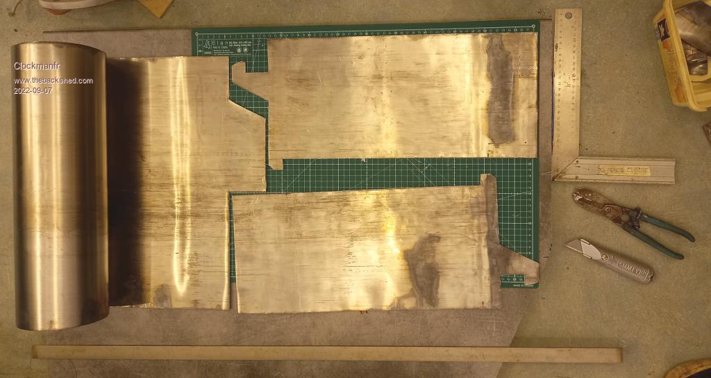

Producing the lead plates,  525mm x 220mm x 3mm thick.
98%  pure lead roll.
Just a few hundred more to cut out.
Then each will be ribbed rolled.
Then each plate gets its polythene sock.
Edited 2022-09-07 17:25 by Clockmanfr

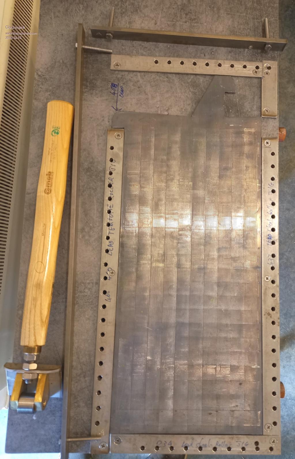

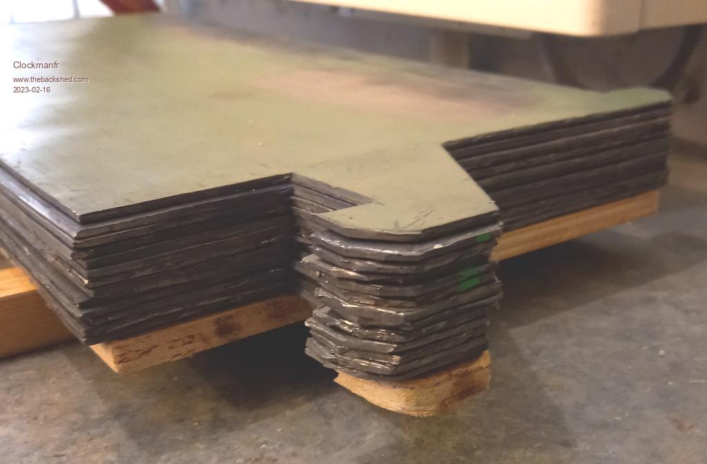

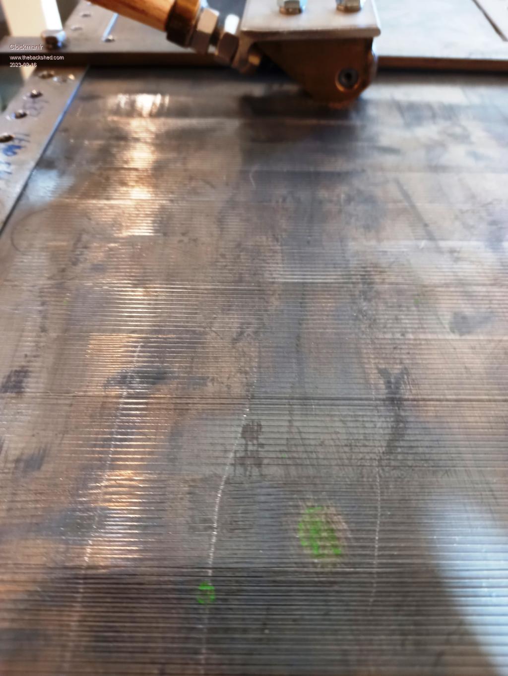

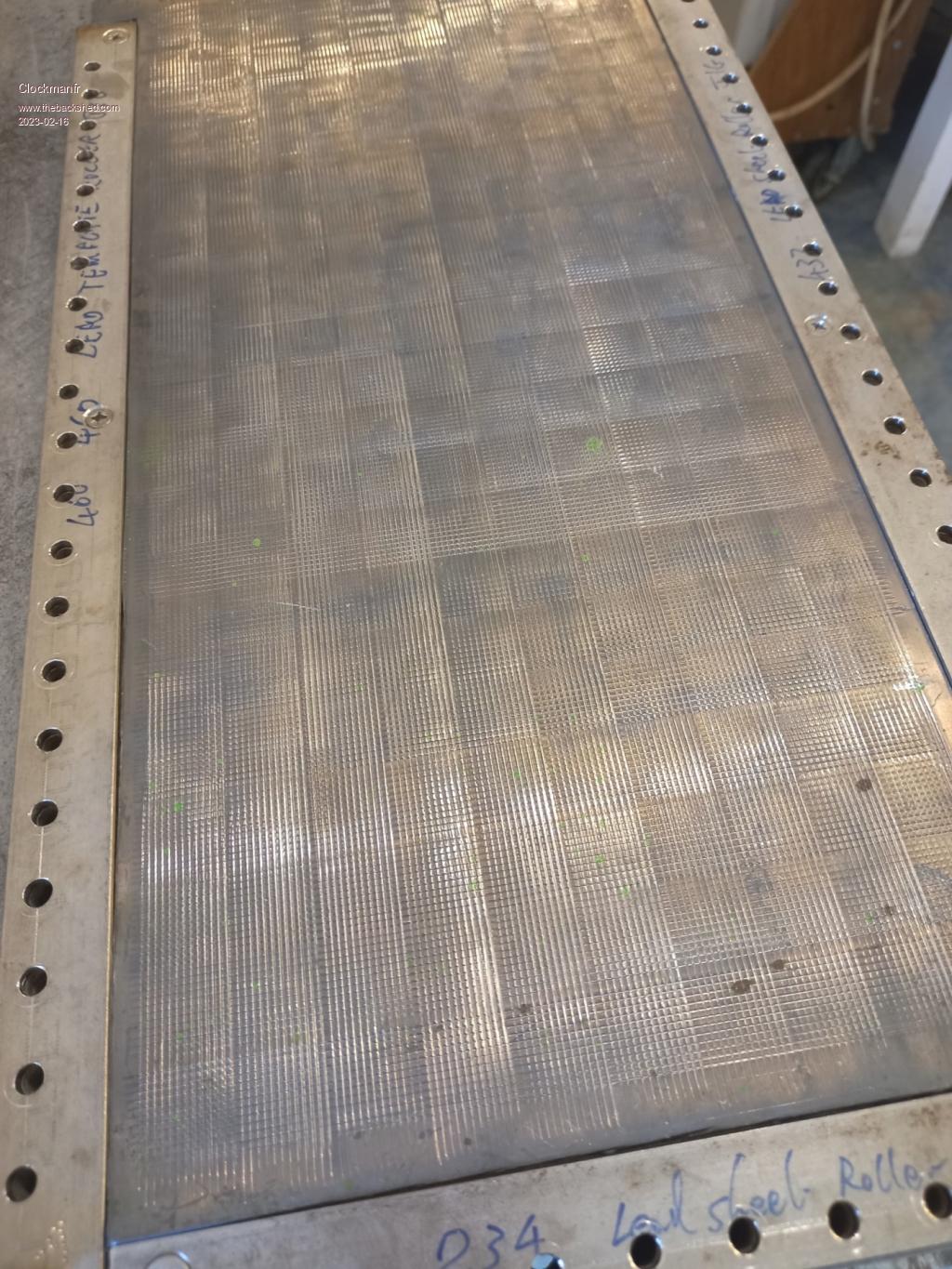

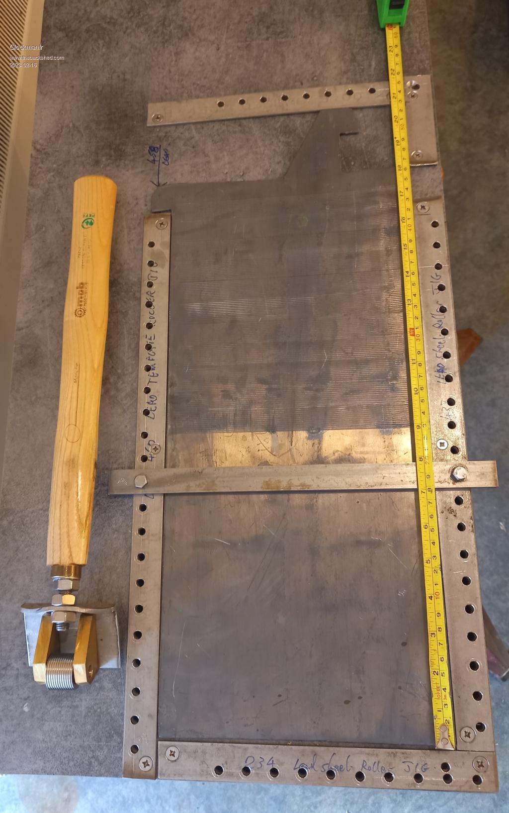

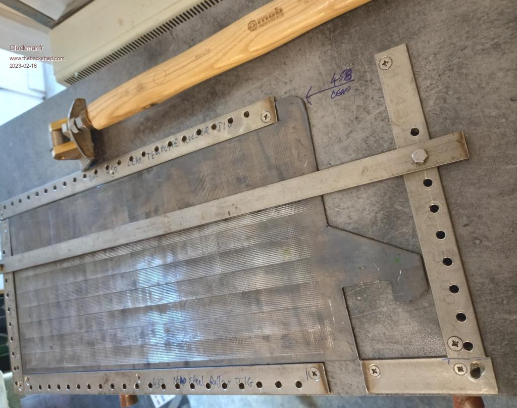

Just a few photos and updates on the Lead sheet roller JIG set up. We need consistant rolled plates and 11 sides need rolling per 2v battery.
We have 14 lead plates in each battery the photos show the Lead plate surface roller making the 0.5mm depth  grid pattern into each surface and on both sides.
I am trying to keep this process simple and can be done with simple tools by anyone, anywhere on this Planet.
Remember we want the surface of the lead to turn to lead oxide so the amperage can be good from the word go, rather than awaiting many years for the battery cell to get to 440amp to 550amp hour.
Also, as you can see with this simple modern method, we increase the surface-active area considerably by using the roller method.

The vertical rolling. And the finished side.
Whoops!,  its 12 sides for each battery that need rolling,  and not 11. ie, the two end plates that are in the battery do not need rolling as they are not interacting to form a cell.
