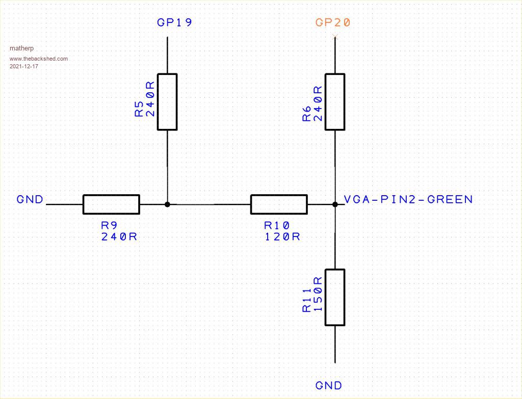

How critical are the resistor values to maintaining proper color balance? Use 1% resistors or is it acceptable to use cheaper resistors with greater variance in value?
What did you prototype with?
I'm also wondering if just simply routing R/B/G(MSB) (with resistor/diode) to VGA connector will look that bad for a simpler PCB (although since in that case we're not using the Green LSB I'm guessing the range of green will not be correct?). Also, the Green LSB will still be assigned for VGA colour use and not be able to be used for I/O?
Edited 2021-12-17 06:45 by flasherror
Posts: 3420
Posted: 09:53pm 16 Dec 2021
"How critical are the resistor values to maintaining proper color balance? Use 1% resistors or is it acceptable to use cheaper resistors with greater variance in value?
What did you prototype with?"
A) Human colour vision isn't too fussy and varies from person to person.
B) Monitors vary greatly.
Use a 220 ohm trim-pot for R10 and set it to what looks best to you on your monitor.
Posts: 12084
Posted: 10:39pm 16 Dec 2021
  Quote  Use a 220 ohm trim-pot for R10 and set it to what looks best to you on your monitor.
NO: Use a 220 ohm trim-pot for R11 and set it to what looks best to you on your monitor.

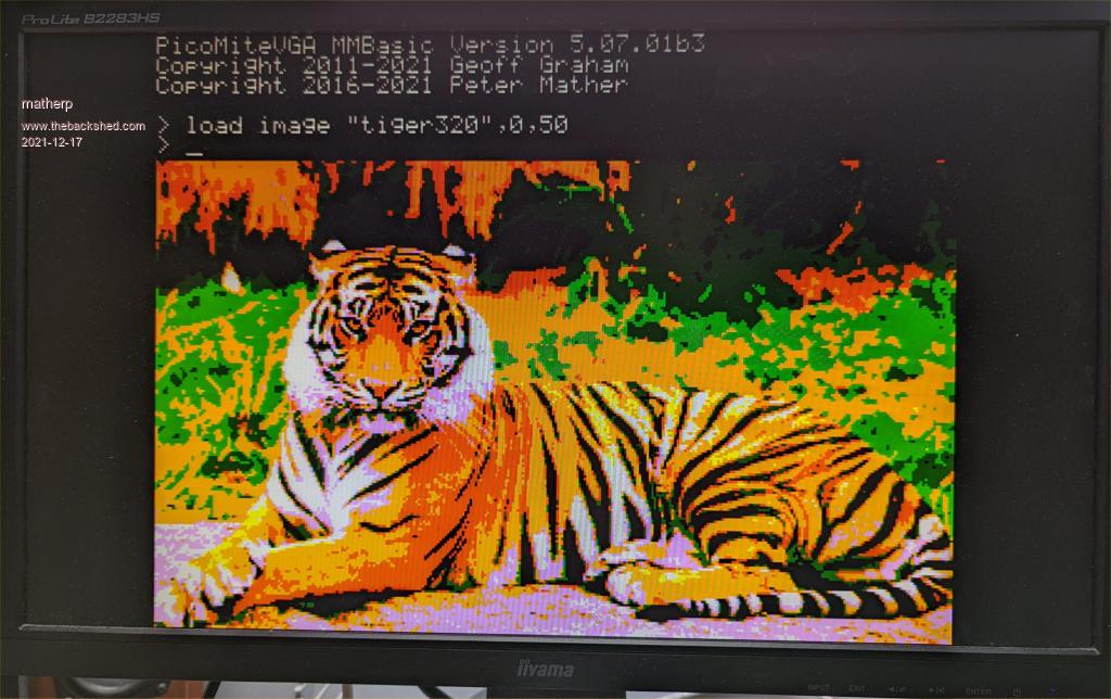

Posted: 10:53am 17 Dec 2021
PicoMiteVGAV5.07.01b3.zip
BLIT
PIXEL(
LOAD IMAGE and SAVE IMAGE now all working as per PicoMite manual.
Picture renders remarkably well considering only 16 colours available
This pretty much completes the PicoMite VGA edition with everything relevant from the normal PicoMite up and running and no obvious glitches or artifacts
As always if swapping between the PicoMite and PicoMiteVGA firmware you must clear the flash between each and it is always safest when loading new firmware as Basic tokens may have changed which will impact any stored programs
Posted: 10:59am 17 Dec 2021
impressive stuff and being on the second core it has very little effect on performance(?)
