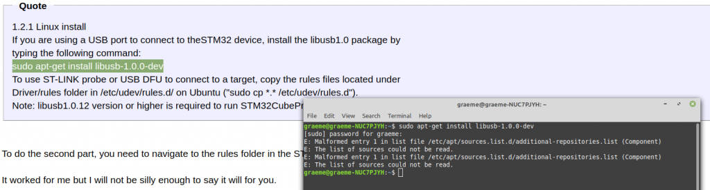

As a last resort, I did a RTFM
  Quote  1.2.1 Linux install
If you are using a USB port to connect to theSTM32 device, install the libusb1.0 package by
typing the following command:
sudo apt-get install libusb-1.0.0-dev
To use ST-LINK probe or USB DFU to connect to a target, copy the rules files located under
Driver/rules folder in /etc/udev/rules.d/ on Ubuntu ("sudo cp *.* /etc/udev/rules.d").
Note: libusb1.0.12 version or higher is required to run STM32CubeProgrammer.
To do the second part, you need to navigate to the rules folder in the STM installation first.
It worked for me but I will not be silly enough to say it will for you.

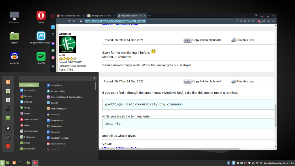

I went to try this now, and on BOTH monitors of Mint, the taskbar and "Start menu" are now invisible.  I don't know why - they were there last night.
Forced a full reboot, but now I don't have any menu bar thing at the bottom of EITHER screen as you would normally expect.  This means I cannot run anything other then what is iconized on the desktop.
That also means I cannot call up the console, as I need the menus to do that.
I've switched back to my Windoze Ten machine for now so I can post this, but does anyone know how I can restore the missing start-menu/taskbar thingy?
Once I get that back, I can try Jim suggested quote.
Posted: 06:34am 14 Dec 2021
ctrl_alt-T will open a terminal for you.
Not sure what you can do about the missing taskbar.
I still haven't worked out what flavour of Mint you are running.
The 'windows' key opens the start menu.

Posted: 06:47am 14 Dec 2021

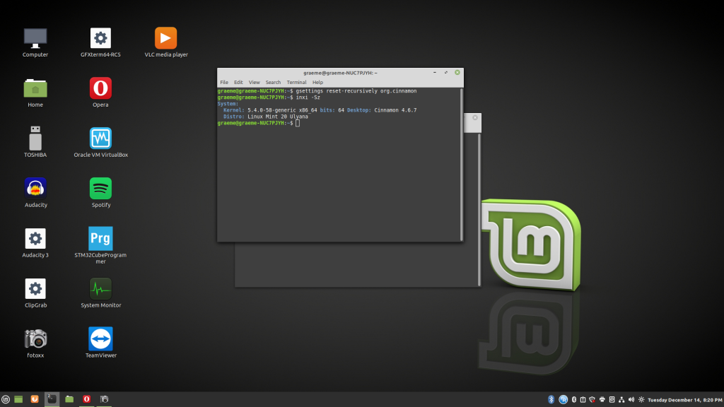

If you can't find it through the start menus (Windows key), I did find this one to run in a terminal:
gsettings reset-recursively org.cinnamon
while you are in the terminal enter:
inxi -Sz
and tell us what it gives.

Hi Jim - thanks for your persistence.
CTRL+ALT+T - this DOES open a terminal, so now I have that.
'Windows' key DOES NOT bring up 'Start menu' for me.
There is simply no effect at all.
But now I have the terminal, I can proceed.
Stay tuned.
@ Jim: Much love.
I have the taskbar/menu thing back now.
I wonder what the hell went on there? (rhetorical)

OK, results of the inxi -Sz:

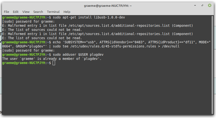

   have you done BOTH of:
echo 'SUBSYSTEM=="usb", ATTRS{idVendor}=="0483", ATTRS{idProduct}=="df11", MODE="0664", GROUP="plugdev"' | sudo tee /etc/udev/rules.d/45-stdfu-permissions.rules > /dev/null
(as a single line), AND:
sudo adduser $USER plugdev
just cut (from this message) and paste each of the lines into a command terminal. both are CASE SENSITIVE, and both will prompt for your password.
the purpose of the first line is to create a file called /etc/udev/rules.d/45-stdfu-permissions.rules containing the one line of text: SUBSYSTEM=="usb", ATTRS{idVendor}=="0483", ATTRS{idProduct}=="df11", MODE="0664", GROUP="plugdev"
this allows access to the VDI/PID 0483:df11.
rob   :-)

Posts: 10076
Posted: 11:18pm 15 Dec 2021

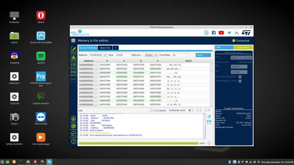

WORKING!!!!
Rob's commands made things work.
...and then - YAY!
