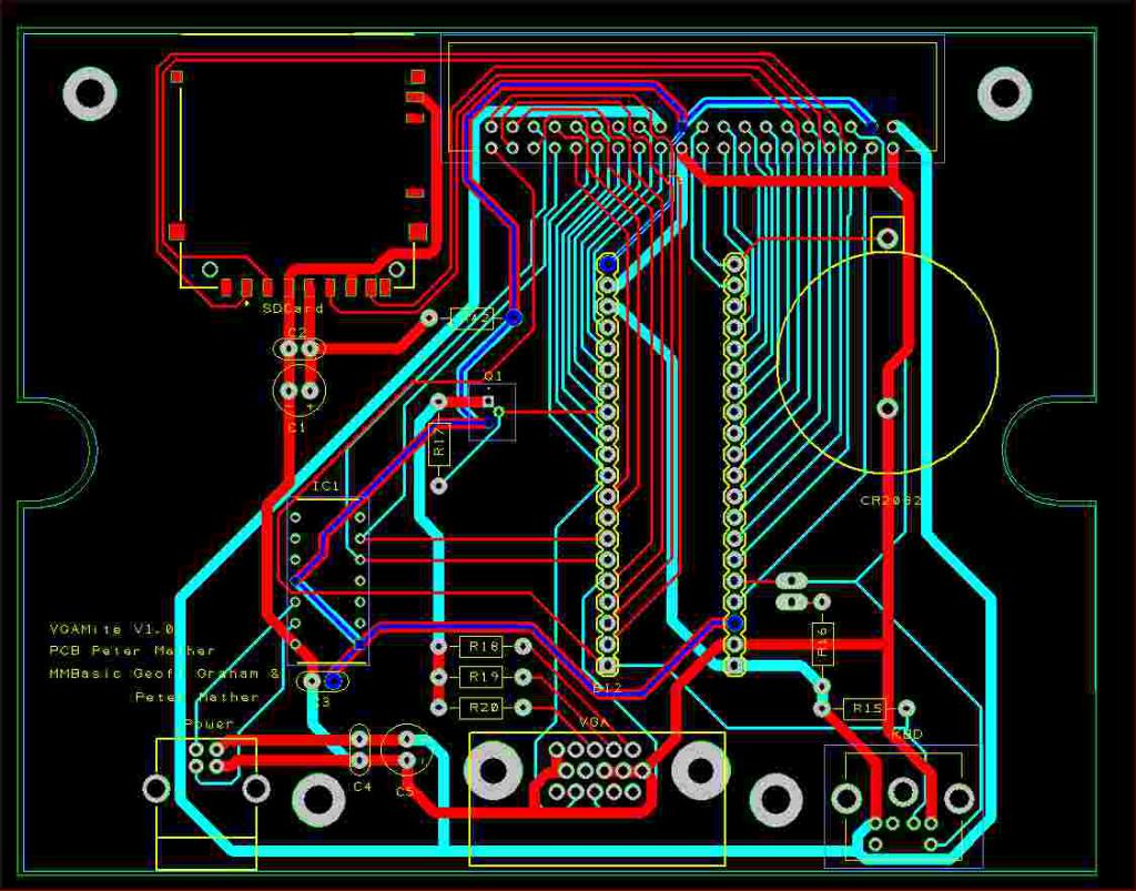

Posted: 08:58am 01 Dec 2021
Quick hack
VGAMite - Project.pdf
VGAMite V1.0.zip
VGAMite.zip
Edited 2021-12-01 22:02 by matherp

Seeing as you have already essentially done a design to fit that box matherp, and I have not even started yet, do you just want to take over at this point?
Seems silly for me to re-invent the wheel.

Posts: 3419
Posted: 12:53am 02 Dec 2021
Nice layout.
The spacing between R18, 19, 20 appears to be 0.15". Could this be changed to 0.1" or 0.2" to fit optional header sockets?
Q1 (if fitted) Vbe will affect the values of the resistors a little.
(3.3 - 0.6 - 0.6) / (0.6 / 75) = 262.5 ohms
Posted: 07:12am 02 Dec 2021
It was trivial to do because I had all the layout and components from the CMM2, only took about 90mins in total.
  Quote  The spacing between R18, 19, 20 appears to be 0.15". Could this be changed to 0.1" or 0.2" to fit optional header sockets?
Yes: I've got 5 in production at JLC, once they arrive and are proven good (or otherwise) I can make any tweaks needed and release the final versions.
Note the MCP221A/Microbridge can be left off and any USB/UART used on the edge connector pins (ROB)
Posts: 6208
Posted: 07:55am 02 Dec 2021
Hi Peter,
Some things you may want to address.
1/ The Vbat is hardwired to one of the 40 pins on the IO connector. Although completely in line with "routing out all pins to the IO header" this one may cause unintended problems, because the Vbat is 3V, even when the VGAMite is off. So safe plugging/unplugging and accidental shorts while wiring a breadboard is possible.
2/ To improve VGA quality it may be better to keep Q1 as much as possible in linear mode.  That can be achieved by connecting it's collector to +5V (not +3.3V).
3/ Order of assembly is important. Put the SD card header on first, the 0.1" pitch last.
You where fast, too fast for others here....
B.t.w. good choice to put the VGA, PS2 and USB (fixed witing) on one side, and the 40pin and SD card the other side (user access, experimenters area).
Edited 2021-12-02 17:59 by Volhout
Posted: 08:52am 02 Dec 2021
  Quote  1/ The Vbat is hardwired to one of the 40 pins on the IO connector. Although completely in line with "routing out all pins to the IO header" this one may cause unintended problems, because the Vbat is 3V, even when the VGAMite is off. So safe plugging/unplugging and accidental shorts while wiring a breadboard is possible.
I'll put a diode in the line to the edge connector. That way you can use an external battery but it won't backfeed.
  Quote  2/ To improve VGA quality it may be better to keep Q1 as much as possible in linear mode.  That can be achieved by connecting it's collector to +5V (not +3.3V).
Now you are talking that strange analogue language. Phil99: do you agree with the proposal?
  Quote  3/ Order of assembly is important. Put the SD card header on first, the 0.1" pitch last.
Yes: but the VGAMite doesn't use card detect or write protect so unlike the CMM2 it doesn't matter if you short those tiny pins to the case
  Quote  B.t.w. good choice to put the VGA, PS2 and USB (fixed witing) on one side, and the 40pin and SD card the other side (user access, experimenters area).
Thanks, that was my thinking
Edited 2021-12-02 18:53 by matherp

Posted: 10:04am 02 Dec 2021
  Quote  To improve VGA quality it may be better to keep Q1 as much as possible in linear mode.
A transistor takes a small time to come in and out of saturation - like the propagation delay of a logic gate. If it works for Phil, then whatever it is cannot be significant enough to affect the display. Connecting the collector to +5v would avoid the transistor going into saturation and reduce any delay but increase the power dissipation of the transistor.
Posts: 3419
Posted: 12:12pm 02 Dec 2021
Re Q1
Volhout and Turbo64 are correct and for a 1080 screen might make a visible difference but at 640 x 480 less so. On the ASCII terminal I used 3.3V and it is respectably sharp but using 5V instead costs nothing, unless it makes the layout difficult.
I think the output capability of this chip is sufficient to drive all three VGA pins without Q1 so those wanting the sharpest image can omit it, linking the B & E pads and using 330 ohms or more for R18 to 20, as suggested by TassyJim
Could some prototyping pads go in the empty spaces?
Posted: 01:30pm 02 Dec 2021
hi peter,
   i'd suggest placing a row of 0.1" spaced pads to the left or behind the SD socket, duplicating all the connections to the SD footprint. this way, if someone does make a hash of soldering the socket, or the socket fails and can't be easily removed without damage, the user has the option of wiring up an SD socket on a breakout board.
also, the pads for Q1: the corner of the square pad is uncomfortably close to the base pad. consider making all three pads round, and spacing them out more to make soldering easier. no reason you can't have 0.2" between pads - transistors have plenty long enough leads to reach
and you have a near-circular 5v(?) track around the perimeter of the board. consider removing the segment that runs clockwise from just to the left of the VGA connector, under the power/USB socket, and between the SD socket and 40-pin connector. the location it runs to (on the 40-pin connector) can instead pick up 5v from the top-right pin on the 40-pin connector that is connected to 5v from the other direction.
rob   :-)

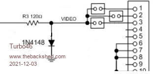

One final comment on the VGA output if I may:
In Silicon Chip magazine April 2013 circuit notebook section a reader described a colour output for the original Mono Maximite. It took the white output from the Maximite and used a rotary switch and one SPST switch to select one of six colours plus white. Blue, Green, Cyan, Red, Purple, Yellow and White.
I don't know if it's OK to show a copy of the circuit, so I wont.
The colours were selected by connecting the white output from the Maximite selectively to the three Red, Green and Blue inputs of the monitor.
Blue: Blue
Green: Green
Cyan: Green + Blue
Red: Red
Purple: Red + Blue
Yellow: Red + Green
White: Red + Green + Blue
I'm not sure how useful some of those colours are but this could easily be achieved with the circuit I proposed above, it is a simple and proven circuit from the original Maximite.
No Amber I'm afraid but that could be achieved with a suitable resistor replacing the link for the Green colour.
I'm not in a position to try that right now but if someone with a Blackpill can I'd appreciate their comments

For colour selection, a quad AND (ex: 74xx08) or NAND (ex: 74xx00) could be useful. VGA out goes to one side of each gate, other side goes high or low to set colour. Fourth gate could be used for intensity. Things get interesting when the selection lines instead are connected to I/O pins. Then a running program can control its own colour output. If the running program can sync to the VGA interrupts, colour control becomes possible, to some degree, on a line by line basis.

@Turbo46
Each colour input of the monitor has a 75R resistor to ground. That means that to drive the monitor to full white you need to think of the inputs as being a single 25R resistor. At 0.7V (full drive) you need 28mA into 25R. The Micromite could just about manage that, but the BP can probably only manage about 12mA max on a single pin. That's why the emitter follower circuit is a good way to go - the output pin only supplies a very low current.
This is my attempt to explain why a single pin direct drive is "a bad thing". :)
Because of the 120R resistor in your circuit you will only reach about 0.57v into 25R even if the pin can supply 23mA, so you won't get anywhere near full white (probably around half brightness at best). With 2 colour channels driven (e.g. green+blue to get cyan) the output is almost bang on 0.7v into 37.5R if the pin can supply 20mA, it might be a lot dimmer than this. With a single channel driven the output would be 1.27v into 75R with 17mA from the pin. The diode will clip it, but the output current from the pin will probably sag the voltage anyway. Basically, direct drive from a single pin only works anywhere near properly with a single colour channel driven. (I hope I've done my sums right - please forgive me if I've screwed up too much!)

Mono Maximite
Not my circuit. I have done the maths. You You can tell Geoff the Mono Maximite won't work although mine does. Go figure.
