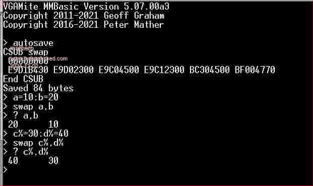

Since he has expressed an interest in the VGAmite you could use one of them to add that SWAP command that the Captain is so keen on, it looks like GW-BASIC had it so there is precedent.

good call on SWAP otherwise moving to the marmite ( ) I would be going back to sq1 coz the CSUB wouldn't work - might be a spectacular crash to try tho'

CSUBs will be available soon so no need for swap. You can write to the display while VGA off. It just turns off the timers that generate the output. SPI READ is available in all MMBasic variants but it reads to an integer array. Not going to special case this as it will just make the VGAMite incompatible

Posts: 12084
Posted: 05:37pm 01 Dec 2021
411VGAV5.07.00a3.zip
CSUB swap
00000000
E9D1B430 E9D02300 E9C04500 E9C12300 BC304500 BF004770
End CSUB
Also you can now use the command UPDATE FIRMWARE to put the processor into bootloader mode. I then updated the firmware over the serial console - worked very nicely. This will allow the "boxed" VGAMite to be updated
