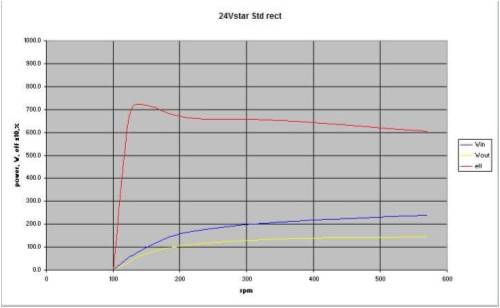

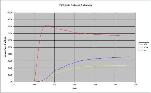

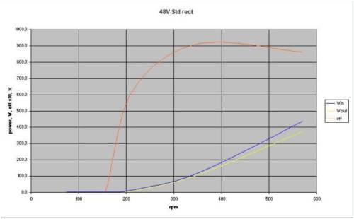

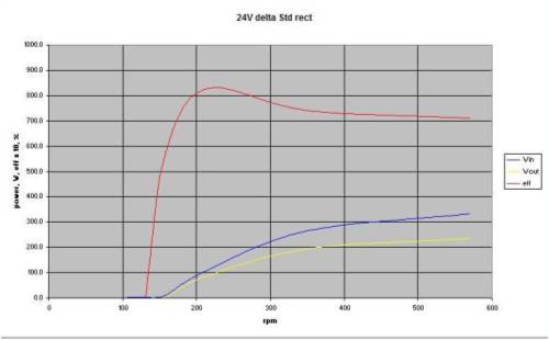

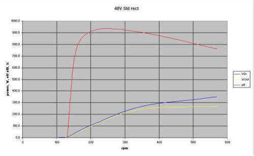

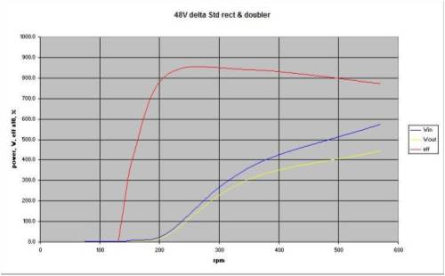

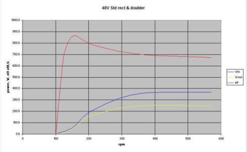

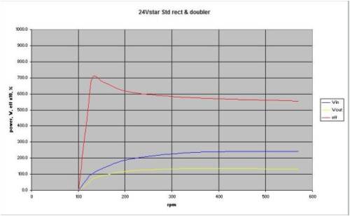

Phill has asked me to publish the first set of graphs. This will give some idea of typical 80SP rewire outputs into 24V & 48V systems with star and delta configurations with and without a capacitor doubler. and what can be achieved with a dual combination as Phill is planning to configure.
This is the first of a series of testing. These are not laboratory std results, but all measurements were done on the same day, in the same sequence, with the same instruments and the capacitors used in the doubler were 50uF non polarised type of > 400VAC ratings.
The graphs are annotated and should not require explanations.
These graphs only test one value of capacitance so far, for a doubler combination only, in parallel with existing rectifiers.
24V Star
24V delta
48V star
48V delta

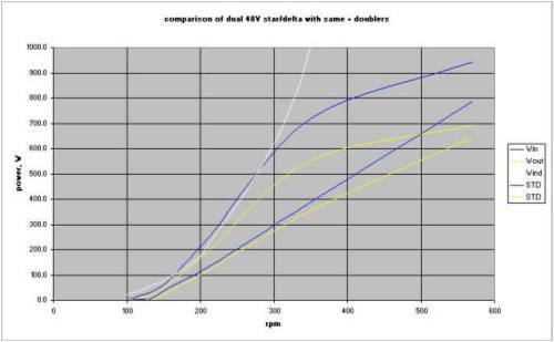

48V dual, star and delta
This last graph shows 2 sets of data.
The lower sets, straighter lines are for a usual dual
with a star and a delta configuration. the upper set
that closely follows the white line [approx cubic wind
energy curve] are for the same configuration with
capacitor doublers across each stator as well.

Thanks Gordon for doing all the graphs and calcs with the data I collected , I will rase one concern I have that we talked about and that is the Open circuit voltage hith the Caps and doubler , as I took readings every step the higest it hit was 392VDC at 500+ Rpm and the "Stored Energy" in the Caps when discharged was a very scarry spark!!!
BE CAREFULL IF YOU ARE GOING TO USE CAPACITORS!!!!
And the should not be left open at the bottom of a windgen tower for some one to come in contact with ..
As you can see from the last graph my Quad Stator is going to be shelved and I will be going back to a dual and using Caps & Doubler ..

Gordon, Phill, great work there!
However I must confess to be rather dumb, could you please explain what the red, blue, and yellow traces represent? I cant make out what the little box says on my display.
herbnz
Joined: 18/02/2007
Posts: 258
Posted: 07:44pm 02 Jan 2009
Gordon Phill Many thanks for your efforts
John I blew the images up and you can read them.
Red eff
yellow Wo
Blue Win
Many questions I would like to ask but as At this time I am a armchair observer I will keep brief
To change from 24 to 48 volts were you changing the batteries or was there another form of load ?
Would it be possible to show the cct actually used of the doubler there has been a few versions publised ?
HerbEdited by herbnz 2009-01-04

the load for 24V, was a 2 x 12V @ 200Ahr [approx] Pb-acid batteries in series. The 48V was a commercial 48-24V DC-DC converter, as used in trucks etc, connected to the same battery. The battery voltage was maintained at close to 26V with an inverter and loading.

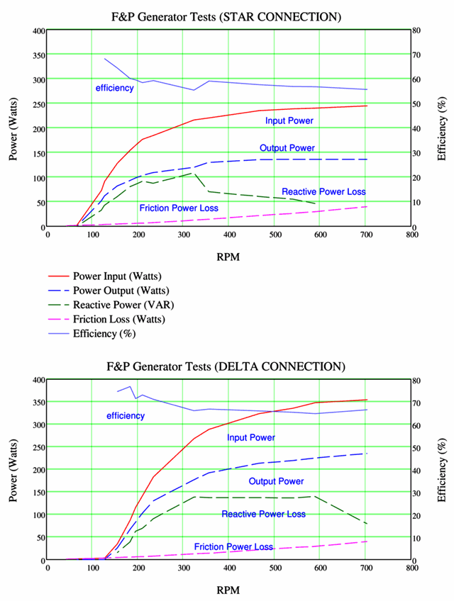

Posted: 05:19am 03 Jan 2009
Thank you Gordon for the extra info. Now I have been able to break the data down (in my own quirky way), and there's something I'd like to put in, now:
Because a lot of information was provided, I was able to make an analysis of all of the power inputs and outputs.
I started with the mechanical power. The force on the lever, times its length gives torque. Torque times rotational speed gives power. For example:
At 357 RPM, the Star input force 710 grams x g = 6.96N
The arm is 0.846 meter, thus Torque= 7.0 N*0.846 m=5.9 Nm
When turning at 357RPM, or 37.4 rev/sec
P_in= 5.9 * 37.4 = 220 Watts
The same is repeated with the 45 grams to find the power lost to friction and magnetic hysteresis in the iron.
P_iron = 14 Watts
The output power is pretty easy: 52 V * 2.5 A
P_out = 130 Watts
Knowing the phase resistance of the stator (in Star) is 6.0 Ohms, then the loss to copper resistance is:
2.5A * 2.5A * 6 Ohm * 1.73 (the square root of 3=1.73)
P_copper = 65 Watts
So if it takes 220 Watts to turn the generator, presumably those 220 Watts must go somewhere, do something...
14W + 130W + 65W = 209W Where is the missing 11W?
A little bit of power may be lost in the rectifier...
1.5V * 2.5A = 4W
...and there's certainly some margin for error in the data, but the shortfall is consistent through all data points.
I believe it is lost to "reactive power". Since everyone has been talking about inductance in these F&P's, then it would be a certain amount of reactance that is being counter-acted by the capacitors.
Analysing AC circuits with out-of-phase power is a little tricky. I'll try it with a small diagram, but you would be best to look it up on a reference like "All About Circuits", where there is a lot of good explanation.
_
Using trig, any side of a triangle can be found if you know the other two. Reactive power is 90 degrees to the real power component. A mechanical system, on the other hand, is loaded by the "vector sum" of the components. Usually that's done with the "sum of the square of the sides" approach, and it will work here.
The hypotenuse is the mechanical power input (220W)
The long side is the sum of the known power demands (209W)
The third side is sqrt(220^2 - 209^2) = 69W
I have graphed out the reactive power along with the other data for the Star and Delta tests. I don't have the data for the capacitor corrected tests.
Ultimately, if there is going to be any "science" to sizing the capacitors, a power analysis like this one can be done to find the amount of reactive power to be counteracted by the capacitors. More tests will help demonstrate that empirically.

BTW: I have a problem with the delta graph. If you add the power output to the reactive loss and the friction loss, then this is greater than the power input at the 300W and 400W input power level.
also
should be 37.4 rad/secEdited by GWatPE 2009-01-04
Steven Reactive power is VArs not watts it is Vars do not require input power so have no bearing on the watts in.
They are refered to as wattless power.
Nothing in the info supplied indicates that there is or is not VARS present you are assuming input is apparent power its true power.
