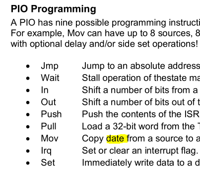

Drat! Data might be better than trying to use a PIO as a time machine.
Geoff?

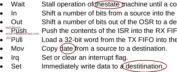

Couple more in same paragraph (area) of text

Posts: 3370
Posted: 01:11am 10 Nov 2021
Thanks.  The next release will have these fixed.
