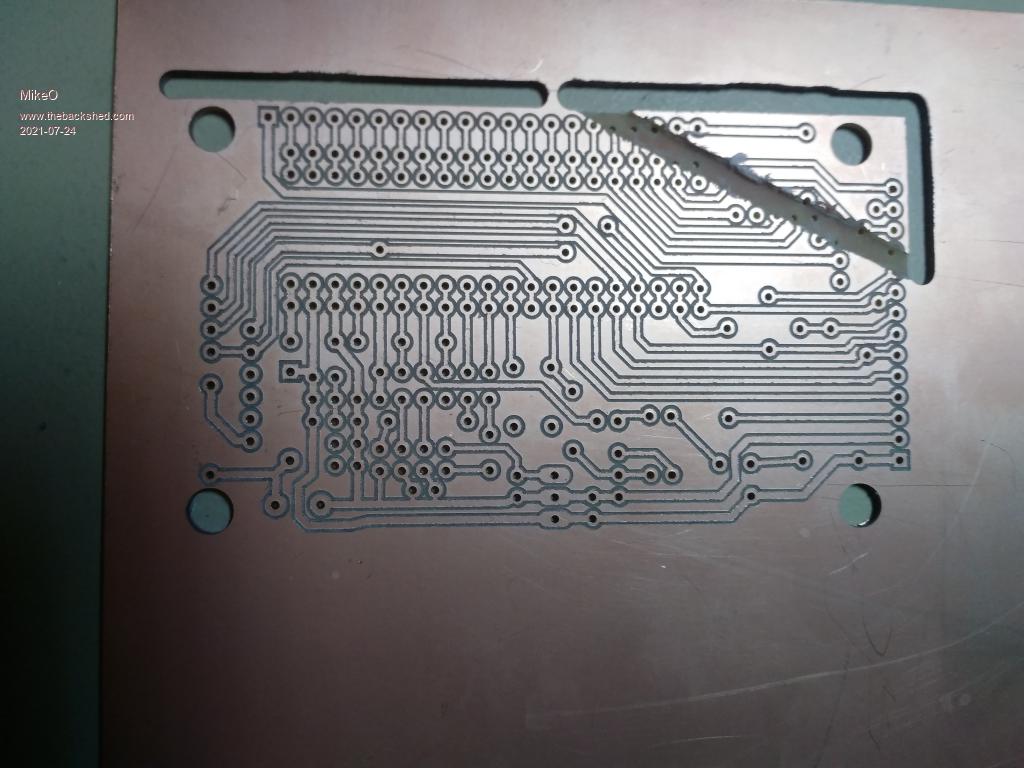

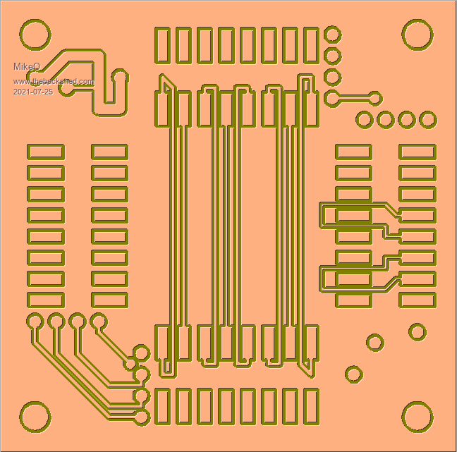

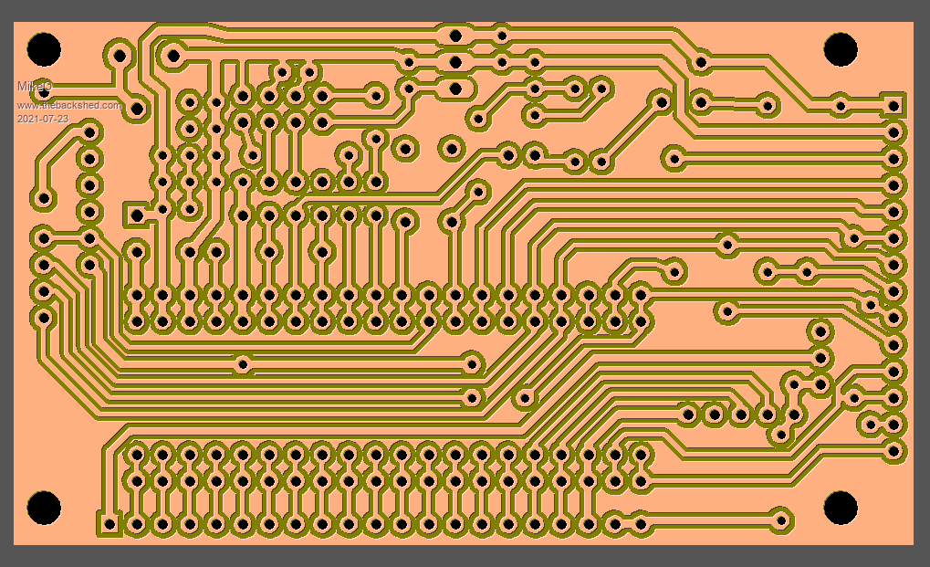

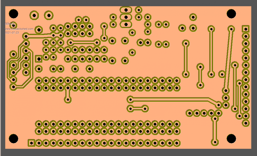

Going to try isolation milling version of this board today.
I have used CopperCam to process the gerbers into nc files ready for milling on the cnc.
I have attached images of the copper representations (good for spotting problem areas)
I will post the result when done. Thanks to Mixtel90 and Vegipete for their work. Mike

Although never originally intended to be milled, it looks like a pretty good design for it. :)
Please let us know how you get on.

Looks neat in virtually milled copper. Should be easy enough to deal with non-plated through holes.

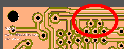

I notice a 'milling error' near the bottom right of the (mirrored) bottom layer:

Posted: 03:00am 24 Jul 2021
Hey your right, thanks I will look at that.

@mikeO,

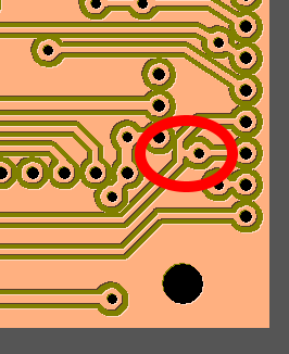

Check your milling, the IO0 and IO1 on the ESP8266 are shorted to the nearby trace.

  Volhout said  IO0 and IO1 on the ESP8266 are shorted to the nearby trace.
Well spotted, I didn't see 'em. Those would be a short to ground.

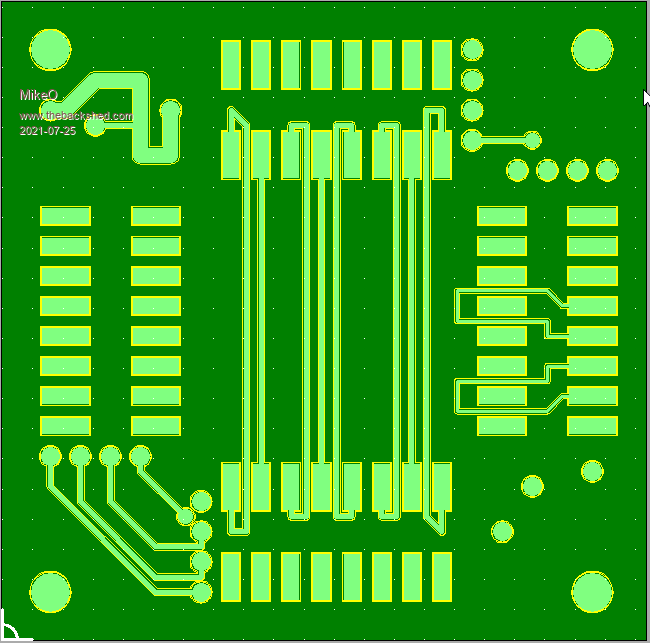

Yes I spotted that myself this morning, then I saw your post. Actually I was able to manipulate the relevant track width and the adjacent pads a little in CopperCam to deal with the transgression!
I have been using this PicoMite backpack board as an exercise in PCB milling.
Actually I am impressed with this latest version of CopperCam, I have had a licence for it for years and its fair to say I had not found it very successful but there has been regular updates to it and now it is working pretty well and consistently.
I have made a several isolation milled PCBs previously but they had created from scratch with Diptrace for design routing (using design rules and template optimised for milling) and export to gerbers but in the case of this board as I only had access to the gerbers I could not optimise in Diptrace but non the less CopperCam has done a good job.
I have also found that using the registration holes (0.6mm drills) feature in the software not for  mechanical location via pegs but rather using the camera on my mill to locate XY for each side. This method has given me a simple and effective double sided board alignment.
Today I will try a new run incorporating all these things I have learned , let you know  how I go.

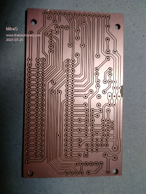

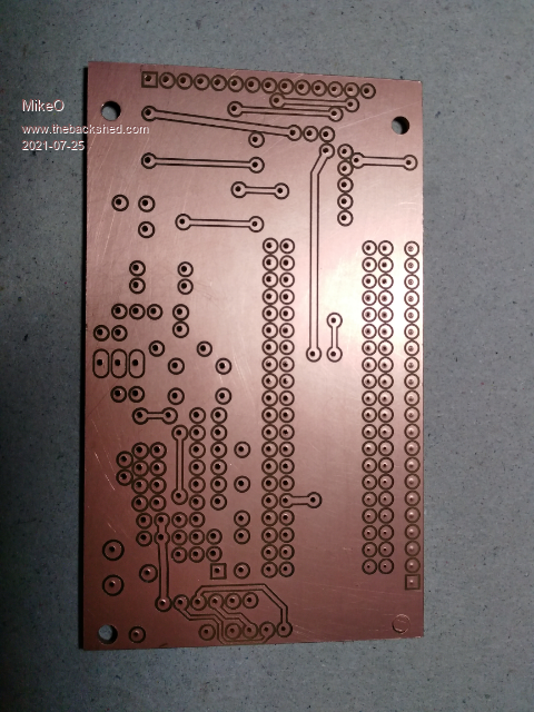

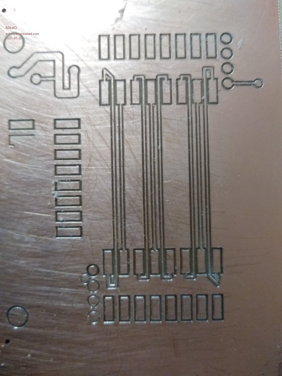

Here is the finished PCB, it has turned out really well so I am very happy with the effort put in and confident I have put some consistency into my process.
Thanks again to Mick and Vegipete for the design and Gerbers. Just have to populate and test it tomorrow. Mike
PS the small damaged portion on the first board (RHS) is just where the hold-down tab was and I was not careful enough when removing the board from the jig.

Wow... that's some neat and very precise milling :)

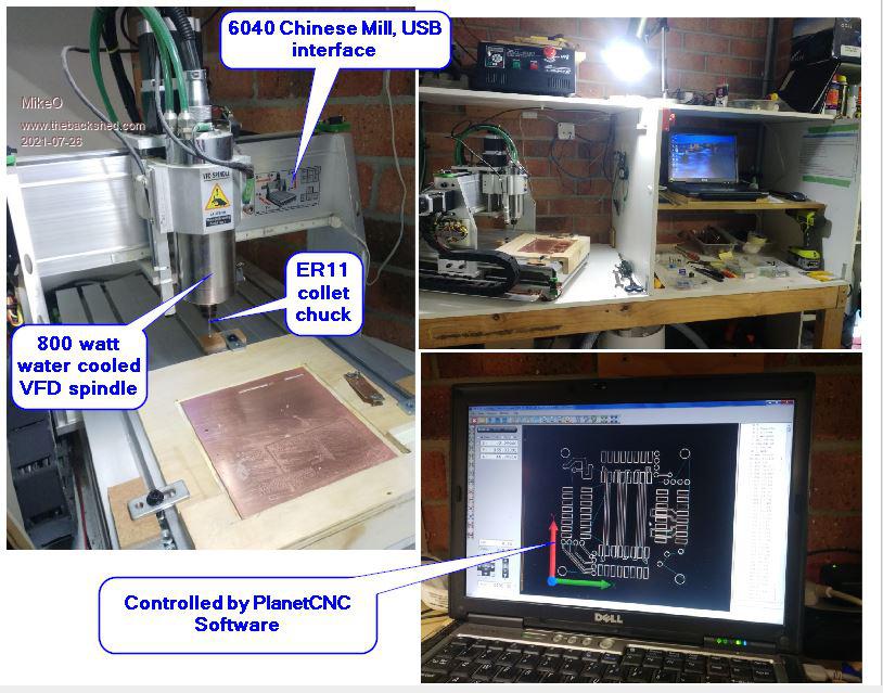

      Sorry I did not intend to hijack this thread but a couple of you have mentioned they would be keen to hear of my experiences I can share, so here goes.
      My Milling system which I have had several years was not particularly cheap but I paid more to ensure I got a unit with a heavier construction like 20mm support shafts and helical drive rods. The original unit had a parallel interface which has since been updated to USB. Apart from PCB milling I have produced items in wood and plastic (mostly acrylic and HDPE), I have done very little metal milling work with this mill.
      I have had mixed success previously milling PCBs , I could usually get reasonable milling results as long as I stuck to the things I knew to work and took no short cuts. the biggest problem area I had was having a simple and reliable method to deal with double sided board alignment. With this last board I did I was determined to try and solve this dilemma. I will get to the seemingly simple solution in a moment but first I will just list the hardware and software tools I use.
      1. Chinese 6040 mill, PlanetCNC (Lic) USB controller and software.
      2. General cad work I use CamBam (Lic). Use this for board cutout when doing PCBs.
      3. PCB design I use DipTrace (free), I am use to this product, works for me.
      4. PCB Gcode I use CopperCam (Lic), I can also export gerbers directly from Diptrace into PlanetCNC but the CopperCam gives a lot more flexibility including  origin alignment options. FlatCam would be the other contender (free) I have tried some time ago, always seemed complicated but the most recent looks more streamlined.

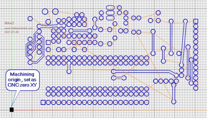

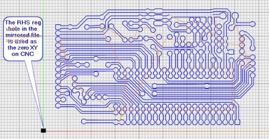

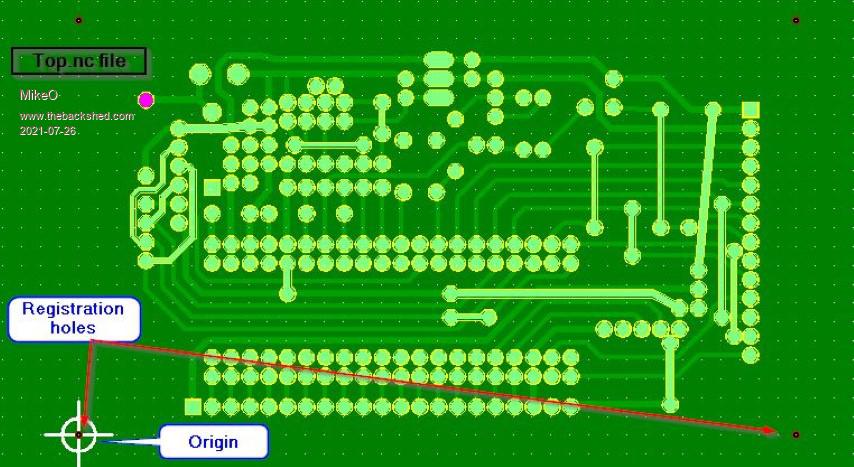

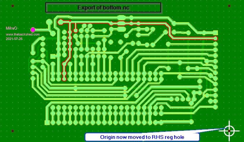

      This time I wanted to try and address the double sided alignment issue. I came across a jig where you milled a xy straight edge on a base board that was reliably located by the addition wood strip against the tables front edge. This meant in future the jig could be reliably remounted with a milled xy edge for the pcb blank to locate on.
      Secondly instead of using the usual registration method of pins through the pcb into the base board to allow the board to be turned over and located again I used 0.6mm drilled holes at the bottom of the pcb. These can be created in CopperCam in my case other wise they would have to be created by the pcb design software as they need to be registered as machining origins in the gerbers.
These photos show the process.
      Create the Top and Bottom nc files using the left and right reg hole as origins respectively.
      On the CNC with the Top.nc you use the zero XY as set. Then when you flip the board over you need to align the zero XY to the LH reg hole (actually the RHS reg hole in the bottom.nc file)
