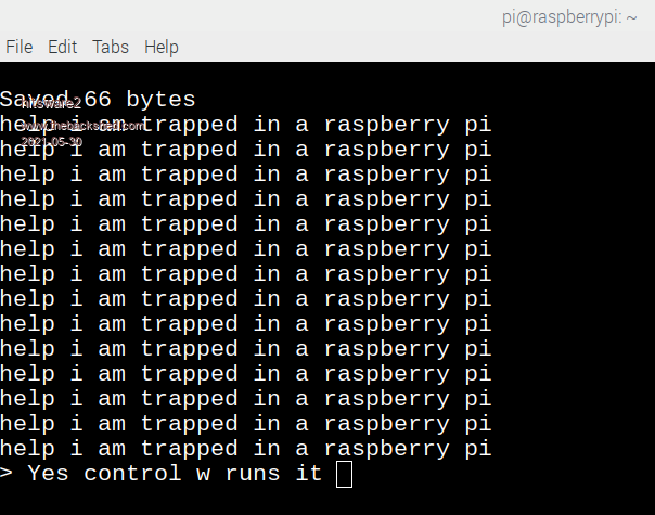

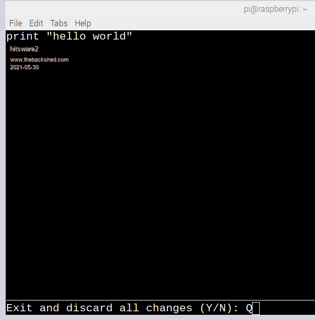

Posted: 06:36pm 29 May 2021
I get the editor screen ,
but when I try to RUN ....

Posted: 07:43pm 29 May 2021
  hitsware2 said  I get the editor screen ,
<IMAGE>
yep, i got that with minicom, but not with GFXterm64. looks like you may need to use the alternative control codes from the micromite manual, pg32:
f1:         ctrl-Q
f2:         ctrl-W
f3:         ctrl-R
f4:         ctrl-T
f5:         ctrl-Y
shift f3:   ctrl-G
it seems to be a shortfalling of minicom, and no doubt some other linux terminals.

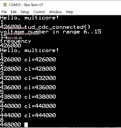

Plasmamac
Joined: 31/01/2019
Posts: 620
Posted: 08:53pm 29 May 2021
just curiousity :
multicore_hang.zip
rpi forum
Plasma

hitsware2
Joined: 03/08/2019
Posts: 738
Posted: 11:33pm 29 May 2021
f1:         ctrl-Q
f2:         ctrl-W
f3:         ctrl-R
f4:         ctrl-T
f5:         ctrl-Y
shift f3:   ctrl-G
rob   :-)
Thank You   .... ctrl-W runs it ....
Strange ( to me ) that You would blame Linux terminals , rather than the code ?
Edited 2021-05-30 09:34 by hitsware2

Posted: 05:02am 30 May 2021
  hitsware2 said
  robert.rozee said  yep, i got that with minicom, but not with GFXterm64. looks like you may need to use the alternative control codes from the micromite manual, pg32:
f1:         ctrl-Q
f2:         ctrl-W
f3:         ctrl-R
f4:         ctrl-T
f5:         ctrl-Y
shift f3:   ctrl-G
rob   :-)
it is just that minicom is strictly emulating a VT102 terminal, and as such does not have function keys that the mmbasic editor fully understands. you'll also find that while <pg up> and <pg down> keys work correctly with the mmbasic editor, <home> and <end> do not.
colour and function keys are - out of necessity - a bit of a mish-mash. to get a full set of function keys we need to use VT200 key mapping, while colour requites VT300 escape sequences. most terminal emulators recognize a portion of VT100 sequences (not all), along with a few VT102 specific sequences that are particularly useful.
most folks just lump the above together under 'VT100 emulation', which kind of makes sense since there are probably only a handful of real/physical VT1xx series terminals still in existence.
