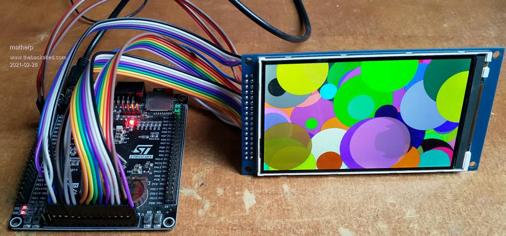

here is my dev board with the OTM8009A_16 connected. There is something odd about my display. Although it has the XPT2046 touch chip installed the screen itself doesn't have the resistive touch overlay. You can see that the normal 4-pin ribbon from the screen is missing. You should try and avoid this version if purchasing one of these if you need touch

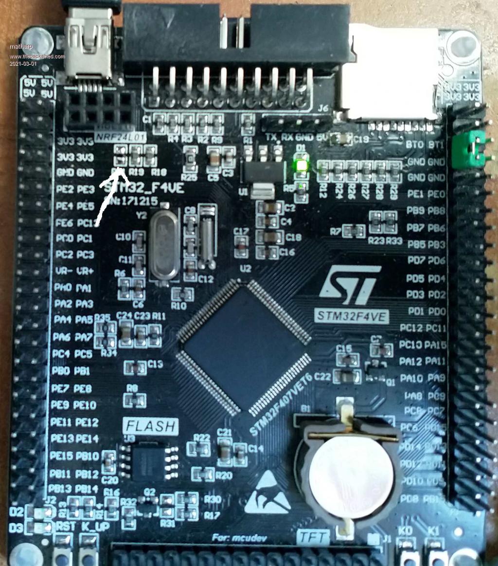

  matherp said  There is something odd about my display. Although it has the XPT2046 touch chip installed the screen itself doesn't have the resistive touch overlay. You can see that the normal 4-pin ribbon from the screen is missing. You should try and avoid this version if purchasing one of these if you need touch
I got the same surprize on the most recent ILI9341 ISP board I received. No touch screen, but the controller is soldered. They just didn't put the resistive foil on the glass.

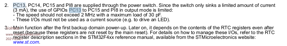

Please note that PC13 is a special pin, together with PC14 and PC15 it has is't own low power domain (32kHz clock). It has limitted drive capabilities.
Maybe we should mark this in the manual. That PC13 should be avoided if possible.
Note that in power down mode, PC13 could even supply voltage, since it is in the RTC domain, and is not reset. So put the line high, and you should have a 3V battery output.
Edited 2021-03-01 04:23 by Volhout

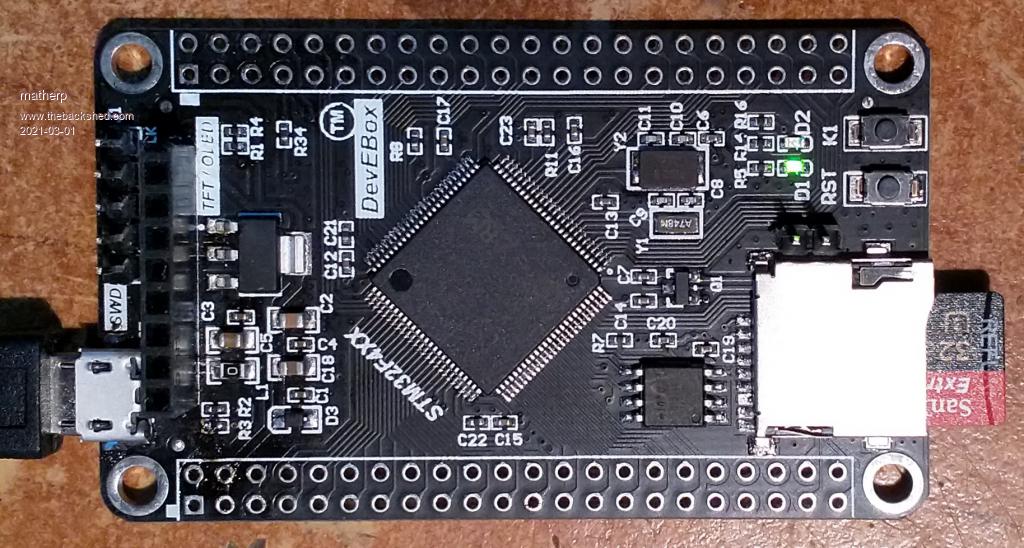

Attached is b5
ArmmiteF407.zip
This implements pin(iref), pin(sref), pin(temp) and blocks pin(0). Thought these were in a previous release but apparently not based on comments above
It also fixes CPU SLEEP [n] when using a USB console but to make this work you need to remove R21
otherwise this pullup resistor keeps the USB link active so the processor can't sleep.
Related to this I've made changes to the USB initialisation so the firmware works much better on the mini STM32F407 board which doesn't have the pullup resistor
