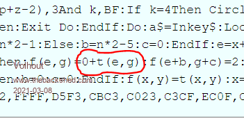

The only change I had to make to the program to run it on a CMM2 was add
OPTION LEGACY ON
to the beginning and change variable f to g
You can not have a simple variable with the same name as an array.
I think you should be allowed the extra line for OPTION LEGACY ON
