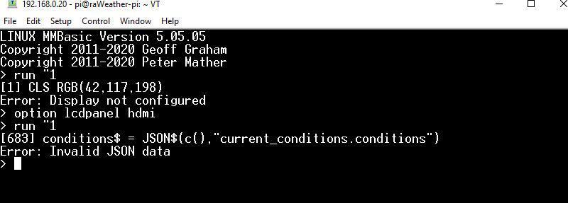

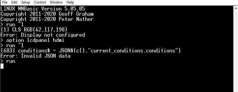

Sorry Peter, it crashed again first time I pressed run
I deleted the old mmbasic, and .options
transferred this version and got this immediately
Edit:
Without doing anything else I pressed run and it ran, same as before
btw it was around secs = 17 when I pressed run the first time so it shouldn't have tried to get the JSON data

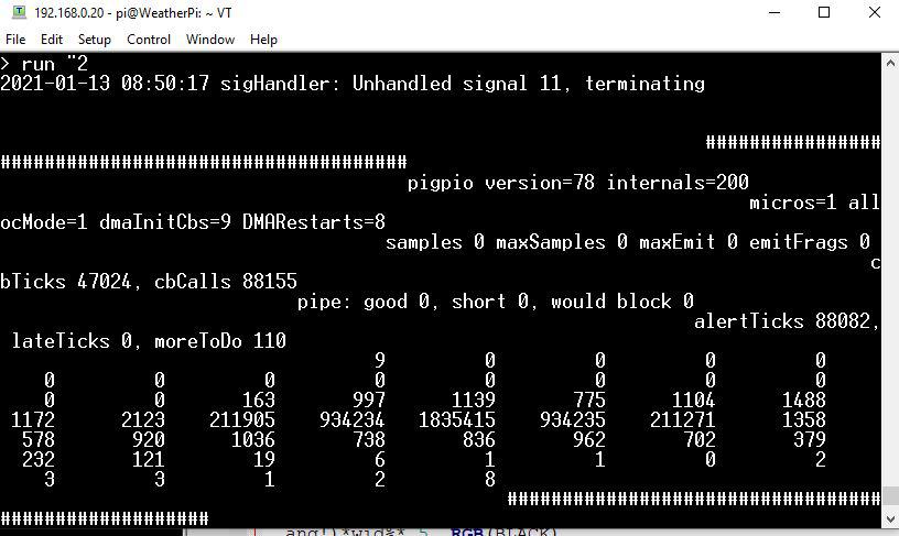

After it collected the data It came up with this
Posts: 12084
Posted: 10:40pm 10 Jan 2021
Ok - that's useful. It looks like the json you are trying to load is simply too big and/or complex for the parser. Nothing I can do about it I'm afraid

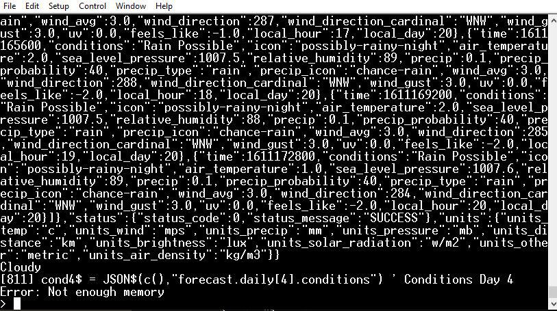

This version worked best out of all the ones you did yesterday, it ran for several hours before crashing and throwing this error
If I close the terminal and do screen -D -r it goes back to the error and won't do anything until I close the terminal again
The only way to gain control of the Pi again is close the terminal, log back in and reboot.

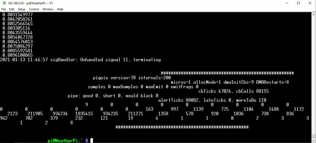

Posted: 11:17am 13 Jan 2021
Peter it's working perfectly for over 2 hours so far.
It did crash the very first time I press run but it was also a new install of the latest Stretch, Pigpio and python3-distutils on a clean SD card.
I took a screenshot in case it's any help

I spoke too soon
it crashed after almost 3 hours
Posts: 12084
Posted: 12:04pm 13 Jan 2021
Please run it on the version of stretch that you posted - any upgrades are likely to break it - this is exactly the problem with the whole Pi infrastructure
