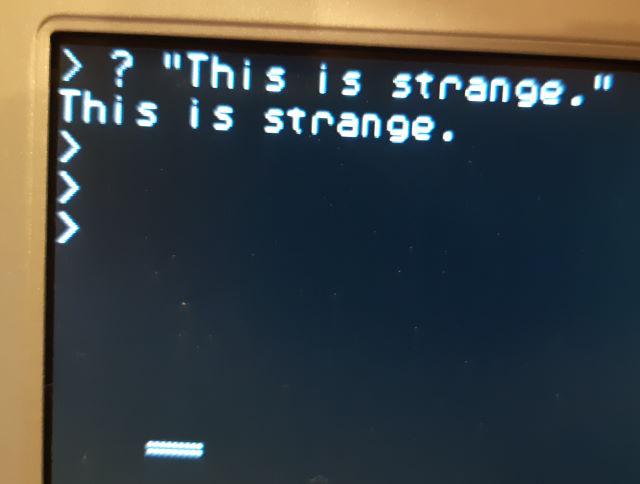

New weird thing.
If I exit the editor using F1, the underscore cursor is expanded and the system is in some strange video state. The video 'twitches' with the next command, the screen clears, then settles down.
Try 'F1' to exit editor, then immediately 'ls[Enter]' to list files.
Edited 2020-12-02 06:15 by vegipete

DRAW3D CREATE with no params locks up the machine.
Posts: 12085
Posted: 10:35pm 01 Dec 2020
  Quote  DRAW3D CREATE with no params locks up the machine.
Seems reasonable. Every bit of extra syntax checking slows the interpreter down. The CREATE command has no optional parameter so why would you expect it to check if you call it without any?
  Quote  New weird thing.
OPTIONS?
Edited 2020-12-02 08:50 by matherp
vegipete

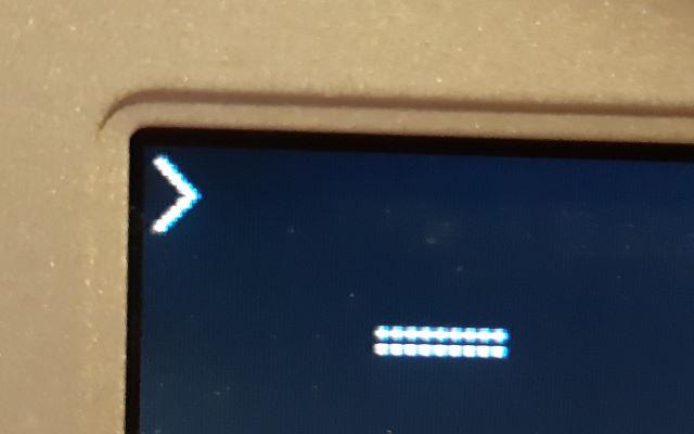

Posted: 01:28am 02 Dec 2020
OPTIONS?
The only option I've set is keyboard repeat.
> option list
CURRENT VGA mode 800x600 RGB332
CURRENT DISPLAY 50,100
OPTION USBKEYBOARD US
OPTION KEYBOARD REPEAT 400,30
Everything else is whatever happens from flashing firmware.
Same effect if I enter "option reset"
Anything mode command related fixes the problem. Some other commands do too. Generating a syntax error fixes it also.
The underscore cursor looks spread apart. The pixels are spaced one pixel apart. The character cell size appears double, although typed text is normal. Also, the CMM2 freezes once I'm 28 or 29 lines down the screen. The cursor disappears off the bottom at line 25 although the prompt character ">" is only half way down.
The individual cursor pixels are much more distinct than these photos show. The phote has blurred them together a bit.

Posted: 07:42am 02 Dec 2020
I had the same issues (cursor), similar OPTIONS, just my KEYBOARD REPEAT 500,80
I have to go back to few versions back, because after short time, my CMM2 locked up.
Jiri
Posts: 12085
Posted: 08:14am 02 Dec 2020
  Quote  I have to go back to few versions back, because after short time, my CMM2 locked up.
Rather than give up I really need you to identify the sequence of actions that causes the problems. For example if your are developing NC when this happens and you are using a CSUB then perhaps there is a correlation there.
I'm not going back to the 5.05 code base so this problem needs finding and fixing

Posts: 12085
Posted: 10:14am 02 Dec 2020
V5.06.00b11
http://geoffg.net/Downloads/Maximite/CMM2_Beta.zip
This version fixes a memory corruption that occurs if you leave the editor with F1
It is strongly recommended that you upgrade to this version if you are using any of the V5.06.00 beta versions.
