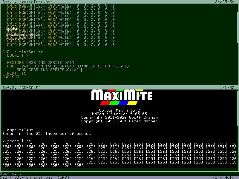

Hi all,
I uploaded XEdit 0.4. Here are the changes since 0.3:
- Added visual position-in-buffer indicator on right window border.
- Improved search speed.
- Fixed out of memory error when opening help screen in certain configurations, reported by thwill.
- Fixed weird 'animation' on last line when (un)indenting a selection that spans more than 1 screen. Also made indenting much faster.
- Dynamically sized keyword array (KEYWORD_LIST_DATA) using end sentinel as suggested by Jiri.
- Fixed bug: Search always started from the beginning of the line instead of from cursor.
- Added serial compatibility mode, enabled through flag SERIAL_INPUT_COMPAT_MODE. Note that enabling this mode affects certain keybindings. In particular, selection mode is toggled using the Esc key.
- Moved find-next keybinding to Ctrl-N. Added find-previous function bound to Alt-N.
- Added reverse-find keybinding, Alt-F.
- F6 shows console screen as it was when launching xedit in current buffer. This allows you to see your previous program output, trace list etc. from xedit. See screenshot below.
- F11 exits XEdit and runs program currently in buffer.

F6         = Show Console Screen in current buffer
