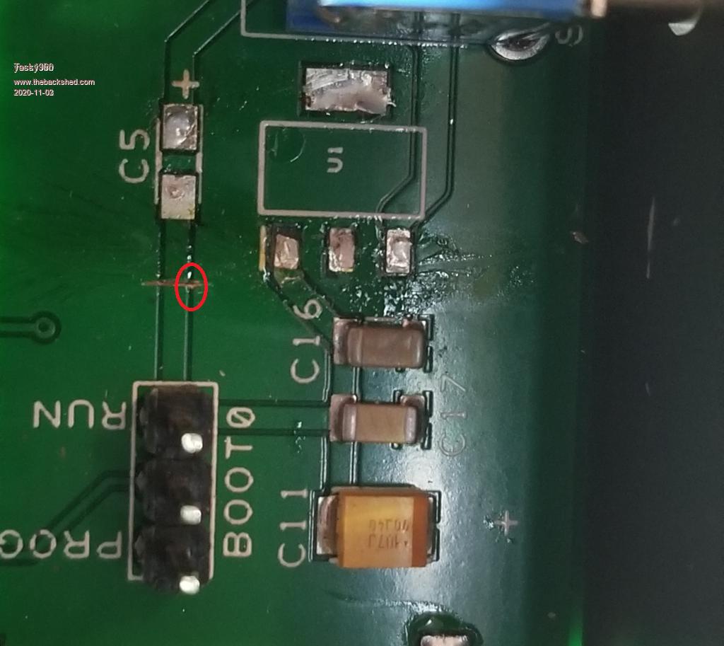

Posted: 01:03am 03 Nov 2020
I would run a scraper down the edges of the track you cut earlier. What Mick is correctly worried about is shorting the trace which is ground to the copper fill area which is 3.3V
The area circled looks a bit suspicious.

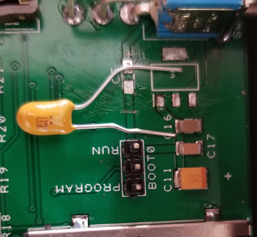

In light of TassyJim's concerns above, can I do something like this? Scraping a small section of the trace, soldering there and being very careful not to get solder in the cut.

Solder a new regulator on and if you have a clean supply you can probably ignore C5 completely. Certainly no issue testing without it

  yock1960 said  In light of TassyJim's concerns above, can I do something like this? Scraping a small section of the trace, soldering there and being very careful not to get solder in the cut.
Steve
It is the vertical gaps either side of the original trace that worries me.
When you did your horizontal cut, it looks like there are some copper dags that were left at the ends of the cut.
A quick scrape down the vertical gaps will ensure that they don't bridge to the copper fill area.
Your capacitor lead would be a good candidate for using as a solder aid if required but your cut is nice and narrow so it shouldn't be needed.
At Peter suggests, try without the capacitor first. If it doe work than consider the capacitor as a second step.
Steve
Jim,
Could you make a sketch on one of the photos to illustrate what you mean? My original understanding, before I knew about 'copper pour', was that I would be scraping off some solder mask on either side of the cut, then bridging the gap with solder. Now, my...less than complete understanding,  needless to say, is that perhaps I cut too deep, getting into the copper pour and my bridging solder would potentially short this trace to that. Maybe this was inevitable, maybe not...but given this, I'm not getting your 'scrapes on vertical gaps' and what this would accomplish.  Sorry to be so dense...but this kind of stuff is a bit beyond my experience!
Thanks!
Steve

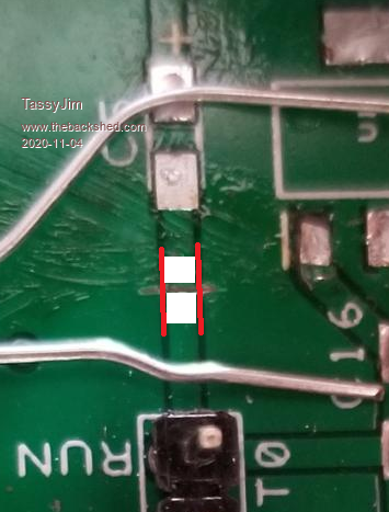

Posted: 09:22pm 03 Nov 2020
My description is not the best.
In this photo,
Run a scraper over the gap marked in red to make sure that there is no stray bits of copper that always appear when you do a cut. I can usually feel the scraper catching on the copper bits as I drag across the area.
Do this before starting to solder and there will be much less chance of solder running where you don't want it.
Then, scrape off the solder mask from the area in white ready for soldering. The bare copper exposed should be easy to solder to and provided you don't use too much solder, it will not spill over onto the unwanted areas.
If it does, a clean iron without any solder will usually take back any surplus solder.

  TassyJim said  My description is not the best.
In this photo,
Capeesh! Thanks!
