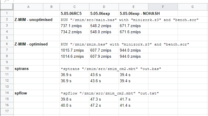

For what it's worth here are the results of my benchmarking the latest experimental firmware:
I guess that as long as we have OPTION NOHASH then I will only grumble quietly in the background.
Peter are you / can you optimise for the case when a Sub/Function has declared no Local variables and thus you don't need to cleanup the variable table ? - or would that also require the Sub/Function to also have no parameters ?
BUG! More worryingly running "spflow" with the experimental firmware WITHOUT using of NOHASH reproducably reports a spurious "Local variable already declared" error that despite a concerted effort I have been unable to reproduce in a simple example.

How do I run the benchmark in zmim?
Posted: 10:51am 22 Oct 2020
  matherp said  How do I run the benchmark in zmim?
For the optimised version:
RUN "/zmim/zmim.bas"
Select "minizork.z3"
Answer "N" at the prompt to write a script
At the >> prompt type *replay
Select "bench.scr"
For the unoptimised version, the same except:
RUN "/zmim/src/main.bas"
Note that the timing will not always be exactly the same, I think this is due to a random element in the interaction with the Troll that happens just before the Quit.
Thanks for spending your time on this,
Posts: 12086
Posted: 11:31am 22 Oct 2020
I assume you have a 400MHz CMM2?
