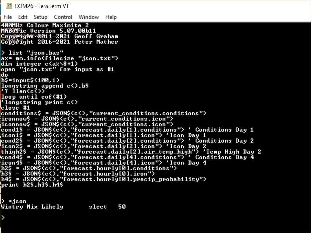

This is the biggest json receive example
{"latitude":53.44007,"longitude":-2.10608,"timezone":"Europe/London","timezone_offset_minutes":0,"current_conditions":{"time":1611999190,"conditions":"Wintry Mix Likely","icon":"sleet","air_temperature":4.0,"sea_level_pressure":996.3,"station_pressure":984.3,"pressure_trend":"steady","relative_humidity":66,"wind_avg":3.0,"wind_direction":134,"wind_direction_cardinal":"SE","wind_gust":6.0,"solar_radiation":27,"uv":0,"brightness":3303,"feels_like":1.0,"dew_point":-2.0,"wet_bulb_temperature":1.0,"delta_t":2.0,"air_density":1.24,"lightning_strike_count_last_1hr":0,"lightning_strike_count_last_3hr":0,"lightning_strike_last_distance":31,"lightning_strike_last_distance_msg":"30 - 32 km","lightning_strike_last_epoch":1608416353,"precip_accum_local_day":0,"precip_accum_local_yesterday":0.47,"precip_minutes_local_day":0,"precip_minutes_local_yesterday":21,"is_precip_local_day_rain_check":false,"is_precip_local_yesterday_rain_check":false},"forecast":{"daily":[{"day_start_local":1611964800,"day_num":30,"month_num":1,"conditions":"Wintry Mix Likely","icon":"sleet","sunrise":1611907085,"sunset":1611938741,"air_temp_high":5.0,"air_temp_low":1.0,"precip_probability":50,"precip_icon":"chance-sleet","precip_type":"sleet"},{"day_start_local":1612051200,"day_num":31,"month_num":1,"conditions":"Cloudy","icon":"cloudy","sunrise":1611993391,"sunset":1612025258,"air_temp_high":3.0,"air_temp_low":0.0,"precip_probability":10,"precip_icon":"chance-sleet","precip_type":"sleet"},{"day_start_local":1612137600,"day_num":1,"month_num":2,"conditions":"Rain Likely","icon":"rainy","sunrise":1612079694,"sunset":1612111776,"air_temp_high":5.0,"air_temp_low":1.0,"precip_probability":50,"precip_icon":"chance-rain","precip_type":"rain"},{"day_start_local":1612224000,"day_num":2,"month_num":2,"conditions":"Rain Likely","icon":"rainy","sunrise":1612165996,"sunset":1612198295,"air_temp_high":5.0,"air_temp_low":2.0,"precip_probability":80,"precip_icon":"chance-rain","precip_type":"rain"},{"day_start_local":1612310400,"day_num":3,"month_num":2,"conditions":"Rain Likely","icon":"rainy","sunrise":1612252295,"sunset":1612284814,"air_temp_high":7.0,"air_temp_low":4.0,"precip_probability":80,"precip_icon":"chance-rain","precip_type":"rain"},{"day_start_local":1612396800,"day_num":4,"month_num":2,"conditions":"Rain Likely","icon":"rainy","sunrise":1612338592,"sunset":1612371333,"air_temp_high":6.0,"air_temp_low":3.0,"precip_probability":50,"precip_icon":"chance-rain","precip_type":"rain"},{"day_start_local":1612483200,"day_num":5,"month_num":2,"conditions":"Rain Possible","icon":"possibly-rainy-day","sunrise":1612424887,"sunset":1612457853,"air_temp_high":5.0,"air_temp_low":1.0,"precip_probability":20,"precip_icon":"chance-rain","precip_type":"rain"},{"day_start_local":1612569600,"day_num":6,"month_num":2,"conditions":"Wintry Mix Possible","icon":"possibly-sleet-day","sunrise":1612511180,"sunset":1612544373,"air_temp_high":4.0,"air_temp_low":0.0,"precip_probability":20,"precip_icon":"chance-sleet","precip_type":"sleet"},{"day_start_local":1612656000,"day_num":7,"month_num":2,"conditions":"Wintry Mix Possible","icon":"possibly-sleet-day","sunrise":1612597471,"sunset":1612630893,"air_temp_high":3.0,"air_temp_low":0.0,"precip_probability":30,"precip_icon":"chance-sleet","precip_type":"sleet"},{"day_start_local":1612742400,"day_num":8,"month_num":2,"conditions":"Snow Possible","icon":"possibly-snow-day","sunrise":1612683760,"sunset":1612717413,"air_temp_high":4.0,"air_temp_low":0.0,"precip_probability":40,"precip_icon":"chance-snow","precip_type":"snow"}],"hourly":[{"time":1612000800,"conditions":"Wintry Mix Likely","icon":"sleet","air_temperature":3.0,"sea_level_pressure":998.66,"relative_humidity":79,"precip":0,"precip_probability":50,"precip_type":"sleet","precip_icon":"chance-sleet","wind_avg":8.0,"wind_direction":84,"wind_direction_cardinal":"E","wind_gust":14.0,"uv":0.0,"feels_like":-2.0,"local_hour":10,"local_day":30},{"time":1612004400,"conditions":"Wintry Mix Possible","icon":"possibly-sleet-day","air_temperature":4.0,"sea_level_pressure":998.96,"relative_humidity":76,"precip":0.07,"precip_probability":45,"precip_type":"sleet","precip_icon":"chance-sleet","wind_avg":8.0,"wind_direction":85,"wind_direction_cardinal":"E","wind_gust":14.0,"uv":0.0,"feels_like":-2.0,"local_hour":11,"local_day":30},{"time":1612008000,"conditions":"Wintry Mix Likely","icon":"sleet","air_temperature":4.0,"sea_level_pressure":999.36,"relative_humidity":76,"precip":0.27,"precip_probability":50,"precip_type":"sleet","precip_icon":"chance-sleet","wind_avg":8.0,"wind_direction":85,"wind_direction_cardinal":"E","wind_gust":14.0,"uv":0.0,"feels_like":-2.0,"local_hour":12,"local_day":30},{"time":1612011600,"conditions":"Rain Possible","icon":"possibly-rainy-day","air_temperature":3.0,"sea_level_pressure":999.63,"relative_humidity":74,"precip":0.29,"precip_probability":45,"precip_type":"rain","precip_icon":"chance-rain","wind_avg":8.0,"wind_direction":83,"wind_direction_cardinal":"E","wind_gust":15.0,"uv":0.0,"feels_like":-3.0,"local_hour":13,"local_day":30},{"time":1612015200,"conditions":"Rain Possible","icon":"possibly-rainy-day","air_temperature":3.0,"sea_level_pressure":1000.06,"relative_humidity":72,"precip":0,"precip_probability":25,"precip_type":"rain","precip_icon":"chance-rain","wind_avg":9.0,"wind_direction":80,"wind_direction_cardinal":"E","wind_gust":15.0,"uv":0.0,"feels_like":-2.0,"local_hour":14,"local_day":30},{"time":1612018800,"conditions":"Cloudy","icon":"cloudy","air_temperature":3.0,"sea_level_pressure":1000.46,"relative_humidity":70,"precip":0,"precip_probability":0,"wind_avg":8.0,"wind_direction":77,"wind_direction_cardinal":"ENE","wind_gust":15.0,"uv":0.0,"feels_like":-2.0,"local_hour":15,"local_day":30},{"time":1612022400,"conditions":"Cloudy","icon":"cloudy","air_temperature":3.0,"sea_level_pressure":1001.16,"relative_humidity":70,"precip":0,"precip_probability":0,"wind_avg":8.0,"wind_direction":75,"wind_direction_cardinal":"ENE","wind_gust":14.0,"uv":0.0,"feels_like":-2.0,"local_hour":16,"local_day":30},{"time":1612026000,"conditions":"Cloudy","icon":"cloudy","air_temperature":3.0,"sea_level_pressure":1002.06,"relative_humidity":72,"precip":0,"precip_probability":5,"precip_type":"rain","precip_icon":"chance-rain","wind_avg":8.0,"wind_direction":74,"wind_direction_cardinal":"ENE","wind_gust":14.0,"uv":0.0,"feels_like":-3.0,"local_hour":17,"local_day":30},{"time":1612029600,"conditions":"Cloudy","icon":"cloudy","air_temperature":3.0,"sea_level_pressure":1003.16,"relative_humidity":72,"precip":0,"precip_probability":5,"precip_type":"rain","precip_icon":"chance-rain","wind_avg":7.0,"wind_direction":72,"wind_direction_cardinal":"ENE","wind_gust":13.0,"uv":0.0,"feels_like":-3.0,"local_hour":18,"local_day":30},{"time":1612033200,"conditions":"Partly Cloudy","icon":"partly-cloudy-night","air_temperature":2.0,"sea_level_pressure":1003.97,"relative_humidity":74,"precip":0,"precip_probability":5,"precip_type":"rain","precip_icon":"chance-rain","wind_avg":7.0,"wind_direction":70,"wind_direction_cardinal":"ENE","wind_gust":12.0,"uv":0.0,"feels_like":-3.0,"local_hour":19,"local_day":30},{"time":1612036800,"conditions":"Partly Cloudy","icon":"partly-cloudy-night","air_temperature":2.0,"sea_level_pressure":1004.67,"relative_humidity":75,"precip":0,"precip_probability":5,"precip_type":"rain","precip_icon":"chance-rain","wind_avg":6.0,"wind_direction":70,"wind_direction_cardinal":"ENE","wind_gust":12.0,"uv":0.0,"feels_like":-3.0,"local_hour":20,"local_day":30},{"time":1612040400,"conditions":"Partly Cloudy","icon":"partly-cloudy-night","air_temperature":2.0,"sea_level_pressure":1005.4,"relative_humidity":76,"precip":0,"precip_probability":5,"precip_type":"rain","precip_icon":"chance-rain","wind_avg":5.0,"wind_direction":73,"wind_direction_cardinal":"ENE","wind_gust":10.0,"uv":0.0,"feels_like":-3.0,"local_hour":21,"local_day":30},{"time":1612044000,"conditions":"Partly Cloudy","icon":"partly-cloudy-night","air_temperature":1.0,"sea_level_pressure":1005.96,"relative_humidity":78,"precip":0,"precip_probability":5,"precip_type":"sleet","precip_icon":"chance-sleet","wind_avg":5.0,"wind_direction":73,"wind_direction_cardinal":"ENE","wind_gust":9.0,"uv":0.0,"feels_like":-3.0,"local_hour":22,"local_day":30},{"time":1612047600,"conditions":"Partly Cloudy","icon":"partly-cloudy-night","air_temperature":1.0,"sea_level_pressure":1006.47,"relative_humidity":81,"precip":0,"precip_probability":5,"precip_type":"sleet","precip_icon":"chance-sleet","wind_avg":4.0,"wind_direction":72,"wind_direction_cardinal":"ENE","wind_gust":8.0,"uv":0.0,"feels_like":-4.0,"local_hour":23,"local_day":30},{"time":1612051200,"conditions":"Partly Cloudy","icon":"partly-cloudy-night","air_temperature":1.0,"sea_level_pressure":1006.76,"relative_humidity":81,"precip":0,"precip_probability":5,"precip_type":"sleet","precip_icon":"chance-sleet","wind_avg":4.0,"wind_direction":72,"wind_direction_cardinal":"ENE","wind_gust":5.0,"uv":0.0,"feels_like":-3.0,"local_hour":0,"local_day":31},{"time":1612054800,"conditions":"Partly Cloudy","icon":"partly-cloudy-night","air_temperature":1.0,"sea_level_pressure":1006.8,"relative_humidity":81,"precip":0,"precip_probability":5,"precip_type":"sleet","precip_icon":"chance-sleet","wind_avg":3.0,"wind_direction":74,"wind_direction_cardinal":"ENE","wind_gust":3.0,"uv":0.0,"feels_like":-3.0,"local_hour":1,"local_day":31},{"time":1612058400,"conditions":"Partly Cloudy","icon":"partly-cloudy-night","air_temperature":0.0,"sea_level_pressure":1006.76,"relative_humidity":82,"precip":0,"precip_probability":5,"precip_type":"sleet","precip_icon":"chance-sleet","wind_avg":3.0,"wind_direction":76,"wind_direction_cardinal":"ENE","wind_gust":3.0,"uv":0.0,"feels_like":-3.0,"local_hour":2,"local_day":31},{"time":1612062000,"conditions":"Partly Cloudy","icon":"partly-cloudy-night","air_temperature":0.0,"sea_level_pressure":1006.66,"relative_humidity":83,"precip":0,"precip_probability":5,"precip_type":"sleet","precip_icon":"chance-sleet","wind_avg":3.0,"wind_direction":76,"wind_direction_cardinal":"ENE","wind_gust":3.0,"uv":0.0,"feels_like":-3.0,"local_hour":3,"local_day":31},{"time":1612065600,"conditions":"Partly Cloudy","icon":"partly-cloudy-night","air_temperature":0.0,"sea_level_pressure":1006.4,"relative_humidity":83,"precip":0,"precip_probability":5,"precip_type":"sleet","precip_icon":"chance-sleet","wind_avg":3.0,"wind_direction":81,"wind_direction_cardinal":"E","wind_gust":3.0,"uv":0.0,"feels_like":-3.0,"local_hour":4,"local_day":31},{"time":1612069200,"conditions":"Partly Cloudy","icon":"partly-cloudy-night","air_temperature":0.0,"sea_level_pressure":1006.16,"relative_humidity":83,"precip":0,"precip_probability":5,"precip_type":"sleet","precip_icon":"chance-sleet","wind_avg":3.0,"wind_direction":84,"wind_direction_cardinal":"E","wind_gust":3.0,"uv":0.0,"feels_like":-3.0,"local_hour":5,"local_day":31},{"time":1612072800,"conditions":"Partly Cloudy","icon":"partly-cloudy-night","air_temperature":0.0,"sea_level_pressure":1005.7,"relative_humidity":83,"precip":0,"precip_probability":5,"precip_type":"sleet","precip_icon":"chance-sleet","wind_avg":3.0,"wind_direction":87,"wind_direction_cardinal":"E","wind_gust":3.0,"uv":0.0,"feels_like":-3.0,"local_hour":6,"local_day":31},{"time":1612076400,"conditions":"Partly Cloudy","icon":"partly-cloudy-night","air_temperature":0.0,"sea_level_pressure":1005.26,"relative_humidity":83,"precip":0,"precip_probability":5,"precip_type":"sleet","precip_icon":"chance-sleet","wind_avg":3.0,"wind_direction":92,"wind_direction_cardinal":"E","wind_gust":3.0,"uv":0.0,"feels_like":-4.0,"local_hour":7,"local_day":31},{"time":1612080000,"conditions":"Cloudy","icon":"cloudy","air_temperature":0.0,"sea_level_pressure":1004.8,"relative_humidity":83,"precip":0,"precip_probability":5,"precip_type":"sleet","precip_icon":"chance-sleet","wind_avg":3.0,"wind_direction":96,"wind_direction_cardinal":"E","wind_gust":3.0,"uv":0.0,"feels_like":-4.0,"local_hour":8,"local_day":31},{"time":1612083600,"conditions":"Cloudy","icon":"cloudy","air_temperature":1.0,"sea_level_pressure":1004.4,"relative_humidity":82,"precip":0,"precip_probability":5,"precip_type":"sleet","precip_icon":"chance-sleet","wind_avg":4.0,"wind_direction":100,"wind_direction_cardinal":"E","wind_gust":5.0,"uv":0.0,"feels_like":-3.0,"local_hour":9,"local_day":31},{"time":1612087200,"conditions":"Cloudy","icon":"cloudy","air_temperature":1.0,"sea_level_pressure":1003.86,"relative_humidity":80,"precip":0,"precip_probability":5,"precip_type":"sleet","precip_icon":"chance-sleet","wind_avg":4.0,"wind_direction":104,"wind_direction_cardinal":"ESE","wind_gust":5.0,"uv":0.0,"feels_like":-2.0,"local_hour":10,"local_day":31},{"time":1612090800,"conditions":"Cloudy","icon":"cloudy","air_temperature":2.0,"sea_level_pressure":1003.16,"relative_humidity":75,"precip":0,"precip_probability":5,"precip_type":"rain","precip_icon":"chance-rain","wind_avg":4.0,"wind_direction":108,"wind_direction_cardinal":"ESE","wind_gust":7.0,"uv":0.0,"feels_like":-2.0,"local_hour":11,"local_day":31},{"time":1612094400,"conditions":"Cloudy","icon":"cloudy","air_temperature":3.0,"sea_level_pressure":1002.16,"relative_humidity":72,"precip":0,"precip_probability":5,"precip_type":"rain","precip_icon":"chance-rain","wind_avg":5.0,"wind_direction":111,"wind_direction_cardinal":"ESE","wind_gust":8.0,"uv":0.0,"feels_like":-2.0,"local_hour":12,"local_day":31},{"time":1612098000,"conditions":"Cloudy","icon":"cloudy","air_temperature":3.0,"sea_level_pressure":1000.76,"relative_humidity":69,"precip":0,"precip_probability":0,"wind_avg":5.0,"wind_direction":113,"wind_direction_cardinal":"ESE","wind_gust":9.0,"uv":0.0,"feels_like":-2.0,"local_hour":13,"local_day":31},{"time":1612101600,"conditions":"Cloudy","icon":"cloudy","air_temperature":3.0,"sea_level_pressure":999.56,"relative_humidity":67,"precip":0,"precip_probability":0,"wind_avg":5.0,"wind_direction":112,"wind_direction_cardinal":"ESE","wind_gust":9.0,"uv":0.0,"feels_like":-1.0,"local_hour":14,"local_day":31},{"time":1612105200,"conditions":"Cloudy","icon":"cloudy","air_temperature":3.0,"sea_level_pressure":998.46,"relative_humidity":66,"precip":0,"precip_probability":0,"wind_avg":5.0,"wind_direction":105,"wind_direction_cardinal":"ESE","wind_gust":8.0,"uv":0.0,"feels_like":-1.0,"local_hour":15,"local_day":31},{"time":1612108800,"conditions":"Cloudy","icon":"cloudy","air_temperature":3.0,"sea_level_pressure":997.5,"relative_humidity":66,"precip":0,"precip_probability":0,"wind_avg":5.0,"wind_direction":106,"wind_direction_cardinal":"ESE","wind_gust":8.0,"uv":0.0,"feels_like":-1.0,"local_hour":16,"local_day":31},{"time":1612112400,"conditions":"Cloudy","icon":"cloudy","air_temperature":2.0,"sea_level_pressure":996.66,"relative_humidity":68,"precip":0,"precip_probability":0,"wind_avg":5.0,"wind_direction":103,"wind_direction_cardinal":"ESE","wind_gust":8.0,"uv":0.0,"feels_like":-2.0,"local_hour":17,"local_day":31},{"time":1612116000,"conditions":"Cloudy","icon":"cloudy","air_temperature":2.0,"sea_level_pressure":996.16,"relative_humidity":68,"precip":0,"precip_probability":5,"precip_type":"rain","precip_icon":"chance-rain","wind_avg":5.0,"wind_direction":100,"wind_direction_cardinal":"E","wind_gust":8.0,"uv":0.0,"feels_like":-2.0,"local_hour":18,"local_day":31},{"time":1612119600,"conditions":"Cloudy","icon":"cloudy","air_temperature":2.0,"sea_level_pressure":995.6,"relative_humidity":69,"precip":0,"precip_probability":5,"precip_type":"rain","precip_icon":"chance-rain","wind_avg":5.0,"wind_direction":98,"wind_direction_cardinal":"E","wind_gust":8.0,"uv":0.0,"feels_like":-3.0,"local_hour":19,"local_day":31},{"time":1612123200,"conditions":"Cloudy","icon":"cloudy","air_temperature":2.0,"sea_level_pressure":995.06,"relative_humidity":66,"precip":0,"precip_probability":5,"precip_type":"rain","precip_icon":"chance-rain","wind_avg":5.0,"wind_direction":97,"wind_direction_cardinal":"E","wind_gust":9.0,"uv":0.0,"feels_like":-3.0,"local_hour":20,"local_day":31},{"time":1612126800,"conditions":"Cloudy","icon":"cloudy","air_temperature":2.0,"sea_level_pressure":994.8,"relative_humidity":65,"precip":0,"precip_probability":5,"precip_type":"rain","precip_icon":"chance-rain","wind_avg":5.0,"wind_direction":97,"wind_direction_cardinal":"E","wind_gust":8.0,"uv":0.0,"feels_like":-3.0,"local_hour":21,"local_day":31},{"time":1612130400,"conditions":"Cloudy","icon":"cloudy","air_temperature":2.0,"sea_level_pressure":994.56,"relative_humidity":69,"precip":0,"precip_probability":5,"precip_type":"rain","precip_icon":"chance-rain","wind_avg":5.0,"wind_direction":95,"wind_direction_cardinal":"E","wind_gust":8.0,"uv":0.0,"feels_like":-3.0,"local_hour":22,"local_day":31},{"time":1612134000,"conditions":"Cloudy","icon":"cloudy","air_temperature":2.0,"sea_level_pressure":994.26,"relative_humidity":73,"precip":0,"precip_probability":5,"precip_type":"rain","precip_icon":"chance-rain","wind_avg":4.0,"wind_direction":90,"wind_direction_cardinal":"E","wind_gust":8.0,"uv":0.0,"feels_like":-3.0,"local_hour":23,"local_day":31},{"time":1612137600,"conditions":"Cloudy","icon":"cloudy","air_temperature":2.0,"sea_level_pressure":994.06,"relative_humidity":76,"precip":0,"precip_probability":10,"precip_type":"rain","precip_icon":"chance-rain","wind_avg":4.0,"wind_direction":89,"wind_direction_cardinal":"E","wind_gust":8.0,"uv":0.0,"feels_like":-3.0,"local_hour":0,"local_day":1},{"time":1612141200,"conditions":"Cloudy","icon":"cloudy","air_temperature":2.0,"sea_level_pressure":993.86,"relative_humidity":77,"precip":0,"precip_probability":15,"precip_type":"rain","precip_icon":"chance-rain","wind_avg":4.0,"wind_direction":89,"wind_direction_cardinal":"E","wind_gust":8.0,"uv":0.0,"feels_like":-3.0,"local_hour":1,"local_day":1},{"time":1612144800,"conditions":"Cloudy","icon":"cloudy","air_temperature":2.0,"sea_level_pressure":993.8,"relative_humidity":79,"precip":0,"precip_probability":15,"precip_type":"rain","precip_icon":"chance-rain","wind_avg":4.0,"wind_direction":86,"wind_direction_cardinal":"E","wind_gust":7.0,"uv":0.0,"feels_like":-3.0,"local_hour":2,"local_day":1},{"time":1612148400,"conditions":"Cloudy","icon":"cloudy","air_temperature":2.0,"sea_level_pressure":993.8,"relative_humidity":79,"precip":0,"precip_probability":15,"precip_type":"rain","precip_icon":"chance-rain","wind_avg":4.0,"wind_direction":83,"wind_direction_cardinal":"E","wind_gust":5.0,"uv":0.0,"feels_like":-3.0,"local_hour":3,"local_day":1},{"time":1612152000,"conditions":"Cloudy","icon":"cloudy","air_temperature":2.0,"sea_level_pressure":993.8,"relative_humidity":79,"precip":0,"precip_probability":15,"precip_type":"rain","precip_icon":"chance-rain","wind_avg":4.0,"wind_direction":84,"wind_direction_cardinal":"E","wind_gust":5.0,"uv":0.0,"feels_like":-2.0,"local_hour":4,"local_day":1},{"time":1612155600,"conditions":"Cloudy","icon":"cloudy","air_temperature":2.0,"sea_level_pressure":994.06,"relative_humidity":79,"precip":0,"precip_probability":15,"precip_type":"rain","precip_icon":"chance-rain","wind_avg":4.0,"wind_direction":83,"wind_direction_cardinal":"E","wind_gust":5.0,"uv":0.0,"feels_like":-2.0,"local_hour":5,"local_day":1},{"time":1612159200,"conditions":"Cloudy","icon":"cloudy","air_temperature":2.0,"sea_level_pressure":994.46,"relative_humidity":80,"precip":0,"precip_probability":15,"precip_type":"rain","precip_icon":"chance-rain","wind_avg":3.0,"wind_direction":82,"wind_direction_cardinal":"E","wind_gust":3.0,"uv":0.0,"feels_like":-2.0,"local_hour":6,"local_day":1},{"time":1612162800,"conditions":"Cloudy","icon":"cloudy","air_temperature":2.0,"sea_level_pressure":995.1,"relative_humidity":80,"precip":0,"precip_probability":15,"precip_type":"rain","precip_icon":"chance-rain","wind_avg":4.0,"wind_direction":81,"wind_direction_cardinal":"E","wind_gust":5.0,"uv":0.0,"feels_like":-2.0,"local_hour":7,"local_day":1},{"time":1612166400,"conditions":"Cloudy","icon":"cloudy","air_temperature":2.0,"sea_level_pressure":995.76,"relative_humidity":81,"precip":0,"precip_probability":15,"precip_type":"rain","precip_icon":"chance-rain","wind_avg":3.0,"wind_direction":78,"wind_direction_cardinal":"ENE","wind_gust":3.0,"uv":0.0,"feels_like":-2.0,"local_hour":8,"local_day":1},{"time":1612170000,"conditions":"Rain Possible","icon":"possibly-rainy-day","air_temperature":2.0,"sea_level_pressure":996.4,"relative_humidity":79,"precip":0,"precip_probability":20,"precip_type":"rain","precip_icon":"chance-rain","wind_avg":3.0,"wind_direction":77,"wind_direction_cardinal":"ENE","wind_gust":3.0,"uv":0.0,"feels_like":-2.0,"local_hour":9,"local_day":1},{"time":1612173600,"conditions":"Cloudy","icon":"cloudy","air_temperature":3.0,"sea_level_pressure":997.0,"relative_humidity":76,"precip":0,"precip_probability":15,"precip_type":"rain","precip_icon":"chance-rain","wind_avg":3.0,"wind_direction":76,"wind_direction_cardinal":"ENE","wind_gust":3.0,"uv":0.0,"feels_like":-1.0,"local_hour":10,"local_day":1},{"time":1612177200,"conditions":"Partly Cloudy","icon":"partly-cloudy-day","air_temperature":3.0,"sea_level_pressure":997.8,"relative_humidity":72,"precip":0,"precip_probability":15,"precip_type":"rain","precip_icon":"chance-rain","wind_avg":3.0,"wind_direction":78,"wind_direction_cardinal":"ENE","wind_gust":3.0,"uv":0.0,"feels_like":0.0,"local_hour":11,"local_day":1},{"time":1612180800,"conditions":"Partly Cloudy","icon":"partly-cloudy-day","air_temperature":4.0,"sea_level_pressure":998.4,"relative_humidity":68,"precip":0,"precip_probability":15,"precip_type":"rain","precip_icon":"chance-rain","wind_avg":4.0,"wind_direction":81,"wind_direction_cardinal":"E","wind_gust":5.0,"uv":0.0,"feels_like":1.0,"local_hour":12,"local_day":1},{"time":1612184400,"conditions":"Rain Possible","icon":"possibly-rainy-day","air_temperature":4.0,"sea_level_pressure":999.6,"relative_humidity":67,"precip":0,"precip_probability":25,"precip_type":"rain","precip_icon":"chance-rain","wind_avg":4.0,"wind_direction":82,"wind_direction_cardinal":"E","wind_gust":5.0,"uv":0.0,"feels_like":1.0,"local_hour":13,"local_day":1},{"time":1612188000,"conditions":"Rain Possible","icon":"possibly-rainy-day","air_temperature":5.0,"sea_level_pressure":999.7,"relative_humidity":65,"precip":0,"precip_probability":25,"precip_type":"rain","precip_icon":"chance-rain","wind_avg":4.0,"wind_direction":86,"wind_direction_cardinal":"E","wind_gust":5.0,"uv":0.0,"feels_like":2.0,"local_hour":14,"local_day":1},{"time":1612191600,"conditions":"Rain Possible","icon":"possibly-rainy-day","air_temperature":4.0,"sea_level_pressure":999.8,"relative_humidity":67,"precip":0,"precip_probability":20,"precip_type":"rain","precip_icon":"chance-rain","wind_avg":4.0,"wind_direction":85,"wind_direction_cardinal":"E","wind_gust":5.0,"uv":0.0,"feels_like":1.0,"local_hour":15,"local_day":1},{"time":1612195200,"conditions":"Rain Possible","icon":"possibly-rainy-day","air_temperature":4.0,"sea_level_pressure":1000.16,"relative_humidity":72,"precip":0,"precip_probability":25,"precip_type":"rain","precip_icon":"chance-rain","wind_avg":3.0,"wind_direction":84,"wind_direction_cardinal":"E","wind_gust":3.0,"uv":0.0,"feels_like":1.0,"local_hour":16,"local_day":1},{"time":1612198800,"conditions":"Rain Possible","icon":"possibly-rainy-night","air_temperature":3.0,"sea_level_pressure":1000.5,"relative_humidity":76,"precip":0,"precip_probability":25,"precip_type":"rain","precip_icon":"chance-rain","wind_avg":3.0,"wind_direction":88,"wind_direction_cardinal":"E","wind_gust":3.0,"uv":0.0,"feels_like":0.0,"local_hour":17,"local_day":1},{"time":1612202400,"conditions":"Rain Possible","icon":"possibly-rainy-night","air_temperature":2.0,"sea_level_pressure":1000.8,"relative_humidity":77,"precip":0,"precip_probability":25,"precip_type":"rain","precip_icon":"chance-rain","wind_avg":3.0,"wind_direction":91,"wind_direction_cardinal":"E","wind_gust":3.0,"uv":0.0,"feels_like":-1.0,"local_hour":18,"local_day":1},{"time":1612206000,"conditions":"Rain Possible","icon":"possibly-rainy-night","air_temperature":2.0,"sea_level_pressure":1000.8,"relative_humidity":80,"precip":0,"precip_probability":25,"precip_type":"rain","precip_icon":"chance-rain","wind_avg":3.0,"wind_direction":91,"wind_direction_cardinal":"E","wind_gust":3.0,"uv":0.0,"feels_like":-1.0,"local_hour":19,"local_day":1},{"time":1612209600,"conditions":"Rain Possible","icon":"possibly-rainy-night","air_temperature":2.0,"sea_level_pressure":1000.76,"relative_humidity":80,"precip":0,"precip_probability":25,"precip_type":"rain","precip_icon":"chance-rain","wind_avg":3.0,"wind_direction":97,"wind_direction_cardinal":"E","wind_gust":3.0,"uv":0.0,"feels_like":-2.0,"local_hour":20,"local_day":1},{"time":1612213200,"conditions":"Wintry Mix Possible","icon":"possibly-sleet-night","air_temperature":1.0,"sea_level_pressure":1000.36,"relative_humidity":79,"precip":0.2,"precip_probability":40,"precip_type":"sleet","precip_icon":"chance-sleet","wind_avg":4.0,"wind_direction":99,"wind_direction_cardinal":"E","wind_gust":5.0,"uv":0.0,"feels_like":-2.0,"local_hour":21,"local_day":1},{"time":1612216800,"conditions":"Rain Possible","icon":"possibly-rainy-night","air_temperature":2.0,"sea_level_pressure":999.86,"relative_humidity":80,"precip":0.2,"precip_probability":40,"precip_type":"rain","precip_icon":"chance-rain","wind_avg":4.0,"wind_direction":99,"wind_direction_cardinal":"E","wind_gust":5.0,"uv":0.0,"feels_like":-2.0,"local_hour":22,"local_day":1},{"time":1612220400,"conditions":"Snow Likely","icon":"snow","air_temperature":2.0,"sea_level_pressure":999.26,"relative_humidity":79,"precip":2,"precip_probability":50,"precip_type":"snow","precip_icon":"chance-snow","wind_avg":4.0,"wind_direction":100,"wind_direction_cardinal":"E","wind_gust":5.0,"uv":0.0,"feels_like":-3.0,"local_hour":23,"local_day":1},{"time":1612224000,"conditions":"Snow Likely","icon":"snow","air_temperature":2.0,"sea_level_pressure":998.8,"relative_humidity":80,"precip":5,"precip_probability":65,"precip_type":"snow","precip_icon":"chance-snow","wind_avg":4.0,"wind_direction":105,"wind_direction_cardinal":"ESE","wind_gust":7.0,"uv":0.0,"feels_like":-2.0,"local_hour":0,"local_day":2},{"time":1612227600,"conditions":"Snow Likely","icon":"snow","air_temperature":2.0,"sea_level_pressure":997.96,"relative_humidity":84,"precip":6,"precip_probability":75,"precip_type":"snow","precip_icon":"chance-snow","wind_avg":5.0,"wind_direction":108,"wind_direction_cardinal":"ESE","wind_gust":8.0,"uv":0.0,"feels_like":-3.0,"local_hour":1,"local_day":2},{"time":1612231200,"conditions":"Snow Likely","icon":"snow","air_temperature":2.0,"sea_level_pressure":997.2,"relative_humidity":87,"precip":6,"precip_probability":80,"precip_type":"snow","precip_icon":"chance-snow","wind_avg":5.0,"wind_direction":108,"wind_direction_cardinal":"ESE","wind_gust":8.0,"uv":0.0,"feels_like":-3.0,"local_hour":2,"local_day":2},{"time":1612234800,"conditions":"Snow Likely","icon":"snow","air_temperature":2.0,"sea_level_pressure":996.36,"relative_humidity":89,"precip":6,"precip_probability":80,"precip_type":"snow","precip_icon":"chance-snow","wind_avg":5.0,"wind_direction":108,"wind_direction_cardinal":"ESE","wind_gust":8.0,"uv":0.0,"feels_like":-3.0,"local_hour":3,"local_day":2},{"time":1612238400,"conditions":"Snow Likely","icon":"snow","air_temperature":2.0,"sea_level_pressure":995.46,"relative_humidity":90,"precip":7,"precip_probability":80,"precip_type":"snow","precip_icon":"chance-snow","wind_avg":5.0,"wind_direction":110,"wind_direction_cardinal":"ESE","wind_gust":9.0,"uv":0.0,"feels_like":-3.0,"local_hour":4,"local_day":2},{"time":1612242000,"conditions":"Snow Likely","icon":"snow","air_temperature":2.0,"sea_level_pressure":994.66,"relative_humidity":91,"precip":8,"precip_probability":80,"precip_type":"snow","precip_icon":"chance-snow","wind_avg":5.0,"wind_direction":109,"wind_direction_cardinal":"ESE","wind_gust":9.0,"uv":0.0,"feels_like":-3.0,"local_hour":5,"local_day":2},{"time":1612245600,"conditions":"Rain Likely","icon":"rainy","air_temperature":2.0,"sea_level_pressure":994.06,"relative_humidity":92,"precip":0.7,"precip_probability":80,"precip_type":"rain","precip_icon":"chance-rain","wind_avg":5.0,"wind_direction":105,"wind_direction_cardinal":"ESE","wind_gust":9.0,"uv":0.0,"feels_like":-3.0,"local_hour":6,"local_day":2},{"time":1612249200,"conditions":"Rain Likely","icon":"rainy","air_temperature":2.0,"sea_level_pressure":993.76,"relative_humidity":94,"precip":0.7,"precip_probability":80,"precip_type":"rain","precip_icon":"chance-rain","wind_avg":5.0,"wind_direction":106,"wind_direction_cardinal":"ESE","wind_gust":9.0,"uv":0.0,"feels_like":-3.0,"local_hour":7,"local_day":2},{"time":1612252800,"conditions":"Rain Likely","icon":"rainy","air_temperature":2.0,"sea_level_pressure":993.66,"relative_humidity":94,"precip":0.6,"precip_probability":75,"precip_type":"rain","precip_icon":"chance-rain","wind_avg":5.0,"wind_direction":106,"wind_direction_cardinal":"ESE","wind_gust":8.0,"uv":0.0,"feels_like":-3.0,"local_hour":8,"local_day":2},{"time":1612256400,"conditions":"Rain Likely","icon":"rainy","air_temperature":2.0,"sea_level_pressure":993.56,"relative_humidity":94,"precip":0.3,"precip_probability":65,"precip_type":"rain","precip_icon":"chance-rain","wind_avg":5.0,"wind_direction":107,"wind_direction_cardinal":"ESE","wind_gust":8.0,"uv":0.0,"feels_like":-2.0,"local_hour":9,"local_day":2},{"time":1612260000,"conditions":"Rain Likely","icon":"rainy","air_temperature":2.0,"sea_level_pressure":993.46,"relative_humidity":96,"precip":0.3,"precip_probability":60,"precip_type":"rain","precip_icon":"chance-rain","wind_avg":4.0,"wind_direction":107,"wind_direction_cardinal":"ESE","wind_gust":8.0,"uv":0.0,"feels_like":-2.0,"local_hour":10,"local_day":2},{"time":1612263600,"conditions":"Rain Likely","icon":"rainy","air_temperature":3.0,"sea_level_pressure":993.4,"relative_humidity":94,"precip":0.3,"precip_probability":65,"precip_type":"rain","precip_icon":"chance-rain","wind_avg":4.0,"wind_direction":108,"wind_direction_cardinal":"ESE","wind_gust":7.0,"uv":0.0,"feels_like":-1.0,"local_hour":11,"local_day":2},{"time":1612267200,"conditions":"Rain Likely","icon":"rainy","air_temperature":3.0,"sea_level_pressure":993.26,"relative_humidity":95,"precip":0.4,"precip_probability":60,"precip_type":"rain","precip_icon":"chance-rain","wind_avg":4.0,"wind_direction":109,"wind_direction_cardinal":"ESE","wind_gust":5.0,"uv":0.0,"feels_like":0.0,"local_hour":12,"local_day":2},{"time":1612270800,"conditions":"Rain Likely","icon":"rainy","air_temperature":4.0,"sea_level_pressure":992.86,"relative_humidity":94,"precip":0.4,"precip_probability":70,"precip_type":"rain","precip_icon":"chance-rain","wind_avg":4.0,"wind_direction":112,"wind_direction_cardinal":"ESE","wind_gust":5.0,"uv":0.0,"feels_like":0.0,"local_hour":13,"local_day":2},{"time":1612274400,"conditions":"Rain Likely","icon":"rainy","air_temperature":4.0,"sea_level_pressure":992.46,"relative_humidity":94,"precip":0.4,"precip_probability":70,"precip_type":"rain","precip_icon":"chance-rain","wind_avg":4.0,"wind_direction":112,"wind_direction_cardinal":"ESE","wind_gust":7.0,"uv":0.0,"feels_like":1.0,"local_hour":14,"local_day":2},{"time":1612278000,"conditions":"Rain Likely","icon":"rainy","air_temperature":4.0,"sea_level_pressure":992.2,"relative_humidity":93,"precip":0.6,"precip_probability":80,"precip_type":"rain","precip_icon":"chance-rain","wind_avg":4.0,"wind_direction":110,"wind_direction_cardinal":"ESE","wind_gust":5.0,"uv":0.0,"feels_like":1.0,"local_hour":15,"local_day":2},{"time":1612281600,"conditions":"Rain Likely","icon":"rainy","air_temperature":5.0,"sea_level_pressure":992.06,"relative_humidity":94,"precip":0.7,"precip_probability":80,"precip_type":"rain","precip_icon":"chance-rain","wind_avg":4.0,"wind_direction":115,"wind_direction_cardinal":"ESE","wind_gust":5.0,"uv":0.0,"feels_like":2.0,"local_hour":16,"local_day":2},{"time":1612285200,"conditions":"Rain Likely","icon":"rainy","air_temperature":5.0,"sea_level_pressure":992.1,"relative_humidity":95,"precip":0.8,"precip_probability":80,"precip_type":"rain","precip_icon":"chance-rain","wind_avg":3.0,"wind_direction":118,"wind_direction_cardinal":"ESE","wind_gust":3.0,"uv":0.0,"feels_like":2.0,"local_hour":17,"local_day":2},{"time":1612288800,"conditions":"Rain Likely","icon":"rainy","air_temperature":5.0,"sea_level_pressure":992.1,"relative_humidity":93,"precip":0.46,"precip_probability":75,"precip_type":"rain","precip_icon":"chance-rain","wind_avg":3.0,"wind_direction":120,"wind_direction_cardinal":"ESE","wind_gust":3.0,"uv":0.0,"feels_like":2.0,"local_hour":18,"local_day":2},{"time":1612292400,"conditions":"Rain Likely","icon":"rainy","air_temperature":5.0,"sea_level_pressure":992.1,"relative_humidity":95,"precip":0.5,"precip_probability":70,"precip_type":"rain","precip_icon":"chance-rain","wind_avg":3.0,"wind_direction":123,"wind_direction_cardinal":"ESE","wind_gust":3.0,"uv":0.0,"feels_like":2.0,"local_hour":19,"local_day":2},{"time":1612296000,"conditions":"Rain Likely","icon":"rainy","air_temperature":5.0,"sea_level_pressure":992.16,"relative_humidity":94,"precip":0.6,"precip_probability":65,"precip_type":"rain","precip_icon":"chance-rain","wind_avg":4.0,"wind_direction":127,"wind_direction_cardinal":"SE","wind_gust":5.0,"uv":0.0,"feels_like":2.0,"local_hour":20,"local_day":2},{"time":1612299600,"conditions":"Rain Likely","icon":"rainy","air_temperature":5.0,"sea_level_pressure":992.2,"relative_humidity":94,"precip":0.6,"precip_probability":65,"precip_type":"rain","precip_icon":"chance-rain","wind_avg":4.0,"wind_direction":131,"wind_direction_cardinal":"SE","wind_gust":5.0,"uv":0.0,"feels_like":2.0,"local_hour":21,"local_day":2},{"time":1612303200,"conditions":"Rain Likely","icon":"rainy","air_temperature":5.0,"sea_level_pressure":992.4,"relative_humidity":95,"precip":0.7,"precip_probability":70,"precip_type":"rain","precip_icon":"chance-rain","wind_avg":3.0,"wind_direction":134,"wind_direction_cardinal":"SE","wind_gust":3.0,"uv":0.0,"feels_like":2.0,"local_hour":22,"local_day":2},{"time":1612306800,"conditions":"Rain Likely","icon":"rainy","air_temperature":5.0,"sea_level_pressure":992.8,"relative_humidity":96,"precip":0.56,"precip_probability":65,"precip_type":"rain","precip_icon":"chance-rain","wind_avg":3.0,"wind_direction":137,"wind_direction_cardinal":"SE","wind_gust":3.0,"uv":0.0,"feels_like":2.0,"local_hour":23,"local_day":2},{"time":1612310400,"conditions":"Rain Likely","icon":"rainy","air_temperature":4.0,"sea_level_pressure":993.1,"relative_humidity":96,"precip":0.3,"precip_probability":60,"precip_type":"rain","precip_icon":"chance-rain","wind_avg":3.0,"wind_direction":143,"wind_direction_cardinal":"SE","wind_gust":3.0,"uv":0.0,"feels_like":2.0,"local_hour":0,"local_day":3},{"time":1612314000,"conditions":"Rain Likely","icon":"rainy","air_temperature":4.0,"sea_level_pressure":993.4,"relative_humidity":97,"precip":0.4,"precip_probability":70,"precip_type":"rain","precip_icon":"chance-rain","wind_avg":3.0,"wind_direction":155,"wind_direction_cardinal":"SSE","wind_gust":3.0,"uv":0.0,"feels_like":2.0,"local_hour":1,"local_day":3},{"time":1612317600,"conditions":"Rain Likely","icon":"rainy","air_temperature":4.0,"sea_level_pressure":993.7,"relative_humidity":97,"precip":0.6,"precip_probability":75,"precip_type":"rain","precip_icon":"chance-rain","wind_avg":3.0,"wind_direction":171,"wind_direction_cardinal":"S","wind_gust":3.0,"uv":0.0,"feels_like":2.0,"local_hour":2,"local_day":3},{"time":1612321200,"conditions":"Rain Likely","icon":"rainy","air_temperature":4.0,"sea_level_pressure":994.0,"relative_humidity":96,"precip":0.3,"precip_probability":65,"precip_type":"rain","precip_icon":"chance-rain","wind_avg":3.0,"wind_direction":164,"wind_direction_cardinal":"SSE","wind_gust":3.0,"uv":0.0,"feels_like":2.0,"local_hour":3,"local_day":3},{"time":1612324800,"conditions":"Rain Likely","icon":"rainy","air_temperature":4.0,"sea_level_pressure":994.3,"relative_humidity":96,"precip":0.3,"precip_probability":65,"precip_type":"rain","precip_icon":"chance-rain","wind_avg":3.0,"wind_direction":171,"wind_direction_cardinal":"S","wind_gust":3.0,"uv":0.0,"feels_like":2.0,"local_hour":4,"local_day":3},{"time":1612328400,"conditions":"Rain Likely","icon":"rainy","air_temperature":4.0,"sea_level_pressure":994.5,"relative_humidity":97,"precip":0.3,"precip_probability":60,"precip_type":"rain","precip_icon":"chance-rain","wind_avg":3.0,"wind_direction":166,"wind_direction_cardinal":"SSE","wind_gust":3.0,"uv":0.0,"feels_like":1.0,"local_hour":5,"local_day":3},{"time":1612332000,"conditions":"Rain Likely","icon":"rainy","air_temperature":4.0,"sea_level_pressure":994.9,"relative_humidity":97,"precip":0.3,"precip_probability":55,"precip_type":"rain","precip_icon":"chance-rain","wind_avg":3.0,"wind_direction":137,"wind_direction_cardinal":"SE","wind_gust":3.0,"uv":0.0,"feels_like":2.0,"local_hour":6,"local_day":3},{"time":1612335600,"conditions":"Rain Likely","icon":"rainy","air_temperature":4.0,"sea_level_pressure":995.3,"relative_humidity":97,"precip":0.3,"precip_probability":55,"precip_type":"rain","precip_icon":"chance-rain","wind_avg":3.0,"wind_direction":131,"wind_direction_cardinal":"SE","wind_gust":3.0,"uv":0.0,"feels_like":2.0,"local_hour":7,"local_day":3},{"time":1612339200,"conditions":"Rain Likely","icon":"rainy","air_temperature":4.0,"sea_level_pressure":995.8,"relative_humidity":97,"precip":0.3,"precip_probability":55,"precip_type":"rain","precip_icon":"chance-rain","wind_avg":3.0,"wind_direction":127,"wind_direction_cardinal":"SE","wind_gust":3.0,"uv":0.0,"feels_like":1.0,"local_hour":8,"local_day":3},{"time":1612342800,"conditions":"Rain Possible","icon":"possibly-rainy-day","air_temperature":4.0,"sea_level_pressure":996.2,"relative_humidity":99,"precip":0.2,"precip_probability":40,"precip_type":"rain","precip_icon":"chance-rain","wind_avg":3.0,"wind_direction":129,"wind_direction_cardinal":"SE","wind_gust":3.0,"uv":0.0,"feels_like":1.0,"local_hour":9,"local_day":3},{"time":1612346400,"conditions":"Rain Possible","icon":"possibly-rainy-day","air_temperature":5.0,"sea_level_pressure":996.6,"relative_humidity":97,"precip":0.2,"precip_probability":40,"precip_type":"rain","precip_icon":"chance-rain","wind_avg":3.0,"wind_direction":137,"wind_direction_cardinal":"SE","wind_gust":3.0,"uv":0.0,"feels_like":2.0,"local_hour":10,"local_day":3},{"time":1612350000,"conditions":"Rain Possible","icon":"possibly-rainy-day","air_temperature":6.0,"sea_level_pressure":996.8,"relative_humidity":93,"precip":0.2,"precip_probability":40,"precip_type":"rain","precip_icon":"chance-rain","wind_avg":3.0,"wind_direction":143,"wind_direction_cardinal":"SE","wind_gust":3.0,"uv":0.0,"feels_like":3.0,"local_hour":11,"local_day":3},{"time":1612353600,"conditions":"Rain Possible","icon":"possibly-rainy-day","air_temperature":6.0,"sea_level_pressure":997.1,"relative_humidity":91,"precip":0.2,"precip_probability":40,"precip_type":"rain","precip_icon":"chance-rain","wind_avg":4.0,"wind_direction":163,"wind_direction_cardinal":"SSE","wind_gust":5.0,"uv":0.0,"feels_like":3.0,"local_hour":12,"local_day":3},{"time":1612357200,"conditions":"Rain Likely","icon":"rainy","air_temperature":7.0,"sea_level_pressure":998.06,"relative_humidity":89,"precip":0.2,"precip_probability":50,"precip_type":"rain","precip_icon":"chance-rain","wind_avg":4.0,"wind_direction":163,"wind_direction_cardinal":"SSE","wind_gust":5.0,"uv":0.0,"feels_like":4.0,"local_hour":13,"local_day":3},{"time":1612360800,"conditions":"Rain Likely","icon":"rainy","air_temperature":7.0,"sea_level_pressure":998.2,"relative_humidity":88,"precip":0.2,"precip_probability":50,"precip_type":"rain","precip_icon":"chance-rain","wind_avg":4.0,"wind_direction":157,"wind_direction_cardinal":"SSE","wind_gust":5.0,"uv":0.0,"feels_like":4.0,"local_hour":14,"local_day":3},{"time":1612364400,"conditions":"Rain Likely","icon":"rainy","air_temperature":6.0,"sea_level_pressure":998.4,"relative_humidity":89,"precip":0.2,"precip_probability":50,"precip_type":"rain","precip_icon":"chance-rain","wind_avg":4.0,"wind_direction":132,"wind_direction_cardinal":"SE","wind_gust":5.0,"uv":0.0,"feels_like":4.0,"local_hour":15,"local_day":3},{"time":1612368000,"conditions":"Rain Likely","icon":"rainy","air_temperature":6.0,"sea_level_pressure":998.8,"relative_humidity":90,"precip":0.2,"precip_probability":50,"precip_type":"rain","precip_icon":"chance-rain","wind_avg":3.0,"wind_direction":124,"wind_direction_cardinal":"SE","wind_gust":3.0,"uv":0.0,"feels_like":4.0,"local_hour":16,"local_day":3},{"time":1612371600,"conditions":"Rain Likely","icon":"rainy","air_temperature":6.0,"sea_level_pressure":999.3,"relative_humidity":91,"precip":0.2,"precip_probability":50,"precip_type":"rain","precip_icon":"chance-rain","wind_avg":3.0,"wind_direction":105,"wind_direction_cardinal":"ESE","wind_gust":3.0,"uv":0.0,"feels_like":3.0,"local_hour":17,"local_day":3},{"time":1612375200,"conditions":"Rain Likely","icon":"rainy","air_temperature":5.0,"sea_level_pressure":999.9,"relative_humidity":91,"precip":0.2,"precip_probability":50,"precip_type":"rain","precip_icon":"chance-rain","wind_avg":3.0,"wind_direction":98,"wind_direction_cardinal":"E","wind_gust":3.0,"uv":0.0,"feels_like":3.0,"local_hour":18,"local_day":3},{"time":1612378800,"conditions":"Rain Likely","icon":"rainy","air_temperature":5.0,"sea_level_pressure":1000.5,"relative_humidity":94,"precip":0.24,"precip_probability":50,"precip_type":"rain","precip_icon":"chance-rain","wind_avg":3.0,"wind_direction":91,"wind_direction_cardinal":"E","wind_gust":3.0,"uv":0.0,"feels_like":2.0,"local_hour":19,"local_day":3},{"time":1612382400,"conditions":"Rain Likely","icon":"rainy","air_temperature":4.0,"sea_level_pressure":1001.06,"relative_humidity":94,"precip":0.3,"precip_probability":55,"precip_type":"rain","precip_icon":"chance-rain","wind_avg":3.0,"wind_direction":94,"wind_direction_cardinal":"E","wind_gust":3.0,"uv":0.0,"feels_like":2.0,"local_hour":20,"local_day":3},{"time":1612386000,"conditions":"Rain Likely","icon":"rainy","air_temperature":4.0,"sea_level_pressure":1001.6,"relative_humidity":94,"precip":0.2,"precip_probability":50,"precip_type":"rain","precip_icon":"chance-rain","wind_avg":3.0,"wind_direction":101,"wind_direction_cardinal":"E","wind_gust":3.0,"uv":0.0,"feels_like":1.0,"local_hour":21,"local_day":3},{"time":1612389600,"conditions":"Rain Possible","icon":"possibly-rainy-night","air_temperature":4.0,"sea_level_pressure":1002.1,"relative_humidity":94,"precip":0.2,"precip_probability":45,"precip_type":"rain","precip_icon":"chance-rain","wind_avg":3.0,"wind_direction":105,"wind_direction_cardinal":"ESE","wind_gust":3.0,"uv":0.0,"feels_like":1.0,"local_hour":22,"local_day":3},{"time":1612393200,"conditions":"Rain Possible","icon":"possibly-rainy-night","air_temperature":4.0,"sea_level_pressure":1002.6,"relative_humidity":95,"precip":0.2,"precip_probability":45,"precip_type":"rain","precip_icon":"chance-rain","wind_avg":3.0,"wind_direction":106,"wind_direction_cardinal":"ESE","wind_gust":3.0,"uv":0.0,"feels_like":1.0,"local_hour":23,"local_day":3},{"time":1612396800,"conditions":"Rain Possible","icon":"possibly-rainy-night","air_temperature":4.0,"sea_level_pressure":1003.0,"relative_humidity":95,"precip":0.2,"precip_probability":45,"precip_type":"rain","precip_icon":"chance-rain","wind_avg":3.0,"wind_direction":114,"wind_direction_cardinal":"ESE","wind_gust":3.0,"uv":0.0,"feels_like":1.0,"local_hour":0,"local_day":4},{"time":1612400400,"conditions":"Rain Possible","icon":"possibly-rainy-night","air_temperature":4.0,"sea_level_pressure":1003.4,"relative_humidity":97,"precip":0.2,"precip_probability":45,"precip_type":"rain","precip_icon":"chance-rain","wind_avg":3.0,"wind_direction":120,"wind_direction_cardinal":"ESE","wind_gust":3.0,"uv":0.0,"feels_like":1.0,"local_hour":1,"local_day":4},{"time":1612404000,"conditions":"Rain Possible","icon":"possibly-rainy-night","air_temperature":4.0,"sea_level_pressure":1003.8,"relative_humidity":96,"precip":0.1,"precip_probability":45,"precip_type":"rain","precip_icon":"chance-rain","wind_avg":3.0,"wind_direction":123,"wind_direction_cardinal":"ESE","wind_gust":3.0,"uv":0.0,"feels_like":1.0,"local_hour":2,"local_day":4},{"time":1612407600,"conditions":"Rain Possible","icon":"possibly-rainy-night","air_temperature":4.0,"sea_level_pressure":1004.1,"relative_humidity":95,"precip":0.1,"precip_probability":40,"precip_type":"rain","precip_icon":"chance-rain","wind_avg":3.0,"wind_direction":114,"wind_direction_cardinal":"ESE","wind_gust":3.0,"uv":0.0,"feels_like":1.0,"local_hour":3,"local_day":4},{"time":1612411200,"conditions":"Rain Possible","icon":"possibly-rainy-night","air_temperature":4.0,"sea_level_pressure":1004.5,"relative_humidity":95,"precip":0.1,"precip_probability":40,"precip_type":"rain","precip_icon":"chance-rain","wind_avg":3.0,"wind_direction":116,"wind_direction_cardinal":"ESE","wind_gust":3.0,"uv":0.0,"feels_like":1.0,"local_hour":4,"local_day":4},{"time":1612414800,"conditions":"Rain Possible","icon":"possibly-rainy-night","air_temperature":4.0,"sea_level_pressure":1005.0,"relative_humidity":95,"precip":0.1,"precip_probability":40,"precip_type":"rain","precip_icon":"chance-rain","wind_avg":3.0,"wind_direction":113,"wind_direction_cardinal":"ESE","wind_gust":3.0,"uv":0.0,"feels_like":1.0,"local_hour":5,"local_day":4},{"time":1612418400,"conditions":"Rain Possible","icon":"possibly-rainy-night","air_temperature":4.0,"sea_level_pressure":1005.4,"relative_humidity":94,"precip":0.1,"precip_probability":40,"precip_type":"rain","precip_icon":"chance-rain","wind_avg":3.0,"wind_direction":100,"wind_direction_cardinal":"E","wind_gust":3.0,"uv":0.0,"feels_like":1.0,"local_hour":6,"local_day":4},{"time":1612422000,"conditions":"Rain Possible","icon":"possibly-rainy-night","air_temperature":3.0,"sea_level_pressure":1006.0,"relative_humidity":95,"precip":0.1,"precip_probability":40,"precip_type":"rain","precip_icon":"chance-rain","wind_avg":3.0,"wind_direction":102,"wind_direction_cardinal":"ESE","wind_gust":3.0,"uv":0.0,"feels_like":0.0,"local_hour":7,"local_day":4},{"time":1612425600,"conditions":"Rain Possible","icon":"possibly-rainy-day","air_temperature":3.0,"sea_level_pressure":1006.6,"relative_humidity":95,"precip":0.1,"precip_probability":40,"precip_type":"rain","precip_icon":"chance-rain","wind_avg":3.0,"wind_direction":102,"wind_direction_cardinal":"ESE","wind_gust":3.0,"uv":0.0,"feels_like":0.0,"local_hour":8,"local_day":4},{"time":1612429200,"conditions":"Rain Possible","icon":"possibly-rainy-day","air_temperature":4.0,"sea_level_pressure":1007.2,"relative_humidity":93,"precip":0.1,"precip_probability":35,"precip_type":"rain","precip_icon":"chance-rain","wind_avg":3.0,"wind_direction":100,"wind_direction_cardinal":"E","wind_gust":3.0,"uv":0.0,"feels_like":1.0,"local_hour":9,"local_day":4},{"time":1612432800,"conditions":"Rain Possible","icon":"possibly-rainy-day","air_temperature":4.0,"sea_level_pressure":1007.7,"relative_humidity":92,"precip":0.1,"precip_probability":35,"precip_type":"rain","precip_icon":"chance-rain","wind_avg":4.0,"wind_direction":106,"wind_direction_cardinal":"ESE","wind_gust":5.0,"uv":0.0,"feels_like":1.0,"local_hour":10,"local_day":4},{"time":1612436400,"conditions":"Rain Possible","icon":"possibly-rainy-day","air_temperature":5.0,"sea_level_pressure":1008.1,"relative_humidity":89,"precip":0.1,"precip_probability":35,"precip_type":"rain","precip_icon":"chance-rain","wind_avg":4.0,"wind_direction":110,"wind_direction_cardinal":"ESE","wind_gust":5.0,"uv":0.0,"feels_like":2.0,"local_hour":11,"local_day":4},{"time":1612440000,"conditions":"Rain Possible","icon":"possibly-rainy-day","air_temperature":5.0,"sea_level_pressure":1008.5,"relative_humidity":88,"precip":0.1,"precip_probability":35,"precip_type":"rain","precip_icon":"chance-rain","wind_avg":4.0,"wind_direction":115,"wind_direction_cardinal":"ESE","wind_gust":5.0,"uv":0.0,"feels_like":2.0,"local_hour":12,"local_day":4},{"time":1612443600,"conditions":"Rain Possible","icon":"possibly-rainy-day","air_temperature":6.0,"sea_level_pressure":1008.7,"relative_humidity":85,"precip":0.1,"precip_probability":35,"precip_type":"rain","precip_icon":"chance-rain","wind_avg":4.0,"wind_direction":122,"wind_direction_cardinal":"ESE","wind_gust":5.0,"uv":0.0,"feels_like":2.0,"local_hour":13,"local_day":4},{"time":1612447200,"conditions":"Rain Possible","icon":"possibly-rainy-day","air_temperature":6.0,"sea_level_pressure":1008.8,"relative_humidity":86,"precip":0.1,"precip_probability":35,"precip_type":"rain","precip_icon":"chance-rain","wind_avg":4.0,"wind_direction":124,"wind_direction_cardinal":"SE","wind_gust":7.0,"uv":0.0,"feels_like":3.0,"local_hour":14,"local_day":4},{"time":1612450800,"conditions":"Rain Possible","icon":"possibly-rainy-day","air_temperature":6.0,"sea_level_pressure":1009.0,"relative_humidity":87,"precip":0,"precip_probability":25,"precip_type":"rain","precip_icon":"chance-rain","wind_avg":4.0,"wind_direction":117,"wind_direction_cardinal":"ESE","wind_gust":5.0,"uv":0.0,"feels_like":3.0,"local_hour":15,"local_day":4},{"time":1612454400,"conditions":"Rain Possible","icon":"possibly-rainy-day","air_temperature":6.0,"sea_level_pressure":1009.4,"relative_humidity":87,"precip":0,"precip_probability":25,"precip_type":"rain","precip_icon":"chance-rain","wind_avg":4.0,"wind_direction":113,"wind_direction_cardinal":"ESE","wind_gust":5.0,"uv":0.0,"feels_like":3.0,"local_hour":16,"local_day":4},{"time":1612458000,"conditions":"Rain Possible","icon":"possibly-rainy-night","air_temperature":5.0,"sea_level_pressure":1009.8,"relative_humidity":90,"precip":0,"precip_probability":25,"precip_type":"rain","precip_icon":"chance-rain","wind_avg":3.0,"wind_direction":104,"wind_direction_cardinal":"ESE","wind_gust":3.0,"uv":0.0,"feels_like":2.0,"local_hour":17,"local_day":4},{"time":1612461600,"conditions":"Rain Possible","icon":"possibly-rainy-night","air_temperature":5.0,"sea_level_pressure":1010.26,"relative_humidity":91,"precip":0.1,"precip_probability":30,"precip_type":"rain","precip_icon":"chance-rain","wind_avg":3.0,"wind_direction":101,"wind_direction_cardinal":"E","wind_gust":3.0,"uv":0.0,"feels_like":2.0,"local_hour":18,"local_day":4},{"time":1612465200,"conditions":"Rain Possible","icon":"possibly-rainy-night","air_temperature":5.0,"sea_level_pressure":1010.8,"relative_humidity":93,"precip":0.1,"precip_probability":35,"precip_type":"rain","precip_icon":"chance-rain","wind_avg":3.0,"wind_direction":100,"wind_direction_cardinal":"E","wind_gust":3.0,"uv":0.0,"feels_like":2.0,"local_hour":19,"local_day":4},{"time":1612468800,"conditions":"Rain Possible","icon":"possibly-rainy-night","air_temperature":5.0,"sea_level_pressure":1011.4,"relative_humidity":93,"precip":0.1,"precip_probability":35,"precip_type":"rain","precip_icon":"chance-rain","wind_avg":3.0,"wind_direction":102,"wind_direction_cardinal":"ESE","wind_gust":3.0,"uv":0.0,"feels_like":2.0,"local_hour":20,"local_day":4},{"time":1612472400,"conditions":"Rain Possible","icon":"possibly-rainy-night","air_temperature":5.0,"sea_level_pressure":1011.9,"relative_humidity":93,"precip":0.1,"precip_probability":35,"precip_type":"rain","precip_icon":"chance-rain","wind_avg":3.0,"wind_direction":107,"wind_direction_cardinal":"ESE","wind_gust":3.0,"uv":0.0,"feels_like":2.0,"local_hour":21,"local_day":4},{"time":1612476000,"conditions":"Rain Possible","icon":"possibly-rainy-night","air_temperature":5.0,"sea_level_pressure":1012.36,"relative_humidity":93,"precip":0.1,"precip_probability":35,"precip_type":"rain","precip_icon":"chance-rain","wind_avg":3.0,"wind_direction":108,"wind_direction_cardinal":"ESE","wind_gust":3.0,"uv":0.0,"feels_like":2.0,"local_hour":22,"local_day":4},{"time":1612479600,"conditions":"Rain Possible","icon":"possibly-rainy-night","air_temperature":5.0,"sea_level_pressure":1012.76,"relative_humidity":92,"precip":0.1,"precip_probability":30,"precip_type":"rain","precip_icon":"chance-rain","wind_avg":3.0,"wind_direction":104,"wind_direction_cardinal":"ESE","wind_gust":3.0,"uv":0.0,"feels_like":2.0,"local_hour":23,"local_day":4},{"time":1612483200,"conditions":"Partly Cloudy","icon":"partly-cloudy-night","air_temperature":4.0,"sea_level_pressure":1013.0,"relative_humidity":93,"precip":0,"precip_probability":15,"precip_type":"rain","precip_icon":"chance-rain","wind_avg":3.0,"wind_direction":108,"wind_direction_cardinal":"ESE","wind_gust":3.0,"uv":0.0,"feels_like":1.0,"local_hour":0,"local_day":5},{"time":1612486800,"conditions":"Partly Cloudy","icon":"partly-cloudy-night","air_temperature":4.0,"sea_level_pressure":1014.1,"relative_humidity":93,"precip":0,"precip_probability":15,"precip_type":"rain","precip_icon":"chance-rain","wind_avg":4.0,"wind_direction":109,"wind_direction_cardinal":"ESE","wind_gust":5.0,"uv":0.0,"feels_like":1.0,"local_hour":1,"local_day":5},{"time":1612490400,"conditions":"Partly Cloudy","icon":"partly-cloudy-night","air_temperature":4.0,"sea_level_pressure":1014.3,"relative_humidity":94,"precip":0,"precip_probability":15,"precip_type":"rain","precip_icon":"chance-rain","wind_avg":4.0,"wind_direction":108,"wind_direction_cardinal":"ESE","wind_gust":5.0,"uv":0.0,"feels_like":0.0,"local_hour":2,"local_day":5},{"time":1612494000,"conditions":"Partly Cloudy","icon":"partly-cloudy-night","air_temperature":4.0,"sea_level_pressure":1014.6,"relative_humidity":93,"precip":0,"precip_probability":15,"precip_type":"rain","precip_icon":"chance-rain","wind_avg":4.0,"wind_direction":106,"wind_direction_cardinal":"ESE","wind_gust":5.0,"uv":0.0,"feels_like":0.0,"local_hour":3,"local_day":5},{"time":1612497600,"conditions":"Partly Cloudy","icon":"partly-cloudy-night","air_temperature":3.0,"sea_level_pressure":1014.86,"relative_humidity":93,"precip":0,"precip_probability":15,"precip_type":"rain","precip_icon":"chance-rain","wind_avg":3.0,"wind_direction":108,"wind_direction_cardinal":"ESE","wind_gust":3.0,"uv":0.0,"feels_like":0.0,"local_hour":4,"local_day":5},{"time":1612501200,"conditions":"Partly Cloudy","icon":"partly-cloudy-night","air_temperature":3.0,"sea_level_pressure":1015.16,"relative_humidity":93,"precip":0,"precip_probability":15,"precip_type":"rain","precip_icon":"chance-rain","wind_avg":4.0,"wind_direction":104,"wind_direction_cardinal":"ESE","wind_gust":5.0,"uv":0.0,"feels_like":0.0,"local_hour":5,"local_day":5},{"time":1612504800,"conditions":"Rain Possible","icon":"possibly-rainy-night","air_temperature":3.0,"sea_level_pressure":1015.5,"relative_humidity":93,"precip":0,"precip_probability":20,"precip_type":"rain","precip_icon":"chance-rain","wind_avg":3.0,"wind_direction":94,"wind_direction_cardinal":"E","wind_gust":3.0,"uv":0.0,"feels_like":0.0,"local_hour":6,"local_day":5},{"time":1612508400,"conditions":"Rain Possible","icon":"possibly-rainy-night","air_temperature":3.0,"sea_level_pressure":1016.0,"relative_humidity":92,"precip":0,"precip_probability":20,"precip_type":"rain","precip_icon":"chance-rain","wind_avg":4.0,"wind_direction":91,"wind_direction_cardinal":"E","wind_gust":5.0,"uv":0.0,"feels_like":0.0,"local_hour":7,"local_day":5},{"time":1612512000,"conditions":"Rain Possible","icon":"possibly-rainy-day","air_temperature":4.0,"sea_level_pressure":1016.6,"relative_humidity":91,"precip":0,"precip_probability":20,"precip_type":"rain","precip_icon":"chance-rain","wind_avg":4.0,"wind_direction":88,"wind_direction_cardinal":"E","wind_gust":5.0,"uv":0.0,"feels_like":0.0,"local_hour":8,"local_day":5},{"time":1612515600,"conditions":"Partly Cloudy","icon":"partly-cloudy-day","air_temperature":4.0,"sea_level_pressure":1017.2,"relative_humidity":90,"precip":0,"precip_probability":10,"precip_type":"rain","precip_icon":"chance-rain","wind_avg":4.0,"wind_direction":84,"wind_direction_cardinal":"E","wind_gust":5.0,"uv":0.0,"feels_like":0.0,"local_hour":9,"local_day":5},{"time":1612519200,"conditions":"Partly Cloudy","icon":"partly-cloudy-day","air_temperature":4.0,"sea_level_pressure":1017.56,"relative_humidity":89,"precip":0,"precip_probability":10,"precip_type":"rain","precip_icon":"chance-rain","wind_avg":4.0,"wind_direction":81,"wind_direction_cardinal":"E","wind_gust":5.0,"uv":0.0,"feels_like":1.0,"local_hour":10,"local_day":5},{"time":1612522800,"conditions":"Partly Cloudy","icon":"partly-cloudy-day","air_temperature":5.0,"sea_level_pressure":1017.8,"relative_humidity":84,"precip":0,"precip_probability":10,"precip_type":"rain","precip_icon":"chance-rain","wind_avg":4.0,"wind_direction":77,"wind_direction_cardinal":"ENE","wind_gust":5.0,"uv":0.0,"feels_like":1.0,"local_hour":11,"local_day":5},{"time":1612526400,"conditions":"Partly Cloudy","icon":"partly-cloudy-day","air_temperature":5.0,"sea_level_pressure":1018.0,"relative_humidity":84,"precip":0,"precip_probability":15,"precip_type":"rain","precip_icon":"chance-rain","wind_avg":5.0,"wind_direction":75,"wind_direction_cardinal":"ENE","wind_gust":7.0,"uv":1.0,"feels_like":2.0,"local_hour":12,"local_day":5},{"time":1612530000,"conditions":"Partly Cloudy","icon":"partly-cloudy-day","air_temperature":5.0,"sea_level_pressure":1018.56,"relative_humidity":83,"precip":0,"precip_probability":15,"precip_type":"rain","precip_icon":"chance-rain","wind_avg":5.0,"wind_direction":70,"wind_direction_cardinal":"ENE","wind_gust":7.0,"uv":1.0,"feels_like":2.0,"local_hour":13,"local_day":5},{"time":1612533600,"conditions":"Partly Cloudy","icon":"partly-cloudy-day","air_temperature":5.0,"sea_level_pressure":1018.5,"relative_humidity":81,"precip":0,"precip_probability":15,"precip_type":"rain","precip_icon":"chance-rain","wind_avg":5.0,"wind_direction":64,"wind_direction_cardinal":"ENE","wind_gust":6.0,"uv":0.0,"feels_like":2.0,"local_hour":14,"local_day":5},{"time":1612537200,"conditions":"Partly Cloudy","icon":"partly-cloudy-day","air_temperature":5.0,"sea_level_pressure":1018.6,"relative_humidity":83,"precip":0,"precip_probability":15,"precip_type":"rain","precip_icon":"chance-rain","wind_avg":5.0,"wind_direction":58,"wind_direction_cardinal":"ENE","wind_gust":6.0,"uv":0.0,"feels_like":1.0,"local_hour":15,"local_day":5},{"time":1612540800,"conditions":"Partly Cloudy","icon":"partly-cloudy-day","air_temperature":4.0,"sea_level_pressure":1018.9,"relative_humidity":84,"precip":0,"precip_probability":15,"precip_type":"rain","precip_icon":"chance-rain","wind_avg":5.0,"wind_direction":50,"wind_direction_cardinal":"NE","wind_gust":6.0,"uv":0.0,"feels_like":1.0,"local_hour":16,"local_day":5},{"time":1612544400,"conditions":"Partly Cloudy","icon":"partly-cloudy-night","air_temperature":3.0,"sea_level_pressure":1019.2,"relative_humidity":86,"precip":0,"precip_probability":15,"precip_type":"rain","precip_icon":"chance-rain","wind_avg":5.0,"wind_direction":50,"wind_direction_cardinal":"NE","wind_gust":6.0,"uv":0.0,"feels_like":-1.0,"local_hour":17,"local_day":5},{"time":1612548000,"conditions":"Partly Cloudy","icon":"partly-cloudy-night","air_temperature":3.0,"sea_level_pressure":1019.56,"relative_humidity":86,"precip":0,"precip_probability":10,"precip_type":"rain","precip_icon":"chance-rain","wind_avg":5.0,"wind_direction":51,"wind_direction_cardinal":"NE","wind_gust":6.0,"uv":0.0,"feels_like":-1.0,"local_hour":18,"local_day":5},{"time":1612551600,"conditions":"Partly Cloudy","icon":"partly-cloudy-night","air_temperature":2.0,"sea_level_pressure":1019.96,"relative_humidity":89,"precip":0,"precip_probability":10,"precip_type":"rain","precip_icon":"chance-rain","wind_avg":5.0,"wind_direction":51,"wind_direction_cardinal":"NE","wind_gust":6.0,"uv":0.0,"feels_like":-2.0,"local_hour":19,"local_day":5},{"time":1612555200,"conditions":"Partly Cloudy","icon":"partly-cloudy-night","air_temperature":2.0,"sea_level_pressure":1020.36,"relative_humidity":89,"precip":0,"precip_probability":10,"precip_type":"rain","precip_icon":"chance-rain","wind_avg":5.0,"wind_direction":54,"wind_direction_cardinal":"NE","wind_gust":6.0,"uv":0.0,"feels_like":-3.0,"local_hour":20,"local_day":5},{"time":1612558800,"conditions":"Rain Possible","icon":"possibly-rainy-night","air_temperature":2.0,"sea_level_pressure":1020.7,"relative_humidity":90,"precip":0,"precip_probability":20,"precip_type":"rain","precip_icon":"chance-rain","wind_avg":5.0,"wind_direction":58,"wind_direction_cardinal":"ENE","wind_gust":6.0,"uv":0.0,"feels_like":-3.0,"local_hour":21,"local_day":5},{"time":1612562400,"conditions":"Partly Cloudy","icon":"partly-cloudy-night","air_temperature":2.0,"sea_level_pressure":1020.9,"relative_humidity":88,"precip":0,"precip_probability":15,"precip_type":"rain","precip_icon":"chance-rain","wind_avg":5.0,"wind_direction":63,"wind_direction_cardinal":"ENE","wind_gust":6.0,"uv":0.0,"feels_like":-3.0,"local_hour":22,"local_day":5},{"time":1612566000,"conditions":"Partly Cloudy","icon":"partly-cloudy-night","air_temperature":1.0,"sea_level_pressure":1021.0,"relative_humidity":89,"precip":0,"precip_probability":15,"precip_type":"sleet","precip_icon":"chance-sleet","wind_avg":5.0,"wind_direction":62,"wind_direction_cardinal":"ENE","wind_gust":6.0,"uv":0.0,"feels_like":-3.0,"local_hour":23,"local_day":5},{"time":1612569600,"conditions":"Partly Cloudy","icon":"partly-cloudy-night","air_temperature":1.0,"sea_level_pressure":1021.0,"relative_humidity":87,"precip":0,"precip_probability":5,"precip_type":"sleet","precip_icon":"chance-sleet","wind_avg":4.0,"wind_direction":68,"wind_direction_cardinal":"ENE","wind_gust":5.0,"uv":0.0,"feels_like":-3.0,"local_hour":0,"local_day":6},{"time":1612573200,"conditions":"Partly Cloudy","icon":"partly-cloudy-night","air_temperature":1.0,"sea_level_pressure":1021.0,"relative_humidity":88,"precip":0,"precip_probability":5,"precip_type":"sleet","precip_icon":"chance-sleet","wind_avg":5.0,"wind_direction":70,"wind_direction_cardinal":"ENE","wind_gust":6.0,"uv":0.0,"feels_like":-4.0,"local_hour":1,"local_day":6},{"time":1612576800,"conditions":"Partly Cloudy","icon":"partly-cloudy-night","air_temperature":1.0,"sea_level_pressure":1020.9,"relative_humidity":89,"precip":0,"precip_probability":5,"precip_type":"sleet","precip_icon":"chance-sleet","wind_avg":4.0,"wind_direction":66,"wind_direction_cardinal":"ENE","wind_gust":5.0,"uv":0.0,"feels_like":-4.0,"local_hour":2,"local_day":6},{"time":1612580400,"conditions":"Partly Cloudy","icon":"partly-cloudy-night","air_temperature":1.0,"sea_level_pressure":1020.86,"relative_humidity":87,"precip":0,"precip_probability":5,"precip_type":"sleet","precip_icon":"chance-sleet","wind_avg":4.0,"wind_direction":68,"wind_direction_cardinal":"ENE","wind_gust":5.0,"uv":0.0,"feels_like":-4.0,"local_hour":3,"local_day":6},{"time":1612584000,"conditions":"Partly Cloudy","icon":"partly-cloudy-night","air_temperature":1.0,"sea_level_pressure":1020.8,"relative_humidity":88,"precip":0,"precip_probability":5,"precip_type":"sleet","precip_icon":"chance-sleet","wind_avg":4.0,"wind_direction":72,"wind_direction_cardinal":"ENE","wind_gust":5.0,"uv":0.0,"feels_like":-4.0,"local_hour":4,"local_day":6},{"time":1612587600,"conditions":"Partly Cloudy","icon":"partly-cloudy-night","air_temperature":1.0,"sea_level_pressure":1020.76,"relative_humidity":87,"precip":0,"precip_probability":5,"precip_type":"sleet","precip_icon":"chance-sleet","wind_avg":4.0,"wind_direction":71,"wind_direction_cardinal":"ENE","wind_gust":5.0,"uv":0.0,"feels_like":-4.0,"local_hour":5,"local_day":6},{"time":1612591200,"conditions":"Partly Cloudy","icon":"partly-cloudy-night","air_temperature":1.0,"sea_level_pressure":1020.7,"relative_humidity":87,"precip":0,"precip_probability":5,"precip_type":"sleet","precip_icon":"chance-sleet","wind_avg":4.0,"wind_direction":69,"wind_direction_cardinal":"ENE","wind_gust":5.0,"uv":0.0,"feels_like":-4.0,"local_hour":6,"local_day":6},{"time":1612594800,"conditions":"Partly Cloudy","icon":"partly-cloudy-night","air_temperature":1.0,"sea_level_pressure":1020.8,"relative_humidity":87,"precip":0,"precip_probability":5,"precip_type":"sleet","precip_icon":"chance-sleet","wind_avg":4.0,"wind_direction":68,"wind_direction_cardinal":"ENE","wind_gust":5.0,"uv":0.0,"feels_like":-4.0,"local_hour":7,"local_day":6},{"time":1612598400,"conditions":"Partly Cloudy","icon":"partly-cloudy-day","air_temperature":1.0,"sea_level_pressure":1021.06,"relative_humidity":87,"precip":0,"precip_probability":5,"precip_type":"sleet","precip_icon":"chance-sleet","wind_avg":4.0,"wind_direction":69,"wind_direction_cardinal":"ENE","wind_gust":5.0,"uv":0.0,"feels_like":-4.0,"local_hour":8,"local_day":6},{"time":1612602000,"conditions":"Wintry Mix Possible","icon":"possibly-sleet-day","air_temperature":1.0,"sea_level_pressure":1021.2,"relative_humidity":85,"precip":0,"precip_probability":20,"precip_type":"sleet","precip_icon":"chance-sleet","wind_avg":4.0,"wind_direction":66,"wind_direction_cardinal":"ENE","wind_gust":5.0,"uv":0.0,"feels_like":-3.0,"local_hour":9,"local_day":6},{"time":1612605600,"conditions":"Rain Possible","icon":"possibly-rainy-day","air_temperature":2.0,"sea_level_pressure":1021.26,"relative_humidity":84,"precip":0,"precip_probability":20,"precip_type":"rain","precip_icon":"chance-rain","wind_avg":4.0,"wind_direction":63,"wind_direction_cardinal":"ENE","wind_gust":5.0,"uv":0.0,"feels_like":-3.0,"local_hour":10,"local_day":6},{"time":1612609200,"conditions":"Rain Possible","icon":"possibly-rainy-day","air_temperature":2.0,"sea_level_pressure":1021.2,"relative_humidity":81,"precip":0,"precip_probability":20,"precip_type":"rain","precip_icon":"chance-rain","wind_avg":5.0,"wind_direction":62,"wind_direction_cardinal":"ENE","wind_gust":6.0,"uv":1.0,"feels_like":-2.0,"local_hour":11,"local_day":6},{"time":1612612800,"conditions":"Partly Cloudy","icon":"partly-cloudy-day","air_temperature":3.0,"sea_level_pressure":1021.1,"relative_humidity":79,"precip":0,"precip_probability":15,"precip_type":"rain","precip_icon":"chance-rain","wind_avg":5.0,"wind_direction":58,"wind_direction_cardinal":"ENE","wind_gust":8.0,"uv":1.0,"feels_like":-1.0,"local_hour":12,"local_day":6},{"time":1612616400,"conditions":"Partly Cloudy","icon":"partly-cloudy-day","air_temperature":3.0,"sea_level_pressure":1020.86,"relative_humidity":78,"precip":0,"precip_probability":15,"precip_type":"rain","precip_icon":"chance-rain","wind_avg":5.0,"wind_direction":55,"wind_direction_cardinal":"NE","wind_gust":8.0,"uv":1.0,"feels_like":-1.0,"local_hour":13,"local_day":6},{"time":1612620000,"conditions":"Partly Cloudy","icon":"partly-cloudy-day","air_temperature":4.0,"sea_level_pressure":1020.5,"relative_humidity":76,"precip":0,"precip_probability":15,"precip_type":"rain","precip_icon":"chance-rain","wind_avg":6.0,"wind_direction":53,"wind_direction_cardinal":"NE","wind_gust":8.0,"uv":0.0,"feels_like":-1.0,"local_hour":14,"local_day":6},{"time":1612623600,"conditions":"Partly Cloudy","icon":"partly-cloudy-day","air_temperature":3.0,"sea_level_pressure":1020.36,"relative_humidity":77,"precip":0,"precip_probability":15,"precip_type":"rain","precip_icon":"chance-rain","wind_avg":5.0,"wind_direction":55,"wind_direction_cardinal":"NE","wind_gust":8.0,"uv":0.0,"feels_like":-1.0,"local_hour":15,"local_day":6},{"time":1612627200,"conditions":"Partly Cloudy","icon":"partly-cloudy-day","air_temperature":3.0,"sea_level_pressure":1020.4,"relative_humidity":80,"precip":0,"precip_probability":15,"precip_type":"rain","precip_icon":"chance-rain","wind_avg":5.0,"wind_direction":54,"wind_direction_cardinal":"NE","wind_gust":8.0,"uv":0.0,"feels_like":-2.0,"local_hour":16,"local_day":6},{"time":1612630800,"conditions":"Partly Cloudy","icon":"partly-cloudy-day","air_temperature":2.0,"sea_level_pressure":1020.46,"relative_humidity":83,"precip":0,"precip_probability":15,"precip_type":"rain","precip_icon":"chance-rain","wind_avg":5.0,"wind_direction":57,"wind_direction_cardinal":"ENE","wind_gust":7.0,"uv":0.0,"feels_like":-3.0,"local_hour":17,"local_day":6},{"time":1612634400,"conditions":"Partly Cloudy","icon":"partly-cloudy-night","air_temperature":2.0,"sea_level_pressure":1020.56,"relative_humidity":84,"precip":0,"precip_probability":15,"precip_type":"rain","precip_icon":"chance-rain","wind_avg":5.0,"wind_direction":58,"wind_direction_cardinal":"ENE","wind_gust":6.0,"uv":0.0,"feels_like":-3.0,"local_hour":18,"local_day":6},{"time":1612638000,"conditions":"Partly Cloudy","icon":"partly-cloudy-night","air_temperature":1.0,"sea_level_pressure":1020.7,"relative_humidity":85,"precip":0,"precip_probability":15,"precip_type":"sleet","precip_icon":"chance-sleet","wind_avg":5.0,"wind_direction":60,"wind_direction_cardinal":"ENE","wind_gust":7.0,"uv":0.0,"feels_like":-4.0,"local_hour":19,"local_day":6},{"time":1612641600,"conditions":"Wintry Mix Possible","icon":"possibly-sleet-night","air_temperature":1.0,"sea_level_pressure":1020.86,"relative_humidity":85,"precip":0,"precip_probability":20,"precip_type":"sleet","precip_icon":"chance-sleet","wind_avg":5.0,"wind_direction":63,"wind_direction_cardinal":"ENE","wind_gust":7.0,"uv":0.0,"feels_like":-4.0,"local_hour":20,"local_day":6},{"time":1612645200,"conditions":"Wintry Mix Possible","icon":"possibly-sleet-night","air_temperature":1.0,"sea_level_pressure":1020.96,"relative_humidity":85,"precip":0,"precip_probability":20,"precip_type":"sleet","precip_icon":"chance-sleet","wind_avg":5.0,"wind_direction":67,"wind_direction_cardinal":"ENE","wind_gust":6.0,"uv":0.0,"feels_like":-4.0,"local_hour":21,"local_day":6},{"time":1612648800,"conditions":"Wintry Mix Possible","icon":"possibly-sleet-night","air_temperature":1.0,"sea_level_pressure":1020.96,"relative_humidity":86,"precip":0,"precip_probability":20,"precip_type":"sleet","precip_icon":"chance-sleet","wind_avg":5.0,"wind_direction":71,"wind_direction_cardinal":"ENE","wind_gust":6.0,"uv":0.0,"feels_like":-4.0,"local_hour":22,"local_day":6},{"time":1612652400,"conditions":"Wintry Mix Possible","icon":"possibly-sleet-night","air_temperature":0.0,"sea_level_pressure":1020.86,"relative_humidity":87,"precip":0,"precip_probability":20,"precip_type":"sleet","precip_icon":"chance-sleet","wind_avg":5.0,"wind_direction":68,"wind_direction_cardinal":"ENE","wind_gust":6.0,"uv":0.0,"feels_like":-4.0,"local_hour":23,"local_day":6},{"time":1612656000,"conditions":"Wintry Mix Possible","icon":"possibly-sleet-night","air_temperature":0.0,"sea_level_pressure":1020.76,"relative_humidity":87,"precip":0,"precip_probability":20,"precip_type":"sleet","precip_icon":"chance-sleet","wind_avg":5.0,"wind_direction":72,"wind_direction_cardinal":"ENE","wind_gust":6.0,"uv":0.0,"feels_like":-4.0,"local_hour":0,"local_day":7},{"time":1612659600,"conditions":"Wintry Mix Possible","icon":"possibly-sleet-night","air_temperature":0.0,"sea_level_pressure":1020.6,"relative_humidity":88,"precip":0,"precip_probability":20,"precip_type":"sleet","precip_icon":"chance-sleet","wind_avg":5.0,"wind_direction":77,"wind_direction_cardinal":"ENE","wind_gust":6.0,"uv":0.0,"feels_like":-4.0,"local_hour":1,"local_day":7},{"time":1612663200,"conditions":"Wintry Mix Possible","icon":"possibly-sleet-night","air_temperature":0.0,"sea_level_pressure":1020.36,"relative_humidity":89,"precip":0,"precip_probability":25,"precip_type":"sleet","precip_icon":"chance-sleet","wind_avg":5.0,"wind_direction":76,"wind_direction_cardinal":"ENE","wind_gust":6.0,"uv":0.0,"feels_like":-4.0,"local_hour":2,"local_day":7},{"time":1612666800,"conditions":"Wintry Mix Possible","icon":"possibly-sleet-night","air_temperature":0.0,"sea_level_pressure":1020.16,"relative_humidity":89,"precip":0,"precip_probability":25,"precip_type":"sleet","precip_icon":"chance-sleet","wind_avg":4.0,"wind_direction":79,"wind_direction_cardinal":"E","wind_gust":5.0,"uv":0.0,"feels_like":-4.0,"local_hour":3,"local_day":7},{"time":1612670400,"conditions":"Wintry Mix Possible","icon":"possibly-sleet-night","air_temperature":0.0,"sea_level_pressure":1019.96,"relative_humidity":89,"precip":0,"precip_probability":25,"precip_type":"sleet","precip_icon":"chance-sleet","wind_avg":4.0,"wind_direction":83,"wind_direction_cardinal":"E","wind_gust":5.0,"uv":0.0,"feels_like":-4.0,"local_hour":4,"local_day":7},{"time":1612674000,"conditions":"Wintry Mix Possible","icon":"possibly-sleet-night","air_temperature":0.0,"sea_level_pressure":1019.76,"relative_humidity":89,"precip":0,"precip_probability":25,"precip_type":"sleet","precip_icon":"chance-sleet","wind_avg":4.0,"wind_direction":81,"wind_direction_cardinal":"E","wind_gust":5.0,"uv":0.0,"feels_like":-4.0,"local_hour":5,"local_day":7},{"time":1612677600,"conditions":"Wintry Mix Possible","icon":"possibly-sleet-night","air_temperature":0.0,"sea_level_pressure":1019.6,"relative_humidity":90,"precip":0,"precip_probability":25,"precip_type":"sleet","precip_icon":"chance-sleet","wind_avg":4.0,"wind_direction":82,"wind_direction_cardinal":"E","wind_gust":5.0,"uv":0.0,"feels_like":-4.0,"local_hour":6,"local_day":7},{"time":1612681200,"conditions":"Wintry Mix Possible","icon":"possibly-sleet-night","air_temperature":0.0,"sea_level_pressure":1019.6,"relative_humidity":90,"precip":0,"precip_probability":25,"precip_type":"sleet","precip_icon":"chance-sleet","wind_avg":4.0,"wind_direction":83,"wind_direction_cardinal":"E","wind_gust":5.0,"uv":0.0,"feels_like":-4.0,"local_hour":7,"local_day":7},{"time":1612684800,"conditions":"Wintry Mix Possible","icon":"possibly-sleet-day","air_temperature":1.0,"sea_level_pressure":1019.7,"relative_humidity":89,"precip":0,"precip_probability":25,"precip_type":"sleet","precip_icon":"chance-sleet","wind_avg":4.0,"wind_direction":84,"wind_direction_cardinal":"E","wind_gust":5.0,"uv":0.0,"feels_like":-4.0,"local_hour":8,"local_day":7},{"time":1612688400,"conditions":"Wintry Mix Possible","icon":"possibly-sleet-day","air_temperature":1.0,"sea_level_pressure":1019.8,"relative_humidity":87,"precip":0,"precip_probability":25,"precip_type":"sleet","precip_icon":"chance-sleet","wind_avg":4.0,"wind_direction":87,"wind_direction_cardinal":"E","wind_gust":5.0,"uv":0.0,"feels_like":-3.0,"local_hour":9,"local_day":7},{"time":1612692000,"conditions":"Rain Possible","icon":"possibly-rainy-day","air_temperature":2.0,"sea_level_pressure":1019.96,"relative_humidity":86,"precip":0,"precip_probability":25,"precip_type":"rain","precip_icon":"chance-rain","wind_avg":5.0,"wind_direction":85,"wind_direction_cardinal":"E","wind_gust":6.0,"uv":0.0,"feels_like":-3.0,"local_hour":10,"local_day":7},{"time":1612695600,"conditions":"Rain Possible","icon":"possibly-rainy-day","air_temperature":2.0,"sea_level_pressure":1020.0,"relative_humidity":82,"precip":0,"precip_probability":20,"precip_type":"rain","precip_icon":"chance-rain","wind_avg":5.0,"wind_direction":88,"wind_direction_cardinal":"E","wind_gust":6.0,"uv":0.0,"feels_like":-2.0,"local_hour":11,"local_day":7},{"time":1612699200,"conditions":"Rain Possible","icon":"possibly-rainy-day","air_temperature":3.0,"sea_level_pressure":1019.96,"relative_humidity":80,"precip":0,"precip_probability":20,"precip_type":"rain","precip_icon":"chance-rain","wind_avg":5.0,"wind_direction":88,"wind_direction_cardinal":"E","wind_gust":6.0,"uv":1.0,"feels_like":-2.0,"local_hour":12,"local_day":7},{"time":1612702800,"conditions":"Rain Possible","icon":"possibly-rainy-day","air_temperature":3.0,"sea_level_pressure":1019.8,"relative_humidity":78,"precip":0,"precip_probability":20,"precip_type":"rain","precip_icon":"chance-rain","wind_avg":5.0,"wind_direction":90,"wind_direction_cardinal":"E","wind_gust":7.0,"uv":1.0,"feels_like":-1.0,"local_hour":13,"local_day":7},{"time":1612706400,"conditions":"Rain Possible","icon":"possibly-rainy-day","air_temperature":3.0,"sea_level_pressure":1019.6,"relative_humidity":79,"precip":0,"precip_probability":20,"precip_type":"rain","precip_icon":"chance-rain","wind_avg":5.0,"wind_direction":90,"wind_direction_cardinal":"E","wind_gust":7.0,"uv":0.0,"feels_like":-1.0,"local_hour":14,"local_day":7},{"time":1612710000,"conditions":"Rain Possible","icon":"possibly-rainy-day","air_temperature":3.0,"sea_level_pressure":1019.4,"relative_humidity":79,"precip":0,"precip_probability":25,"precip_type":"rain","precip_icon":"chance-rain","wind_avg":5.0,"wind_direction":87,"wind_direction_cardinal":"E","wind_gust":6.0,"uv":0.0,"feels_like":-1.0,"local_hour":15,"local_day":7},{"time":1612713600,"conditions":"Rain Possible","icon":"possibly-rainy-day","air_temperature":3.0,"sea_level_pressure":1019.26,"relative_humidity":81,"precip":0,"precip_probability":25,"precip_type":"rain","precip_icon":"chance-rain","wind_avg":4.0,"wind_direction":88,"wind_direction_cardinal":"E","wind_gust":5.0,"uv":0.0,"feels_like":-1.0,"local_hour":16,"local_day":7},{"time":1612717200,"conditions":"Rain Possible","icon":"possibly-rainy-day","air_temperature":2.0,"sea_level_pressure":1019.16,"relative_humidity":85,"precip":0,"precip_probability":25,"precip_type":"rain","precip_icon":"chance-rain","wind_avg":4.0,"wind_direction":90,"wind_direction_cardinal":"E","wind_gust":5.0,"uv":0.0,"feels_like":-2.0,"local_hour":17,"local_day":7},{"time":1612720800,"conditions":"Rain Possible","icon":"possibly-rainy-night","air_temperature":2.0,"sea_level_pressure":1019.06,"relative_humidity":86,"precip":0,"precip_probability":25,"precip_type":"rain","precip_icon":"chance-rain","wind_avg":4.0,"wind_direction":90,"wind_direction_cardinal":"E","wind_gust":5.0,"uv":0.0,"feels_like":-2.0,"local_hour":18,"local_day":7},{"time":1612724400,"conditions":"Wintry Mix Possible","icon":"possibly-sleet-night","air_temperature":1.0,"sea_level_pressure":1019.0,"relative_humidity":88,"precip":0,"precip_probability":25,"precip_type":"sleet","precip_icon":"chance-sleet","wind_avg":4.0,"wind_direction":90,"wind_direction_cardinal":"E","wind_gust":5.0,"uv":0.0,"feels_like":-2.0,"local_hour":19,"local_day":7},{"time":1612728000,"conditions":"Wintry Mix Possible","icon":"possibly-sleet-night","air_temperature":1.0,"sea_level_pressure":1019.0,"relative_humidity":87,"precip":0,"precip_probability":25,"precip_type":"sleet","precip_icon":"chance-sleet","wind_avg":4.0,"wind_direction":92,"wind_direction_cardinal":"E","wind_gust":5.0,"uv":0.0,"feels_like":-3.0,"local_hour":20,"local_day":7},{"time":1612731600,"conditions":"Wintry Mix Possible","icon":"possibly-sleet-night","air_temperature":1.0,"sea_level_pressure":1019.06,"relative_humidity":88,"precip":0,"precip_probability":25,"precip_type":"sleet","precip_icon":"chance-sleet","wind_avg":3.0,"wind_direction":95,"wind_direction_cardinal":"E","wind_gust":3.0,"uv":0.0,"feels_like":-3.0,"local_hour":21,"local_day":7},{"time":1612735200,"conditions":"Wintry Mix Possible","icon":"possibly-sleet-night","air_temperature":1.0,"sea_level_pressure":1019.1,"relative_humidity":88,"precip":0,"precip_probability":25,"precip_type":"sleet","precip_icon":"chance-sleet","wind_avg":3.0,"wind_direction":94,"wind_direction_cardinal":"E","wind_gust":3.0,"uv":0.0,"feels_like":-3.0,"local_hour":22,"local_day":7},{"time":1612738800,"conditions":"Wintry Mix Possible","icon":"possibly-sleet-night","air_temperature":1.0,"sea_level_pressure":1019.06,"relative_humidity":89,"precip":0,"precip_probability":25,"precip_type":"sleet","precip_icon":"chance-sleet","wind_avg":3.0,"wind_direction":91,"wind_direction_cardinal":"E","wind_gust":3.0,"uv":0.0,"feels_like":-3.0,"local_hour":23,"local_day":7},{"time":1612742400,"conditions":"Wintry Mix Possible","icon":"possibly-sleet-night","air_temperature":1.0,"sea_level_pressure":1019.0,"relative_humidity":90,"precip":0,"precip_probability":20,"precip_type":"sleet","precip_icon":"chance-sleet","wind_avg":3.0,"wind_direction":94,"wind_direction_cardinal":"E","wind_gust":3.0,"uv":0.0,"feels_like":-3.0,"local_hour":0,"local_day":8},{"time":1612746000,"conditions":"Wintry Mix Possible","icon":"possibly-sleet-night","air_temperature":1.0,"sea_level_pressure":1018.86,"relative_humidity":90,"precip":0,"precip_probability":20,"precip_type":"sleet","precip_icon":"chance-sleet","wind_avg":3.0,"wind_direction":102,"wind_direction_cardinal":"ESE","wind_gust":3.0,"uv":0.0,"feels_like":-3.0,"local_hour":1,"local_day":8},{"time":1612749600,"conditions":"Wintry Mix Possible","icon":"possibly-sleet-night","air_temperature":1.0,"sea_level_pressure":1018.6,"relative_humidity":90,"precip":0,"precip_probability":20,"precip_type":"sleet","precip_icon":"chance-sleet","wind_avg":3.0,"wind_direction":100,"wind_direction_cardinal":"E","wind_gust":3.0,"uv":0.0,"feels_like":-3.0,"local_hour":2,"local_day":8},{"time":1612753200,"conditions":"Wintry Mix Possible","icon":"possibly-sleet-night","air_temperature":1.0,"sea_level_pressure":1018.4,"relative_humidity":90,"precip":0,"precip_probability":25,"precip_type":"sleet","precip_icon":"chance-sleet","wind_avg":3.0,"wind_direction":100,"wind_direction_cardinal":"E","wind_gust":3.0,"uv":0.0,"feels_like":-3.0,"local_hour":3,"local_day":8},{"time":1612756800,"conditions":"Wintry Mix Possible","icon":"possibly-sleet-night","air_temperature":0.0,"sea_level_pressure":1018.1,"relative_humidity":91,"precip":0,"precip_probability":25,"precip_type":"sleet","precip_icon":"chance-sleet","wind_avg":3.0,"wind_direction":105,"wind_direction_cardinal":"ESE","wind_gust":3.0,"uv":0.0,"feels_like":-3.0,"local_hour":4,"local_day":8},{"time":1612760400,"conditions":"Wintry Mix Possible","icon":"possibly-sleet-night","air_temperature":0.0,"sea_level_pressure":1017.9,"relative_humidity":91,"precip":0,"precip_probability":25,"precip_type":"sleet","precip_icon":"chance-sleet","wind_avg":3.0,"wind_direction":104,"wind_direction_cardinal":"ESE","wind_gust":3.0,"uv":0.0,"feels_like":-3.0,"local_hour":5,"local_day":8},{"time":1612764000,"conditions":"Snow Possible","icon":"possibly-snow-night","air_temperature":1.0,"sea_level_pressure":1017.8,"relative_humidity":91,"precip":1,"precip_probability":30,"precip_type":"snow","precip_icon":"chance-snow","wind_avg":3.0,"wind_direction":101,"wind_direction_cardinal":"E","wind_gust":3.0,"uv":0.0,"feels_like":-3.0,"local_hour":6,"local_day":8},{"time":1612767600,"conditions":"Snow Possible","icon":"possibly-snow-night","air_temperature":1.0,"sea_level_pressure":1017.76,"relative_humidity":91,"precip":1,"precip_probability":30,"precip_type":"snow","precip_icon":"chance-snow","wind_avg":3.0,"wind_direction":103,"wind_direction_cardinal":"ESE","wind_gust":3.0,"uv":0.0,"feels_like":-3.0,"local_hour":7,"local_day":8},{"time":1612771200,"conditions":"Snow Possible","icon":"possibly-snow-day","air_temperature":1.0,"sea_level_pressure":1017.76,"relative_humidity":92,"precip":1,"precip_probability":30,"precip_type":"snow","precip_icon":"chance-snow","wind_avg":3.0,"wind_direction":103,"wind_direction_cardinal":"ESE","wind_gust":3.0,"uv":0.0,"feels_like":-3.0,"local_hour":8,"local_day":8},{"time":1612774800,"conditions":"Wintry Mix Possible","icon":"possibly-sleet-day","air_temperature":1.0,"sea_level_pressure":1017.8,"relative_humidity":89,"precip":0,"precip_probability":25,"precip_type":"sleet","precip_icon":"chance-sleet","wind_avg":3.0,"wind_direction":104,"wind_direction_cardinal":"ESE","wind_gust":3.0,"uv":0.0,"feels_like":-2.0,"local_hour":9,"local_day":8},{"time":1612778400,"conditions":"Rain Possible","icon":"possibly-rainy-day","air_temperature":2.0,"sea_level_pressure":1017.8,"relative_humidity":87,"precip":0,"precip_probability":25,"precip_type":"rain","precip_icon":"chance-rain","wind_avg":4.0,"wind_direction":104,"wind_direction_cardinal":"ESE","wind_gust":5.0,"uv":0.0,"feels_like":-2.0,"local_hour":10,"local_day":8},{"time":1612782000,"conditions":"Rain Possible","icon":"possibly-rainy-day","air_temperature":3.0,"sea_level_pressure":1017.8,"relative_humidity":84,"precip":0,"precip_probability":25,"precip_type":"rain","precip_icon":"chance-rain","wind_avg":4.0,"wind_direction":105,"wind_direction_cardinal":"ESE","wind_gust":5.0,"uv":0.0,"feels_like":-1.0,"local_hour":11,"local_day":8},{"time":1612785600,"conditions":"Rain Possible","icon":"possibly-rainy-day","air_temperature":3.0,"sea_level_pressure":1017.76,"relative_humidity":82,"precip":0.1,"precip_probability":30,"precip_type":"rain","precip_icon":"chance-rain","wind_avg":4.0,"wind_direction":106,"wind_direction_cardinal":"ESE","wind_gust":5.0,"uv":1.0,"feels_like":-1.0,"local_hour":12,"local_day":8},{"time":1612789200,"conditions":"Rain Possible","icon":"possibly-rainy-day","air_temperature":3.0,"sea_level_pressure":1017.6,"relative_humidity":82,"precip":0.1,"precip_probability":30,"precip_type":"rain","precip_icon":"chance-rain","wind_avg":4.0,"wind_direction":105,"wind_direction_cardinal":"ESE","wind_gust":5.0,"uv":1.0,"feels_like":-1.0,"local_hour":13,"local_day":8},{"time":1612792800,"conditions":"Rain Possible","icon":"possibly-rainy-day","air_temperature":4.0,"sea_level_pressure":1017.4,"relative_humidity":81,"precip":0.1,"precip_probability":30,"precip_type":"rain","precip_icon":"chance-rain","wind_avg":4.0,"wind_direction":103,"wind_direction_cardinal":"ESE","wind_gust":5.0,"uv":0.0,"feels_like":0.0,"local_hour":14,"local_day":8},{"time":1612796400,"conditions":"Rain Possible","icon":"possibly-rainy-day","air_temperature":3.0,"sea_level_pressure":1017.2,"relative_humidity":81,"precip":0.1,"precip_probability":30,"precip_type":"rain","precip_icon":"chance-rain","wind_avg":4.0,"wind_direction":95,"wind_direction_cardinal":"E","wind_gust":5.0,"uv":0.0,"feels_like":-1.0,"local_hour":15,"local_day":8},{"time":1612800000,"conditions":"Snow Possible","icon":"possibly-snow-day","air_temperature":3.0,"sea_level_pressure":1017.0,"relative_humidity":83,"precip":1,"precip_probability":35,"precip_type":"snow","precip_icon":"chance-snow","wind_avg":4.0,"wind_direction":92,"wind_direction_cardinal":"E","wind_gust":5.0,"uv":0.0,"feels_like":-1.0,"local_hour":16,"local_day":8},{"time":1612803600,"conditions":"Snow Possible","icon":"possibly-snow-day","air_temperature":2.0,"sea_level_pressure":1016.9,"relative_humidity":86,"precip":1,"precip_probability":35,"precip_type":"snow","precip_icon":"chance-snow","wind_avg":3.0,"wind_direction":95,"wind_direction_cardinal":"E","wind_gust":3.0,"uv":0.0,"feels_like":-1.0,"local_hour":17,"local_day":8},{"time":1612807200,"conditions":"Snow Possible","icon":"possibly-snow-night","air_temperature":2.0,"sea_level_pressure":1016.8,"relative_humidity":87,"precip":1,"precip_probability":35,"precip_type":"snow","precip_icon":"chance-snow","wind_avg":3.0,"wind_direction":92,"wind_direction_cardinal":"E","wind_gust":3.0,"uv":0.0,"feels_like":-1.0,"local_hour":18,"local_day":8},{"time":1612810800,"conditions":"Snow Possible","icon":"possibly-snow-night","air_temperature":2.0,"sea_level_pressure":1016.86,"relative_humidity":88,"precip":1,"precip_probability":35,"precip_type":"snow","precip_icon":"chance-snow","wind_avg":3.0,"wind_direction":90,"wind_direction_cardinal":"E","wind_gust":3.0,"uv":0.0,"feels_like":-2.0,"local_hour":19,"local_day":8},{"time":1612814400,"conditions":"Snow Possible","icon":"possibly-snow-night","air_temperature":2.0,"sea_level_pressure":1016.9,"relative_humidity":88,"precip":1,"precip_probability":35,"precip_type":"snow","precip_icon":"chance-snow","wind_avg":3.0,"wind_direction":92,"wind_direction_cardinal":"E","wind_gust":3.0,"uv":0.0,"feels_like":-2.0,"local_hour":20,"local_day":8},{"time":1612818000,"conditions":"Snow Possible","icon":"possibly-snow-night","air_temperature":1.0,"sea_level_pressure":1017.0,"relative_humidity":90,"precip":1,"precip_probability":35,"precip_type":"snow","precip_icon":"chance-snow","wind_avg":3.0,"wind_direction":100,"wind_direction_cardinal":"E","wind_gust":3.0,"uv":0.0,"feels_like":-2.0,"local_hour":21,"local_day":8},{"time":1612821600,"conditions":"Snow Possible","icon":"possibly-snow-night","air_temperature":1.0,"sea_level_pressure":1017.16,"relative_humidity":90,"precip":1,"precip_probability":35,"precip_type":"snow","precip_icon":"chance-snow","wind_avg":3.0,"wind_direction":100,"wind_direction_cardinal":"E","wind_gust":3.0,"uv":0.0,"feels_like":-2.0,"local_hour":22,"local_day":8},{"time":1612825200,"conditions":"Snow Possible","icon":"possibly-snow-night","air_temperature":1.0,"sea_level_pressure":1017.2,"relative_humidity":90,"precip":1,"precip_probability":35,"precip_type":"snow","precip_icon":"chance-snow","wind_avg":3.0,"wind_direction":98,"wind_direction_cardinal":"E","wind_gust":3.0,"uv":0.0,"feels_like":-2.0,"local_hour":23,"local_day":8},{"time":1612828800,"conditions":"Snow Possible","icon":"possibly-snow-night","air_temperature":1.0,"sea_level_pressure":1017.3,"relative_humidity":90,"precip":1,"precip_probability":35,"precip_type":"snow","precip_icon":"chance-snow","wind_avg":3.0,"wind_direction":105,"wind_direction_cardinal":"ESE","wind_gust":3.0,"uv":0.0,"feels_like":-2.0,"local_hour":0,"local_day":9},{"time":1612832400,"conditions":"Snow Possible","icon":"possibly-snow-night","air_temperature":1.0,"sea_level_pressure":1016.6,"relative_humidity":91,"precip":1,"precip_probability":35,"precip_type":"snow","precip_icon":"chance-snow","wind_avg":3.0,"wind_direction":113,"wind_direction_cardinal":"ESE","wind_gust":3.0,"uv":0.0,"feels_like":-3.0,"local_hour":1,"local_day":9},{"time":1612836000,"conditions":"Snow Possible","icon":"possibly-snow-night","air_temperature":1.0,"sea_level_pressure":1016.6,"relative_humidity":91,"precip":1,"precip_probability":35,"precip_type":"snow","precip_icon":"chance-snow","wind_avg":3.0,"wind_direction":108,"wind_direction_cardinal":"ESE","wind_gust":3.0,"uv":0.0,"feels_like":-3.0,"local_hour":2,"local_day":9},{"time":1612839600,"conditions":"Snow Possible","icon":"possibly-snow-night","air_temperature":1.0,"sea_level_pressure":1016.5,"relative_humidity":90,"precip":1,"precip_probability":35,"precip_type":"snow","precip_icon":"chance-snow","wind_avg":3.0,"wind_direction":106,"wind_direction_cardinal":"ESE","wind_gust":3.0,"uv":0.0,"feels_like":-3.0,"local_hour":3,"local_day":9},{"time":1612843200,"conditions":"Snow Possible","icon":"possibly-snow-night","air_temperature":1.0,"sea_level_pressure":1016.4,"relative_humidity":90,"precip":1,"precip_probability":35,"precip_type":"snow","precip_icon":"chance-snow","wind_avg":3.0,"wind_direction":117,"wind_direction_cardinal":"ESE","wind_gust":3.0,"uv":0.0,"feels_like":-3.0,"local_hour":4,"local_day":9},{"time":1612846800,"conditions":"Snow Possible","icon":"possibly-snow-night","air_temperature":1.0,"sea_level_pressure":1016.4,"relative_humidity":90,"precip":1,"precip_probability":35,"precip_type":"snow","precip_icon":"chance-snow","wind_avg":3.0,"wind_direction":116,"wind_direction_cardinal":"ESE","wind_gust":3.0,"uv":0.0,"feels_like":-3.0,"local_hour":5,"local_day":9},{"time":1612850400,"conditions":"Wintry Mix Possible","icon":"possibly-sleet-night","air_temperature":1.0,"sea_level_pressure":1016.4,"relative_humidity":91,"precip":0,"precip_probability":25,"precip_type":"sleet","precip_icon":"chance-sleet","wind_avg":3.0,"wind_direction":106,"wind_direction_cardinal":"ESE","wind_gust":3.0,"uv":0.0,"feels_like":-2.0,"local_hour":6,"local_day":9},{"time":1612854000,"conditions":"Wintry Mix Possible","icon":"possibly-sleet-night","air_temperature":1.0,"sea_level_pressure":1016.6,"relative_humidity":91,"precip":0,"precip_probability":25,"precip_type":"sleet","precip_icon":"chance-sleet","wind_avg":3.0,"wind_direction":107,"wind_direction_cardinal":"ESE","wind_gust":3.0,"uv":0.0,"feels_like":-2.0,"local_hour":7,"local_day":9},{"time":1612857600,"conditions":"Wintry Mix Possible","icon":"possibly-sleet-day","air_temperature":1.0,"sea_level_pressure":1016.8,"relative_humidity":90,"precip":0,"precip_probability":25,"precip_type":"sleet","precip_icon":"chance-sleet","wind_avg":3.0,"wind_direction":106,"wind_direction_cardinal":"ESE","wind_gust":3.0,"uv":0.0,"feels_like":-2.0,"local_hour":8,"local_day":9},{"time":1612861200,"conditions":"Rain Possible","icon":"possibly-rainy-day","air_temperature":2.0,"sea_level_pressure":1017.0,"relative_humidity":89,"precip":0,"precip_probability":25,"precip_type":"rain","precip_icon":"chance-rain","wind_avg":3.0,"wind_direction":102,"wind_direction_cardinal":"ESE","wind_gust":3.0,"uv":0.0,"feels_like":-2.0,"local_hour":9,"local_day":9},{"time":1612864800,"conditions":"Rain Possible","icon":"possibly-rainy-day","air_temperature":2.0,"sea_level_pressure":1017.2,"relative_humidity":87,"precip":0,"precip_probability":20,"precip_type":"rain","precip_icon":"chance-rain","wind_avg":3.0,"wind_direction":99,"wind_direction_cardinal":"E","wind_gust":3.0,"uv":0.0,"feels_like":-1.0,"local_hour":10,"local_day":9}]},"status":{"status_code":0,"status_message":"SUCCESS"},"units":{"units_temp":"c","units_wind":"mps","units_precip":"mm","units_pressure":"mb","units_distance":"km","units_brightness":"lux","units_solar_radiation":"w/m2","units_other":"metric","units_air_density":"kg/m3"}}

These are the 3 wget where json is collected
system "wget -q -O- "+q$+"http://swd.weatherflow.com/swd/rest/better_forecast?api_key=20c70eae-e62f-4d3b-b3a4-8586e90f3ac8&station_id=10170&lat=53.439&lon=-2.106"+q$,c() 'get forecast ready to parse - this data is large!
system "wget -q -O- "+q$+"https://swd.weatherflow.com/swd/rest/observations/?device_id=35102&api_key=20c70eae-e62f-4d3b-b3a4-8586e90f3ac8"+q$,a() ' get data from Air device
system "wget -q -O- "+q$+"https://swd.weatherflow.com/swd/rest/observations/?device_id=35103&api_key=20c70eae-e62f-4d3b-b3a4-8586e90f3ac8"+q$,b() 'get data from Sky device
If you meant how do I parse the data at present using just the pi?  here are some examples
conditions$ = JSON$(c(),"current_conditions.conditions")
iconnow$ = JSON$(c(),"current_conditions.icon")
cond1$ = JSON$(c(),"forecast.daily[1].conditions") ' Conditions Day 1
icon1$ = JSON$(c(),"forecast.daily[1].icon") 'Icon Day 1
cond2$ = JSON$(c(),"forecast.daily[2].conditions") ' Conditions Day 2
icon2$ = JSON$(c(),"forecast.daily[2].icon") 'Icon Day 2
thigh2$ = JSON$(c(),"forecast.daily[2].air_temp_high") 'Temp High Day 2
cond4$ = JSON$(c(),"forecast.daily[4].conditions") ' Conditions Day 4
icon4$ = JSON$(c(),"forecast.daily[4].icon") 'Icon Day 4
h2$ = JSON$(c(),"forecast.hourly[0].conditions")
h3$ = JSON$(c(),"forecast.hourly[0].icon")
h4$ = JSON$(c(),"forecast.hourly[0].precip_probability")
I can't parse the data from the Air or Sky devices at present I have to use the field$ command as below
Sub Air 'Parse data from Air Device
         i=LINSTR(a(),q$+"obs"+q$+":[[")+8  'ie skip over "obs":[[
         AirObs$=LGETSTR$(a(),i,255)
         press1$ = FIELD$(AirObs$, 2) 'Station Pressure (MB)
         tempnow$ = FIELD$(AirObs$, 3) 'Air Temperature (C)
         tempnow1$ = tempnow$ + "`C"
         battery1$ = FIELD$(AirObs$, 7) 'Battery (volts)
         battery1$ = battery1$ + "V" ' AIR BATTERY
END SUB
Sub Sky 'Parse data from Sky Device
       j=LINSTR(b(),q$+"obs"+q$+":[[")+8  'ie skip over "obs":[[
       SkyObs$=LGETSTR$(b(),j,255)
       wind$ = FIELD$(SkyObs$, 6) 'Wind Avg (m/s)
       wind$ = STR$(speednow3,2,1 ) +" mph"
       direction$ = FIELD$(SkyObs$, 8)'Wind Direction (degrees)
       battery2$ = FIELD$(SkyObs$, 9)   'Battery (volts)
       battery2$ = battery2$ + "V" ' Sky BATTERY
       uvnow$ = FIELD$(SkyObs$, 3)  'UV index
END SUB

Easier to post the program, you can pick what you need because I'm not certain what you meant
notudp1.zip
Posts: 12084
Posted: 11:23am 30 Jan 2021
OK
I've got the json$ function working nicely on the CMM2 and can parse your large json string so you have no excuse now not to buy one
