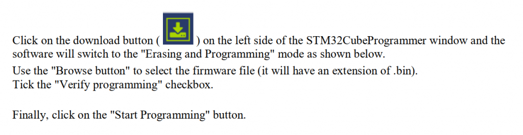

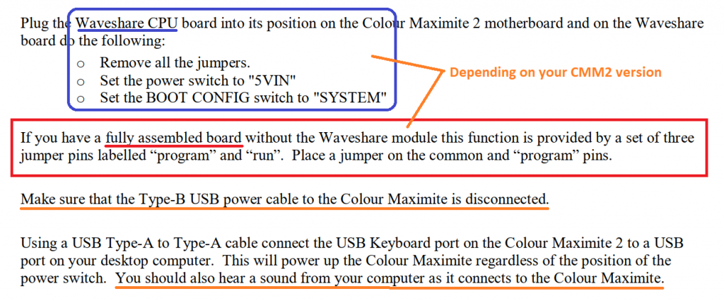

This is covered on page 118 "appendix G" of the manual, and also in the "Construction Guide" but I can tell you are still having difficulties.
  TweakerRay said  Hi ! I bought a usb a a cable so i can connect it to my pc and I tried to run this programmer... but it does not open. I am on Windows 10
Watch the first two minutes of this video only (The rest of it will confuse you).
That shows you (briefly) how to install the STM32CubeProgrammer under Windows10, and how to check which connection method you are using to talk to the CMM2 or Waveshare.

Ok, so now you have your CMM2 connected to the pc with a known good USB-A to A cable which is plugged into the keyboard socket of the CMM2.  That should be the only connection, no VGA cable, no audo cable, and the jumper and/or switch are set as shown above.
Windows should have made its "usb bing-bong" noise when you plugged in.  If it didn't I would suspect a duff cable, or you have not set the jumpers or switch right

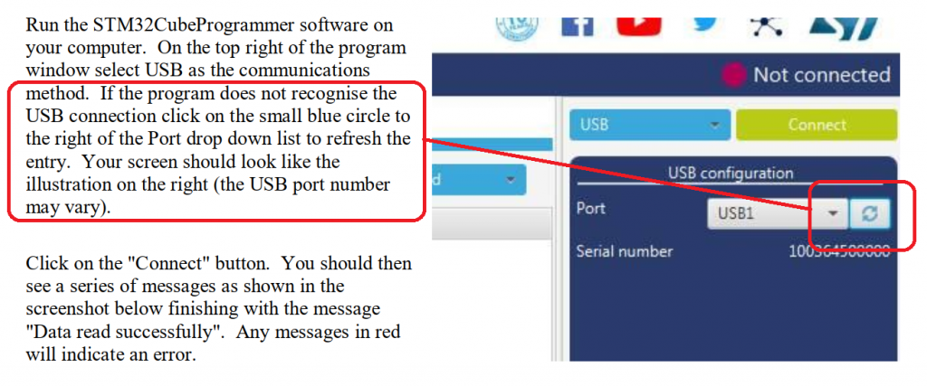

Now open the STM32CubeProgrammer software
We are now on page 119 of the "CMM2 User Guide" ...
IF the STM32CubeProgrammer does not open properly it is not installed correctly.  STOP, unplug the CMM2, reboot your pc, and go and install the software again.  It would be worth checking if you have any other usb devies (joysticks, streamdeck consoles, arduino, mobile phones or other devices) connected to your pc, if so unplug them for now, and try again.  They may contain a similar microcontroller and be confusing windows.
I assume that you have already downloaded a copy of the firmware zip file, and unzipped it to a folder on your pc hard drive.  If not do that NOW.
You will need to tell the STM32CubeProgrammer where to find the firmware .bin file.

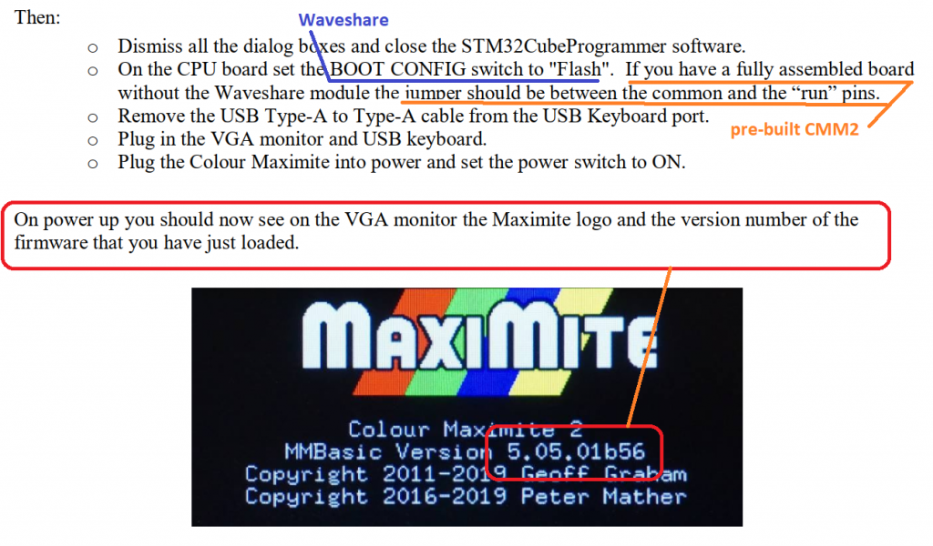

At this point you are pushing the firmware onto the CMM2, it takes short time, you should get two dialog boxes to say the "File download completed" and  "Download verified successfully".  The whole operation will take under a minute and any messages in red in the log area will indicate an error.  If you get an error message in red then check your cabling and try again.
We are now on page 120 of the "CMM2 User Guide" ...
Thats it, you have successfully updated your firmware

But it does not get the usb connection.
I don't get a beep when I connect the device and I can't get it connected to that programmer
I have connected the device now only with that usb a-a cable to my computer.

EDIT: I opened that machine up and found that jumper... I made that to Programm and now I got connected... Really this is not beginnerfriendly that I have to open stuff like that and use jumpers for a simple upgrade... it should be much easier...
but what should i complain... I got it working now...   - I try now to upgrade it without breaking it...
Edit 2: Thank you it seemed that now I have upgraded to the new firmware... I will try if it still works now... setting the jumper back where it was and hope now everything is still intact. BTW : The machine has not done any beep... not my pc and not the colormaximite when I have connected it with the usb a cable..
