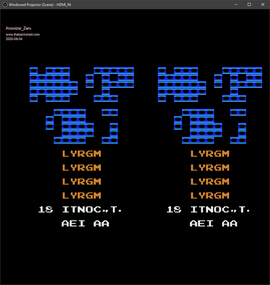

so... i rewrote the ppu logic...
Colours are working properly now but... well thats supposed to be the donkey kong title screen.
also, mode 6 works great. I need to figure out a way to offset the position of the rendering to the left by 16 pixels or so... any ideas?

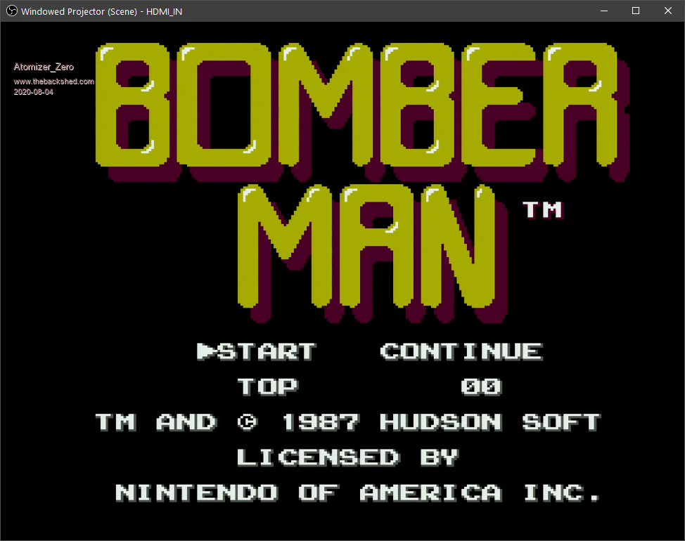

FINALLY!
But of course, still a problem. No Sprites are loading. The little Selection sprite icon isn't there.
But this is a win in my book. its running about 2 scanline a second, which is unplayable, but still a nice proof of concept.

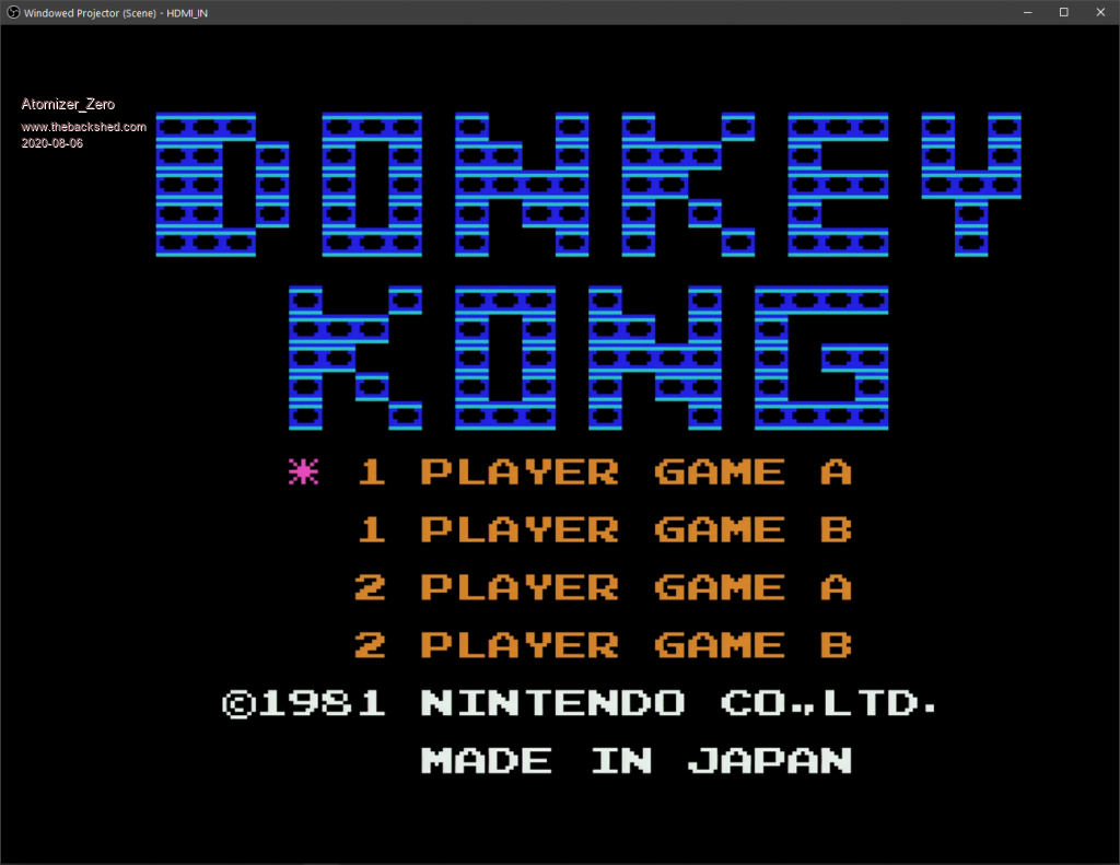

And just like that. I've fixed it
that little pink star is a SPRITE. :D
