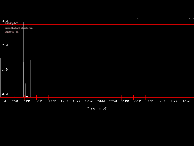

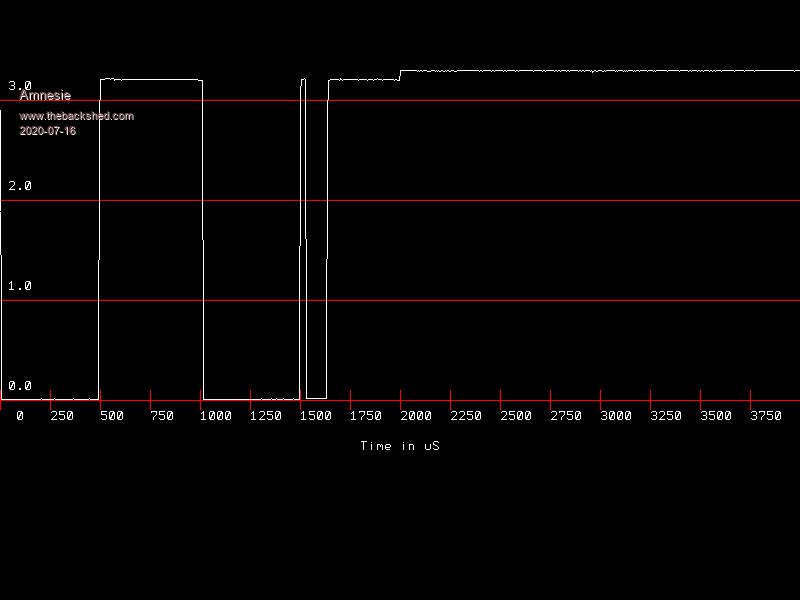

We are ready to chart the analogue values on the data line.
 ' DS18B20 connected to PIN 42 in external power mode and link from PIN 42 to PIN 7
 ' TassyJim July 2020
 DIM FLOAT presence(2048)
 ADC OPEN 200000, 7,12,13,allDone
 ADC TRIGGER 1, -2 ' start reading when level drops below 2
 ADC START presence()
 PIN(42) = 1
 SETPIN 42, DOUT, OC
 PULSE 42, 0.481 ' change this value for testing
 SETPIN 42, DIN
 DO
 LOOP UNTIL INKEY$<>""
END
SUB alldone
 LOCAL INTEGER n, y1,y2
 ADC CLOSE
 CLS
 FOR n = 0 TO 3
   LINE 0,400-n*100,799,400-n*100,1, RGB(RED)
   TEXT 0,380-n*100,STR$(n,2,1)
 NEXT n
 FOR n = 0 TO 750 STEP 50
   LINE n,390,n,410,1, RGB(RED)
   TEXT n,410,STR$(n*5,3,0)
   TEXT 400,440,"Time in uS",c
 NEXT n
 y1 = 400 - presence(0)*100
 FOR n = 1 TO 800
   y2 = 400 - presence(n)*100
   LINE n-1, y1, n, y2,1,RGB(WHITE)
   y1 = y2
 NEXT n
 SAVE IMAGE "capture_"+MID$(DATE$,4,2)+MID$(DATE$,1,2)+MID$(TIME$,1,2)+MID$(TIME$,4,2)+".bmp"
 TEXT 100,500,"Press any key to continue"
END SUB
This program samples every 5uS starting form the first negative going transition
Sample from a 'good' DS18B20
It is encased and with a 1M lead.

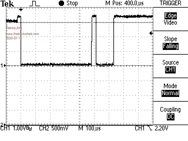

As a comparison, this is the same run captured on my CRO

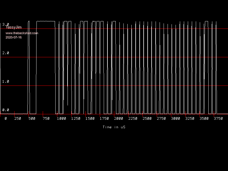

By changing the trigger to a normal TEMPR(42) read
'  PIN(42) = 1
'  SETPIN 42, DOUT, OC
'  PULSE 42, 0.481 ' change this value for testing
'  SETPIN 42, DIN
x = tempr(42)
 DO
We get
Not enough resolution to decode easily but enough to show that it works.

  Quote  The next thing I will try is to see if we can measure the level that your devices are bringing the data line down to.
I suspect that they have a high impedance and are not pulling the line low enough for the CMM2 to recognise a LOW
Jim may well be correct in which case there is nothing to be done except try a higher value pullup - say 6K8 as a start. The low threshold for a STM32H743 is 0.4 * VDD - 0.1 so in our case 1.22V
You could try the attached. I've set the timings to be exactly the same as the Arduino library
CMM2V1.5.zip
PS: Jim this is wonderful work you are doing and really shows off the CMM2 in new and interesting ways

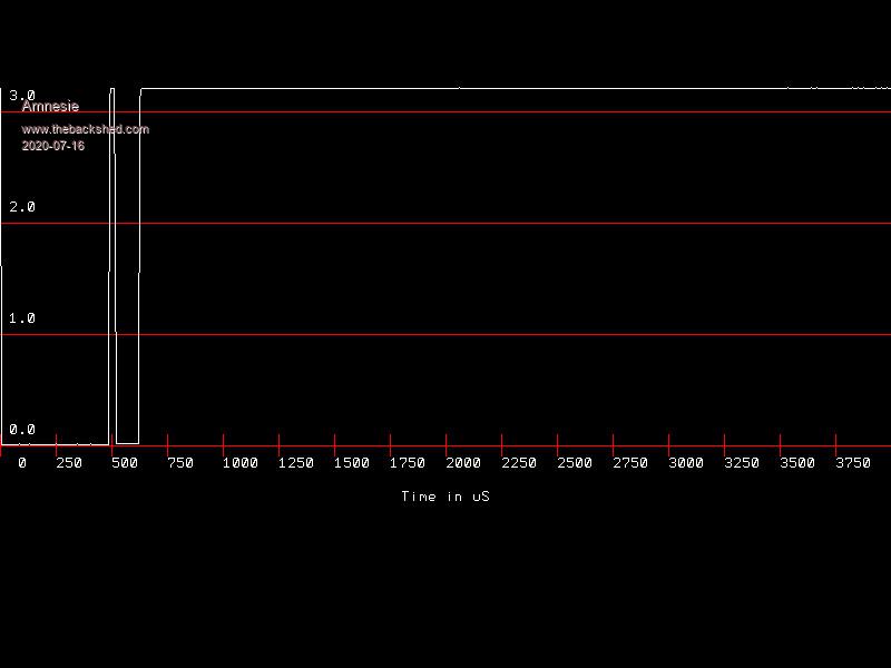

So I have done some testing:
first I ran Jims tests, here are my results:
Then "By changing the trigger to a normal TEMPR(42) read"
I've done all readings multiple times, the result is always stable and the same.
After this I tested all kinds of pullups and even without pullup. Things got worse here.
Without a pullup I only get error readings (1000) and with values up to 30k I get false readings like 16.120 (instead of 22°C) - so the pullup @ 4,7k seems to be right.
After this I tested matherp's new firmware. But nothing has changed. The missreadings / errors in relation to the correct readings seems to be the same as before. So there are
some correct readings, but a lot of errors, too.
Just a reminder: the above readings from Jims test are done BEFORE FLASHING the firmware!
