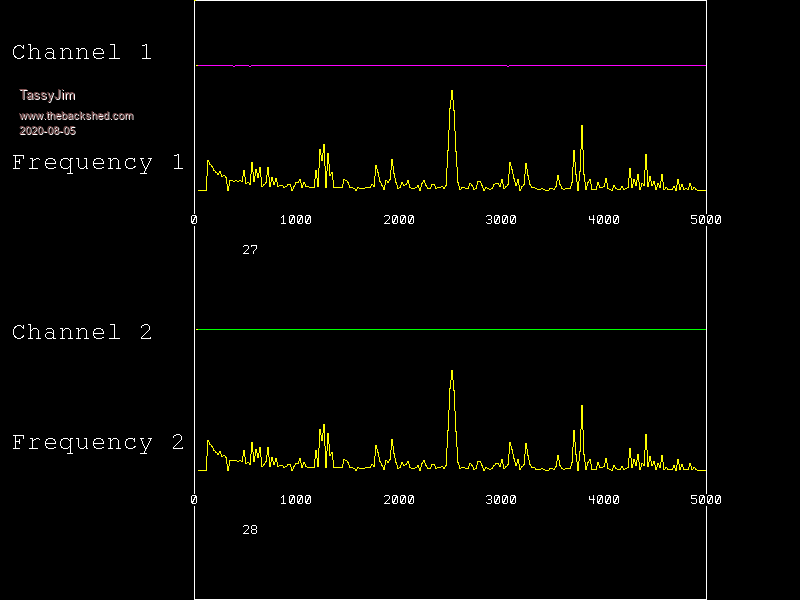

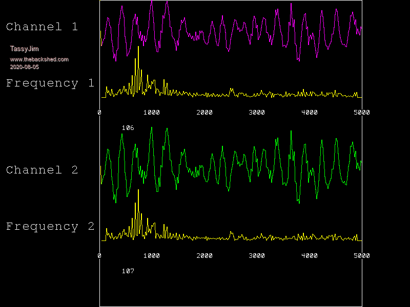

Next, using Peters FFT demo, slightly modified.
Run this program with the audio pins still connected to pin 7 and 8

Pressing 'P" will grab a copy of the screen and end the program.
Playing the audio from your MP4, gives this output:
Once the audio has stopped, this is what I get.
The FFT (yellow) is auto-scaling so any background noise is dramatically amplified when there is no audio playing.
The number below the frequency scale is the amplitude of the spectrum.
Some of the spectrum is due to artifacts, some will be actual noise, none of which I can hear.
Post a coy of your results.

  TassyJim said  One thing I can't determine from the recording.
Is the noise on one channel only or the same on both left and right?
Jim ... its the same on both channels.
