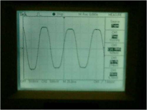

I should have more clearly described it in my previous post. There's a single-phase, single-turn wave-winding in there, the equivalent of 6 coils of 1 turn each. See image below:
Output was 1Vac at 125RPM (actually measured 0.5Vac handcranking at 63RPM, using a stopwatch and manual counting methods); I measured it using a non-RMS DMM and as the waveshape is not a perfect sine there'll be an error. The digital scope can measure RMS-AC and show waveshape so I may use that when making accurate measurements with the VFD test setup.
Here's a picture of the waveshape of the 10hp conversion (the variation in amplitude is caused by variations in RPM because of manual cranking):
It looks moderately sinusoid, better than I expected, even though there is some 3rd order distortion which is mostly manifest as clipping of the tops of the sine.

I will not speculate on harmonics, etc, or hijack this thread. The flat top of the sinisoid is caused by a period in the magnetic rotation where the coil arrangement sees a constant magnetic field. If you extrapolate what you have recorded further, you will end up with the waveform I have on my axial flux mill. One that approximates a square wave output, ie the constant voltage output approximates to 45% positive output time, and approx 45% negative output time. There is a total 10% transition period time where the output voltage reverses.

  Gordon said  The flat top of the sinisoid is caused by a period in the magnetic rotation where the coil arrangement sees a constant magnetic field.
Yep, that's the explanation I had in mind too, and it shows itself in the waveshape as 3rd order harmonic distortion :) I actually 'predicted' this from looking at the FEMM simulations, but in hindsight I had expected the problem to be worse than it is. 'Problem', I say, because it would be an issue when using transformers to transform output voltage. For battery charging it's not an issue of course, though I wonder if 3rd order distortion doesn't actually reduce power output, as compared to the situation where all electrical energy is present as a fundamental sinewave without distortion...
A square-wave can be synthesized from only a sine fundamental and its odd-order harmonics, so your axial flux has a lot of harmonic distortion too. 'Distortion' has a negative connotation to it, but it's probably not a problem in our applications (battery charging, or using resistive loads), as long as we stay away from transformers.

In the case of an alternator, the shape of the output waveform in relation to harmonics content is important only with transformation. This is similar with a mathematical representation as well [fourier transform analysis and the like]. I might suggest that in my alternator that the fundamental output is a square wave. Just because this can be represented as a combination of sine waves, does not detract that fundamentally this is the waveform produced. A transformer load is probably the only load where a single sinisoidal frequency is important, as you have mentioned as well. Power transmission companies may value this property, but if DC is the ultimate goal, then I would opt for the square wave. A conductor will have the lowest loss, only when the average current and the maximum current are equal. This does not occur with a sine wave. Power generation and transmission, with a sine wave property, occurs with an efficiency penalty. My F&P mill with series caps probably benefits from a sinisoidal output. I believe there is a tranformer action occuring in this arrangement that allows this combination to produce more current. The alternator efficiency is probably lower, but the wind energy extraction of the complete system is higher, so caps will probably stay.

I wouldn't lose any sleep about driving a transformer with a squarish waveform. I strive to get a square wave whenever I am building a PWM. Transformers seem to deal well with the square wave (forced on us by the switching characteristics of the fets.. full on or full off).
I haven't noticed any woeful efficiencies from that quarter.... (unless I drive them into saturation... and then it gets ugly very quickly
Is there something I am missing here?

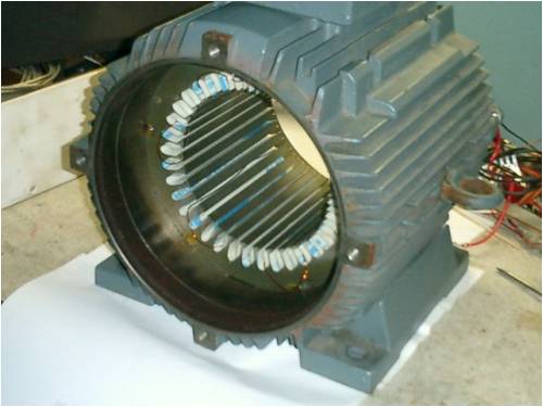

One question I must ask before I dive in: is that a picture of blue boy with all the wire taken out? Or is it the current 10 hp project? You haven't removed all the wire from this one yet, I hope?
My recent 7.5hp Toshi conversion is a PERFECT 48V wind turbine generator with its original wire. I'd hate for you to have to re-wire your motor just like it was before.

The power output would be derated by the voltage output factor. I would make this 5kW motor as suitable as a 500-700W generator by these calcs.
Maybe somehow these windings can pass more current as a generator?
I would hope a 50kg motor conversion PMalternator like dinges has could do better. My AXFX alternator only weighs 8kg for 500W @ 400rpm.
Have I missed something with these motor conversions re output power? They seem to be big and heavy for what power you get!
I would want to up the flux transition rate and rewire, but I think the iron losses would then be a problem.
Gordon.

  Steven said  One question I must ask before I dive in: is that a picture of blue boy with all the wire taken out? Or is it the current 10 hp project? You haven't removed all the wire from this one yet, I hope?
That is the 10hp conversion with all its wire taken out, yes. The idea was to turn it into as good a generator as possible, regardless of amount of effort it took. So it was turned from a 4pole into a 12pole and now needs a rewind. And one of the goals is reducing resistance as much as possible (though I knew very little about the importance of that issue when I started out on this project). In short, a suitable cut-in (which I think was what you were thinking of) is a necessary but not satisfactory condition for a suitable generator.
BTW, w.r.t. Oztules' remark about resistance (if zero, the generator won't be able to break stall), he's ignoring the fact that we can easily add and remove resistance in the line; where it is not generating heat inside the generator. Also, once the generator is wound, it's impossible to change (lower) its internal resistance; but we *can* vary line resistance. So it makes sense to have as little resistance inside the generator, and do any resistance matching (when needed) on the outside.
  Gordon said  The original windings would probably be rated for 415VAC star, or similar. There is an approximate 10fold reduced output voltage to run at 48V.
It's even worse than that... it was originally wired for 690V in star (400V in delta). See nameplate:
http://picasaweb.google.com/motorconversion/75KWMotorConvers ionBlueMonster#5207081974285014674
