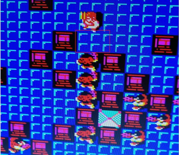

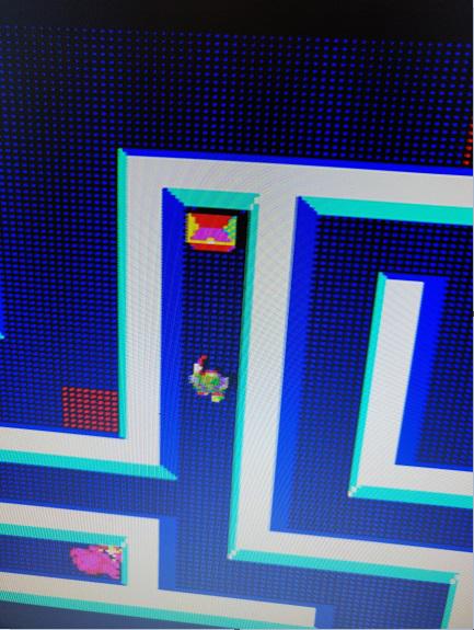

On level six there is a spot where there seems to be an invisible wall. It's between me and the monsters. Was that intentional?
And What's this box in the other pic?

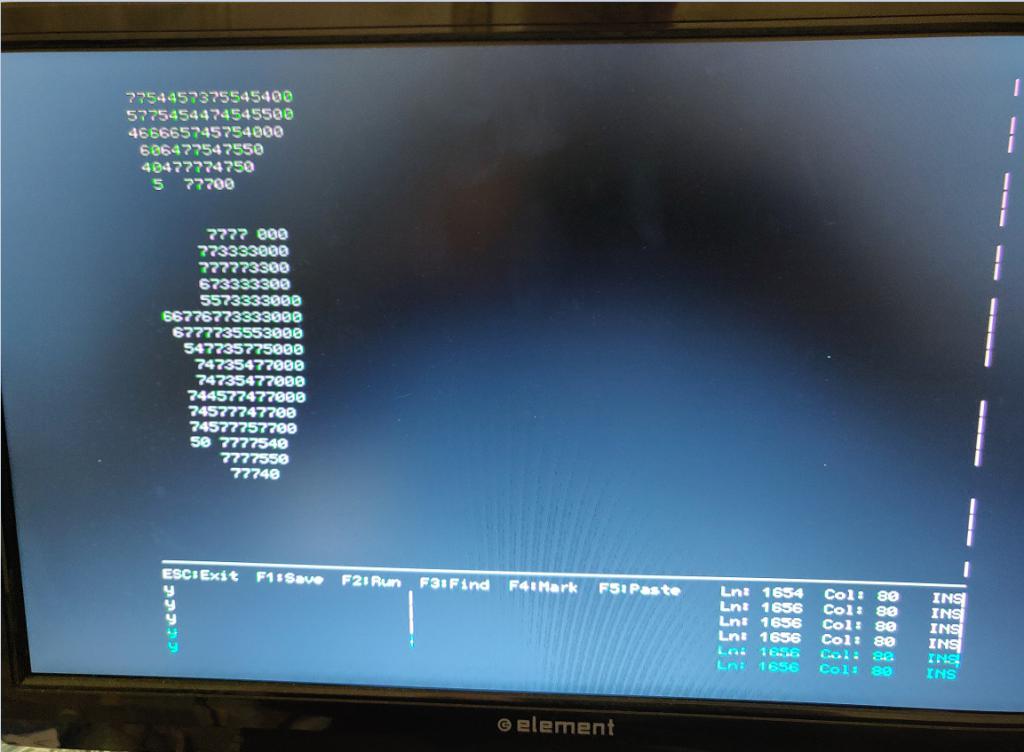

So the problem with "ingame1.spr" (and I imagine ingame2.spr) is that they don't contain 106 sprites. ingame1.spr will load once you change the line "16,106" to "16,102".
But that leaves most of one sprite left. According to Notepad++ there are 1652 lines in the file, which *should* load up 103 sprites.
But in MMBasic's Edit, it shows only 1649 lines. Where did the three lines go? Adding three lines and changing the sprite count allows Mstudio to load the file.
There are a bunch of blank lines at the beginning of the file, I used Notepad++ to remove these lines by using a "regular expression" search of "^ " and a blank replacement line.
This brought the sprite count down to 87, and cleaned the sprites up to where they displayed properly (while the file would load with the sprite count changed to 102 or 103, many of the first sprites had a blank line between each "real" line).
I'm going to reload ingame1.spr in edit and copy what it loads and paste it into another file and compare that to what I have in Notepad++. Should be interesting... :)
Other issues with edit is that it allows you to "scroll past" the end of the file. But that's a different kettle of fish.

On the level six the invisible wall will be a block that would turn in to a exit if you shoot in the wall.
The closed box in other pic it's a chest that will open with a key.

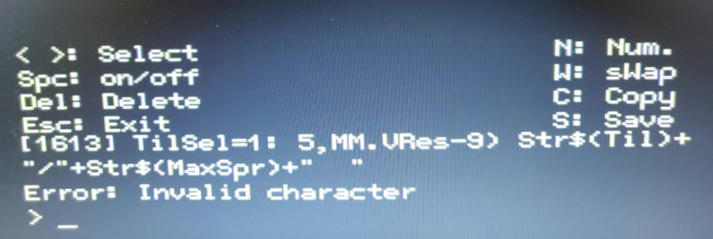

So that leads to the next problem (this is a MMBasic problem, not yours). I tried to load up ROOM07.MAP and it came back with this error:
You can see where it reports the problem being at line 1613 of Mstudio.bas. But look closer, it has merged the first part of line 1613 (TilSel=1: ) with part of line 1638 (5,MM.VRes-9) Str$(Til)+"/"+Str$(MaxSpr)+" ")
Here are the two lines as you wrote them:
(Line 1613) TilSel=1: Til=1: RefTil=1
...several lines deleted for clarity...
(Line 1638) Print@(145,MM.VRes-9) Str$(Til)+"/"+Str$(MaxSpr)+" "
You can see that the compiler is mixing these two lines together. Strange...

In the Mstudio I used many tricks to conserve memory because I had too many errors and lockups. I not doubt that you found one more bug.
In the case of the ingame2.spr that you said before, I tested and it have the same bug here and I believe that is a sprite merge bad routine in Gauntlet source. I will fix it soon.
