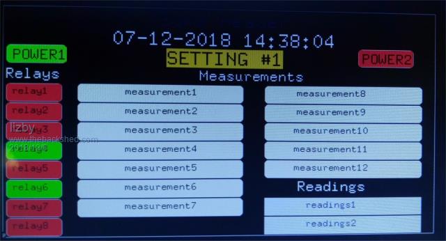

  lizby said  Is there an example program available for testing graphics on HDMI on the pi-cromite?
After R-ing TFM, I realized how straightforward it was. Some fiddling later, my first mmbasic graphic screen (not GUI).
Here's the code.
[code]
const indigo=&H4b0082
const lavender=&He6e6fa
const lemonchiffon=&Hfffacd
const gold=&HFFD700
dim as integer i,j
j=mm.vres/12 ' row height for 12 rows
cls
box 0,0,mm.hres,mm.vres,,,rgb(black) ' box around circumference
text mm.hres/2,4,"Some Header",c,,4,indigo ' header
text mm.hres/2, j+4, date$+" "+time$, c,,4
text mm.hres/2, j*2+4, "SETTING #1", c,,4,rgb(black),gold
rbox 10,2*j,mm.hres/8+10,j-3,,,rgb(green)
text 25,2*j+6,"POWER1",,,3,rgb(black),rgb(green)
rbox mm.hres/8*6.5,2*j,mm.hres/8+10,j-3,,,rgb(red)
text mm.hres/8*6.5+10,2*j+6,"POWER2",,,3,rgb(black),rgb(red)
text mm.hres/8/2+5, 3*j+5, "Relays", c,,3
text mm.hres/8*4.5, 3*j+5, "Measurements", c,,3
for i=1 to 8 : rbox 10,(i+3)*(j),mm.hres/8-1,j-3,,,rgb(red) : next i
for i=1 to 7 : rbox mm.hres/8+50,(i+3)*j,mm.hres/8*3,j-3,,,lemonchiffon : next i
for i=1 to 5 : rbox mm.hres/8*4+110,(i+3)*j,mm.hres/8*3,j-3,,,lemonchiffon : next i
for i=1 to 2 : box mm.hres/8*4+110,(i+9)*j,mm.hres/8*3,j-3,,,lavender : next i
text mm.hres/8*6, 9*j, "Readings", c,,3
for i=1 to 8 : text 25,(i+3)*j+6,"relay"+str$(i),,,2,rgb(black),rgb(red) : next i
for i=1 to 7 : text mm.hres/8*3/2+mm.hres/8+50,(i+3)*j+6,"measurement"+str$(i),c,,2,rgb(black),lemonchiffon : next i
for i=1 to 5 : text mm.hres/8*6,(i+3)*j+6,"measurement"+str$(i+7),c,,2,rgb(black),lemonchiffon : next i
for i=1 to 2 : text mm.hres/8*6,(i+9)*j+6,"readings"+str$(i),c,,2,rgb(black),lavender : next i
rbox 10,(7)*(j),mm.hres/8-1,j-3,,,rgb(green)
text 25,(7)*j+6,"relay4",,,2,rgb(black),rgb(green)
rbox 10,(9)*(j),mm.hres/8-1,j-3,,,rgb(green)
text 25,(9)*j+6,"relay6",,,2,rgb(black),rgb(green)
[/code]
Color rendition of the screen shot is not very good. It's actually much brighter.

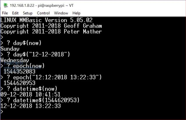

Can we get the DAY$ function on the pi-cromite?
Posts: 12085
Posted: 10:32am 09 Dec 2018
  Quote  Can we get the DAY$ function on the pi-cromite?
Why not - I've also included EPOCH and DATETIME$. NB I've changed DAY$ so that you can use it to find the day of the week of any date. EPOCH and DATETIME$ work back to 1902 with epoch going negative before 1970.

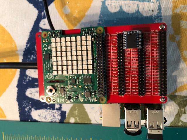

I recently added a DS3231 real time clock (RTC) to one of my Raspberry Pi computers.
Here are the two commands that I use for communicating with the RTC;
sudo hwclock -r reads the RTC
sudo hwclock -s writes the RTC info to the system time
The DS3231 I'm using is an I2C device and required the following statements to configure;
dtparam=i2c_arm=on
dtoverlay=i2c-rtc,ds3231
Here's a pic of the RTC mounted on a GPIO expansion card along with a SenseHat.
