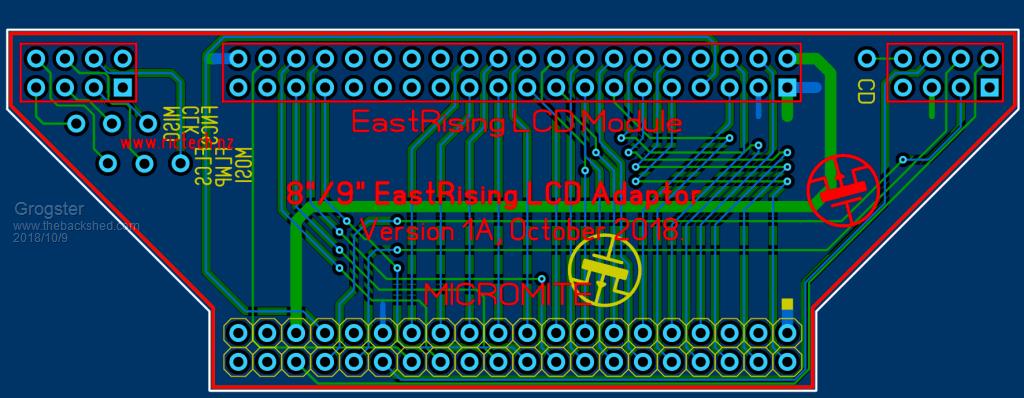

OK, chums, here we are:
This has both the SD card and touch SPI buses on their own pins as per the standard pinout for the 5" and 7" LCD's This is still E100 compatible, as the E100 joins those two SPI devices together into one bus, but for other applications where you need them separate - as mentioned by Jim, this has now been done.
16-bit data bus for the LCD data. I have yet to triple-check that everything is correct.
@ Geoff - OK, thanks for that info on the font chip, and so therefore, this connector is probably only good for the general purpose flash chip(if fitted). By default, the font chip and the memory chip are NOT fitted, unless you ask for them. As this is not catered for on the standard 40-pin connector from the MM, I have broken it out to some pads so you could solder your own wires on if you needed to talk to the memory chip....if you elected to have it installed.

  Azure said   Just thought it might be worth putting the MM+ Exp100 pin numbers and mapped function on the silkscreen somewhere (I know you mentioned you were still working on the silkscreen).
That would make it easy to know what display pin/function goes to what MM+ Exp100 pin down the track.
I'm just trying to work out what you mean here. Could you please elaborate a little?

I've just had a wee look around on the ER website, and this adaptor PCB will actually work with their 7", 8" and 9" displays - they use a standard(for them!) pinout on all their larger displays.
It will not fit the 5" LCD, but I am thinking of making one for it(which can probably cater to the 4" ones too), as the ER displays are on average six or seven bucks cheaper then the eBay or AliExpress ones, and ER guarantee supply of their LCD's for at least ten years(which means we can design with confidence).

My input would be to simply keep the 40-pin header as is current (and as documented in the MM User Manuals), and to optionally use the adaptor board whenever you use a 7",8", or 9" ER SSD TFT.
My only concern is the 'off-set' mounting holes!
